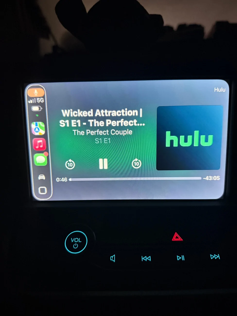

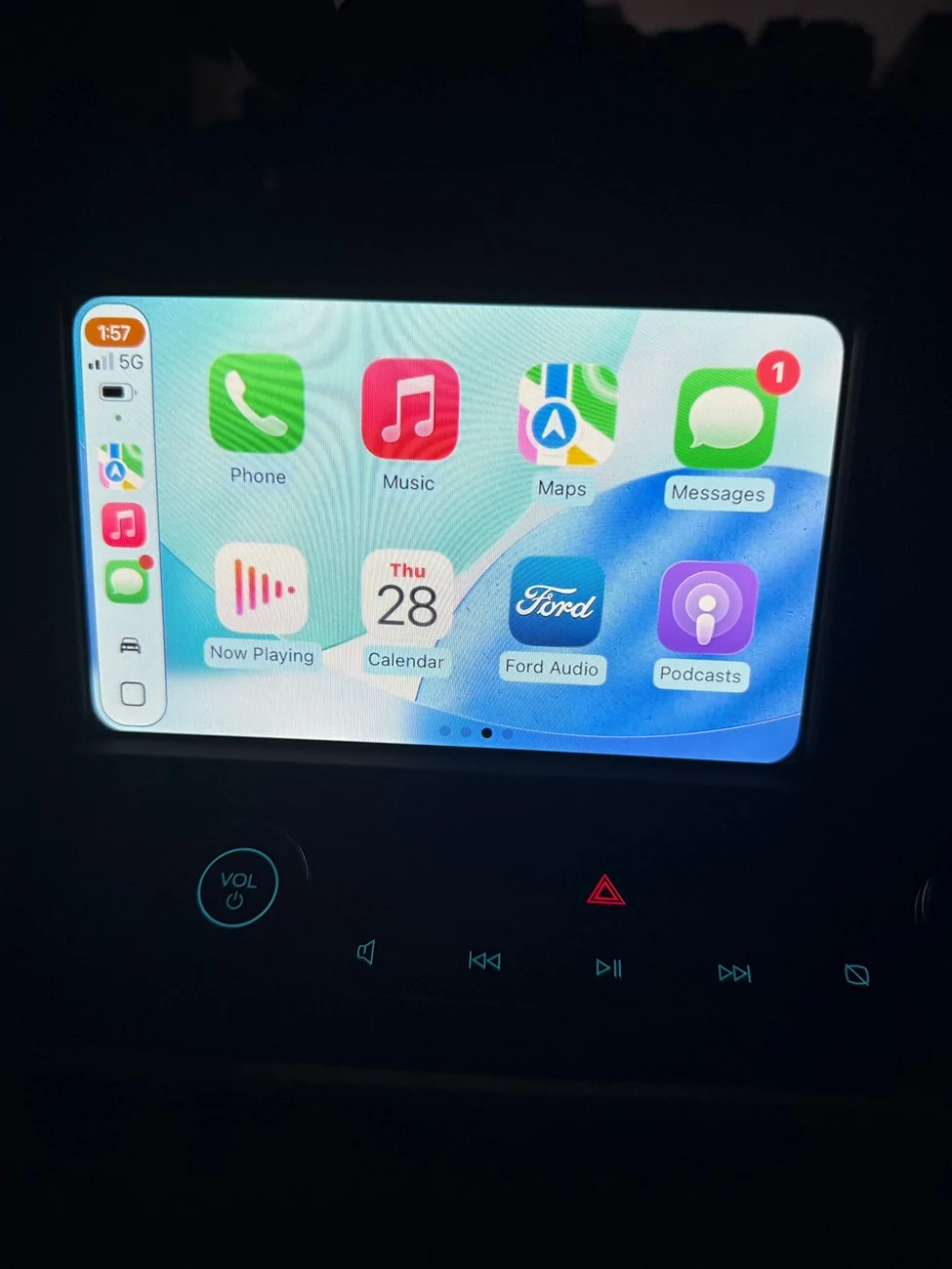

I bit the bullet and am on the iOS 26 beta. It’s pretty awesome but not all functionality is there yet.
Ford Maverick IOS 18.6 carplay IMG_5982
Ford Maverick IOS 18.6 carplay IMG_5981
