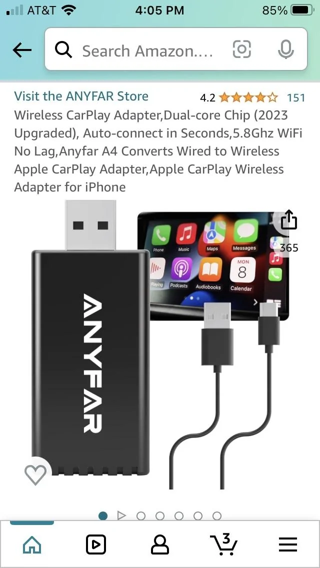

This solved my issue 95 % it’s now wireless but has a hiccup every now and then I’ll live with that
Ford Maverick CarPlay A1F56719-E15B-4EBB-A639-224C15FC1811
