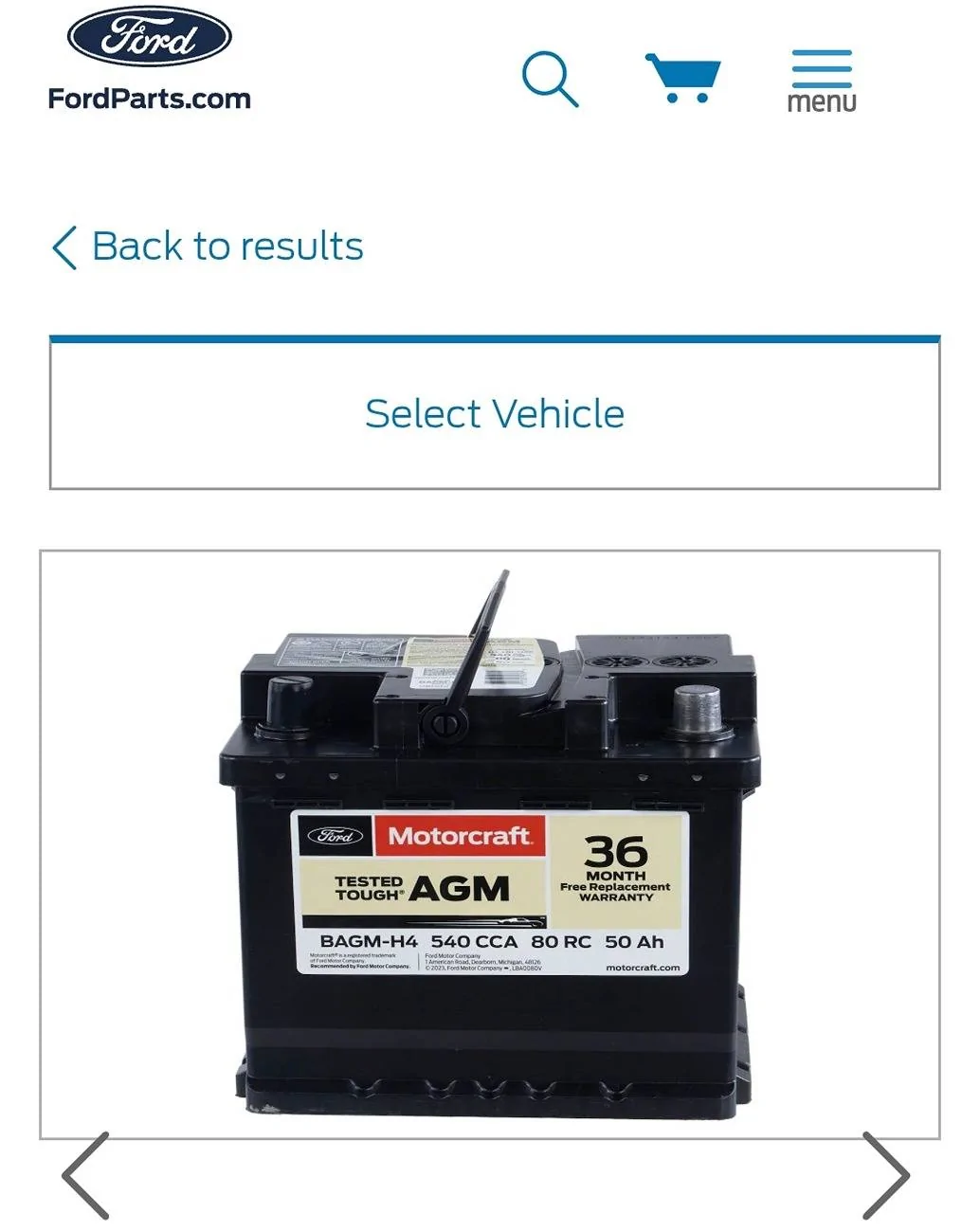

I just bought another battery but this time an AGM battery from Amazon. Thankfully Advance Auto gave me a refund on my year old Gold battery which had a 3 year warranty. It lasted about 9 to 10 months and the had the same issue as the original Ford battery which lasted almost one year before exhibiting the same "no interior light" syndrome. We ordered the one on Amazon which others here mention. A friend had the same issue and replaced his battery the same time as mine but his brand new battery after several days went completely dead so went to a local Ford dealer who only had the OEM flooded battery because he had to get his vehicle running. He contacted the 3rd party company who advertises and sells on Amazon but no contact. Won't be buying any more batteries through Amazon. .
For those who don't want to buy their batteries over the internet and I don't blame them.
And for those who prefer to stay with original motorcraft parts.
Good news is Ford does actually have an AGM H4 Battery that fits our Mavericks.
Bad news they are showing out of stock.
Ford Maverick Interior lights not coming on! IMG_20241223_185401
Myself, I am waiting for Walmart to sell in the store. EverStart Platinum AGM H4 battery with a four-year warranty.
Myself, I am hoping Walmart EverStart batteries come out with a Platinum AGM H4 battery with a four-year warranty.
Of course they are out of stock :sadface::crackup:
