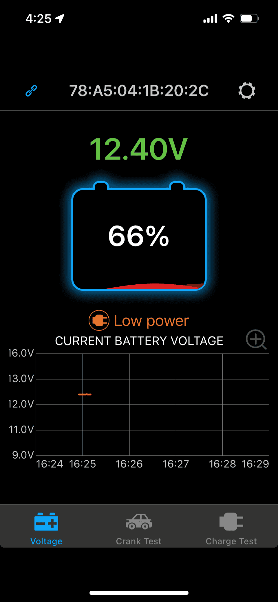

I feel your pain. Thinking about mounting a dc outlet in the side fender badge. I guess a charge session once a week is the only solution I have found. I go have not had a deep sleep episode since replacing the battery even though the battery monitor I installed says the voltage is low. I drove 600 miles last week.
