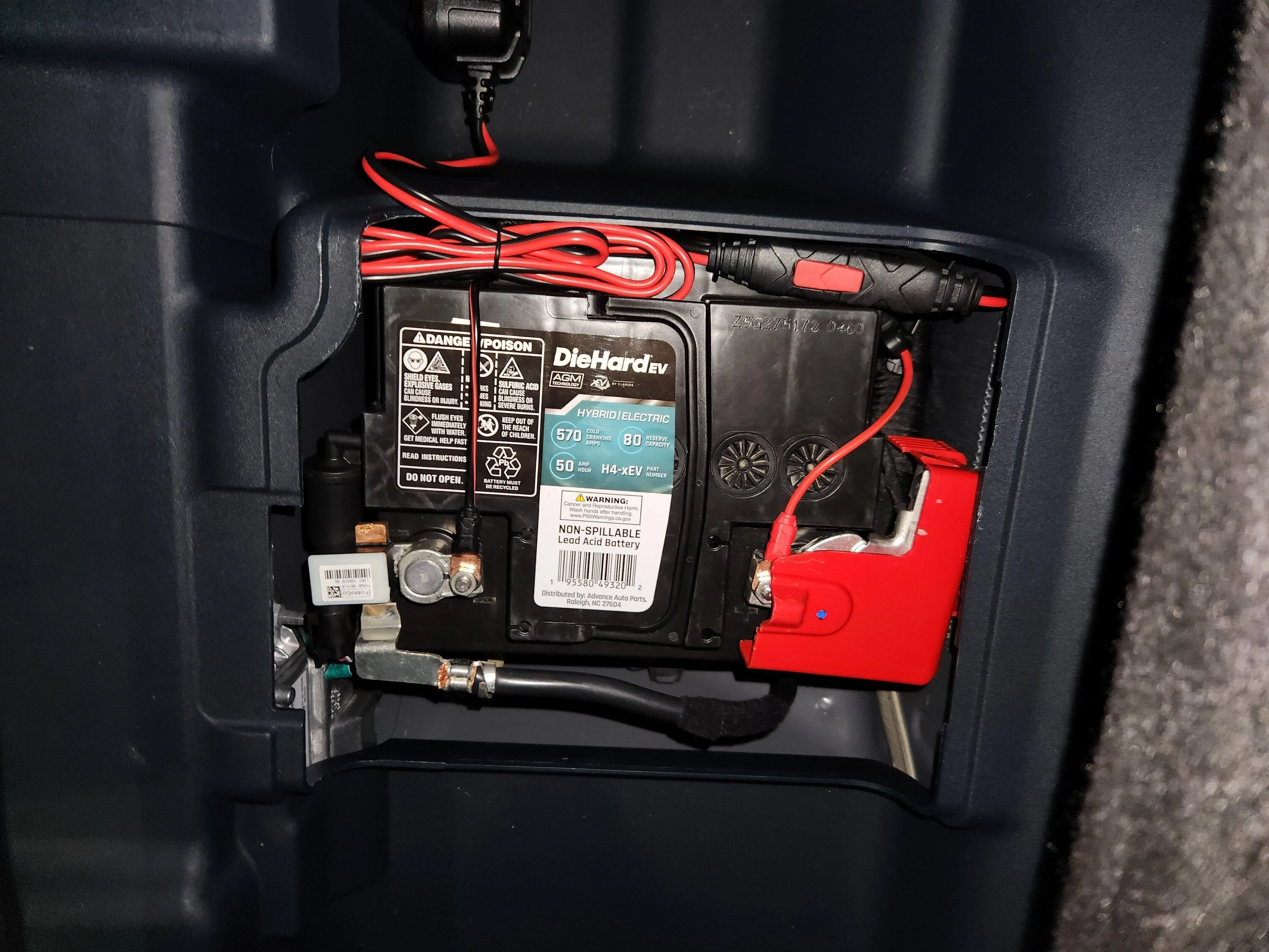

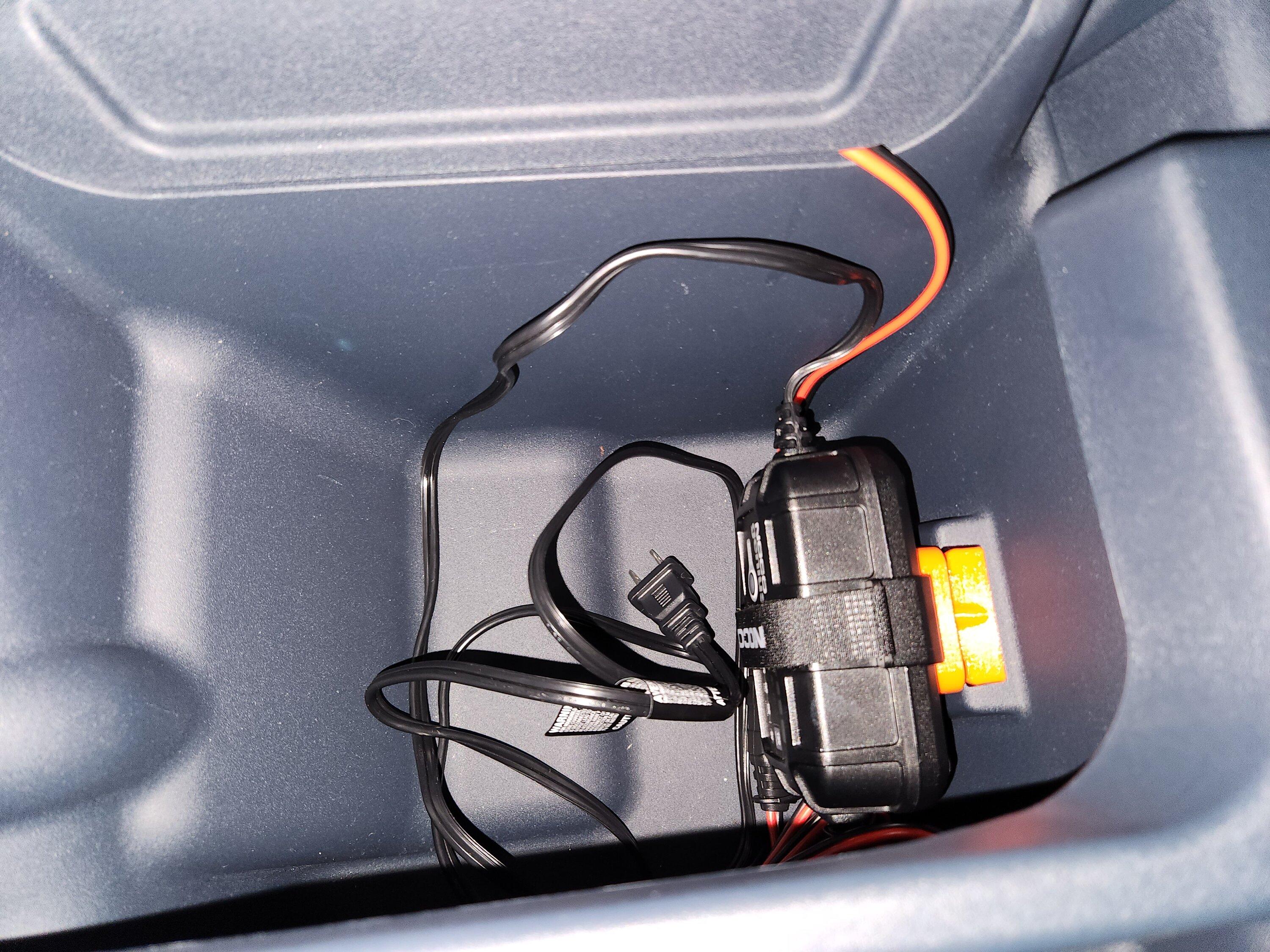

I may end up trying a better battery too if my trickle charger only gives me an extra day or two before sleep mode. Will going AGM for battery have any negative effects on the system at all?
I'll chime in and say I went for it and installed an AGM battery in mine. My initial findings are not all that promising. It's still early on, but I'm regretting this decision.
Ford Maverick I 20231216_112445
While monitoring live data via FORScan, my SOC continues to drop every day. I'm only losing maybe 3-4% charge while parked, but I only get 0-1% back driving to and from work. I'm only putting 0-2A into the battery while the truck is running. Started the week fully charged, down in the high 60's now. Just doesn't want to charge it, it or the dealer-supplied Motorcraft that came before it.
(Quick edit, 1 week in. Bumped target charge level in FORScan up to 92%, doing much better now. Truck now responds to battery level dropping by raising charge amps. What I've been chasing for months now. Might have an actual solution here.)
Take it all with a grain of salt, whatever the source of my issue is may not be the same as yours.
Regardless, my own PHEV system is still keeping me alive. Putting my FITS slots and 3D printer to good use!
