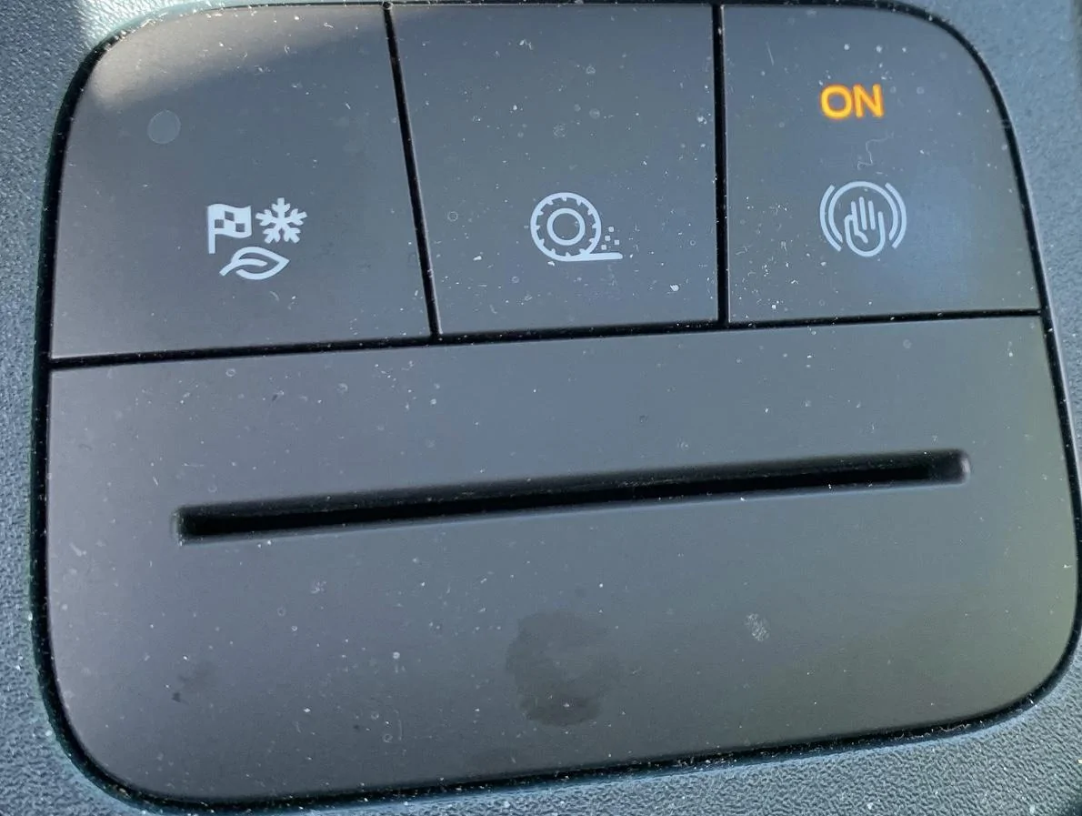

In hindsight, pretty sure I pressed the brake hard enough to activate the brake hold while backing up the incline-
Then when I gently gave it some throttle, it hesitated and kinda "sprung"
Backwards when the brake hold let go...
I've backed up that incline over and over with the brake hold on, but usually don't press the brake hard enough to engage the brake hold function.
Ok yea seems like it has been the brake hold. very interesting the brake hold thing, I’ve never used this feature and never owned a automatic and nevertheless used brake hold before. My Maverick will be a few firsts for me. Lol Interesting the things on new cars and trucks.
