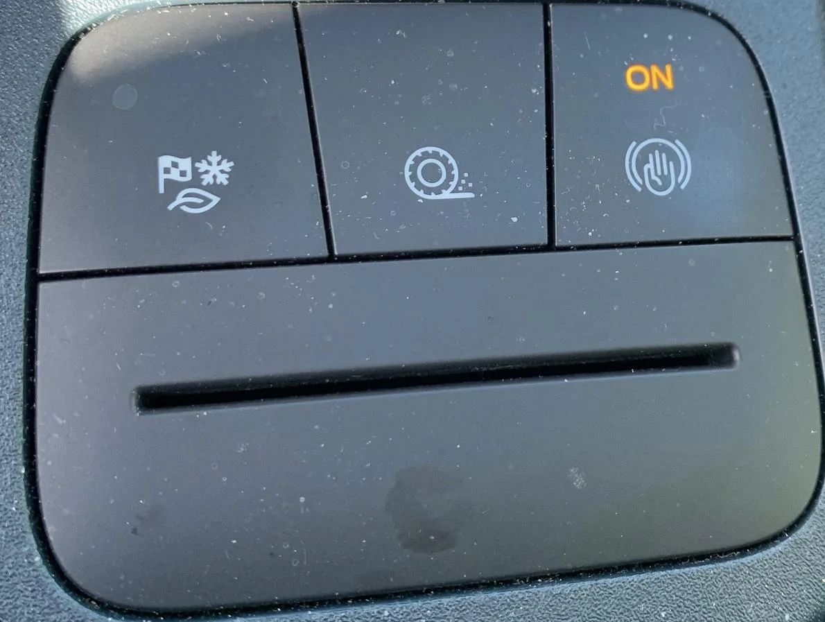

The setting is rightmost of the three in the back of the lower console...on my hybrid it "holds" and pops when accelerator is applied. Keeps me sitting still and not creeping at a stop. You can switch it off.

Do you use your E Brake? Or auto hold?
I normally have the brake hold on, then also use the parking brake-
Gonna try to remember to turn off the brake hold before I back uphill, drive on ramps, or enter a carwash...
