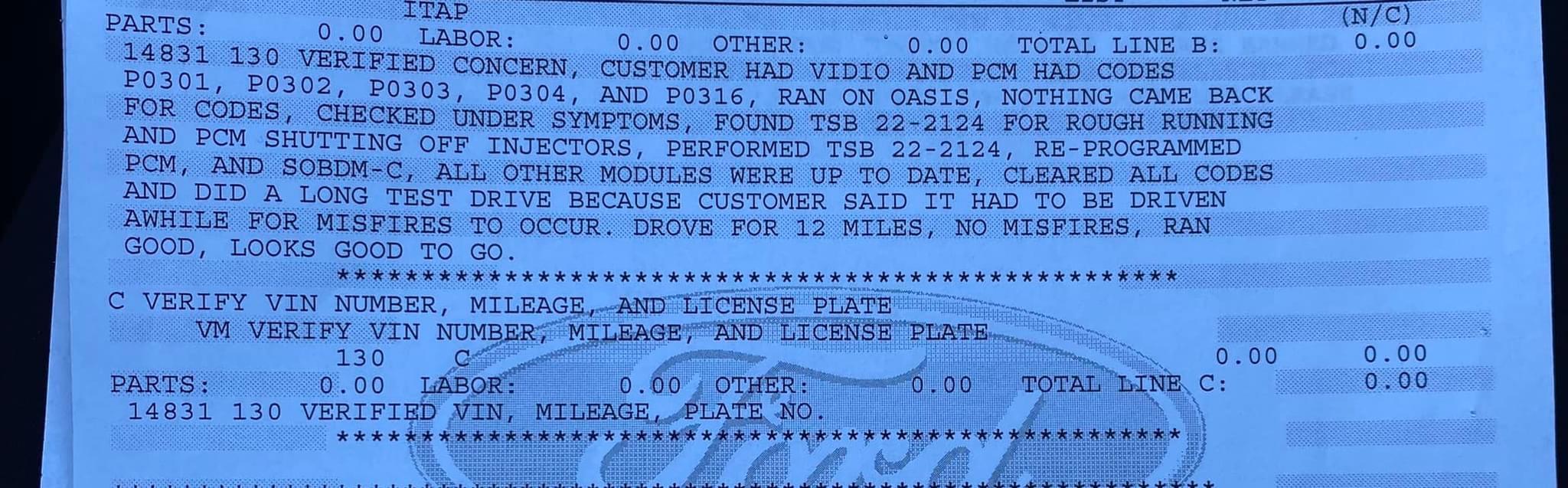

I’ve been following them… while they have SAID it’s a much more detailed “fix”…. I haven’t seen anyone say that they have gotten that “fix” and reported back on it. But maybe someone did, and I just haven’t seen it… which is entirely possible.
In my own testing of warming up the vehicle before driving it hasn’t shuttered, I think the PCM Update ford has released is a band aide to prevent the larger scale issue which is the flywheel clutch mechanism thing being replaced. Of course nothing is rock solid until ford admits to the issue themselves and releases a TSB of some sort.
I think we can all agree, with this issue there’s one commonly observed thing when it happens which is the ICE Temp is cold.

Mine too. Also rattles like crazy while at idle in park. I also got a check engine light for a misfire. My dealership is pulling the engine and transmission to replace the clutch assembly, absolute nightmare.
