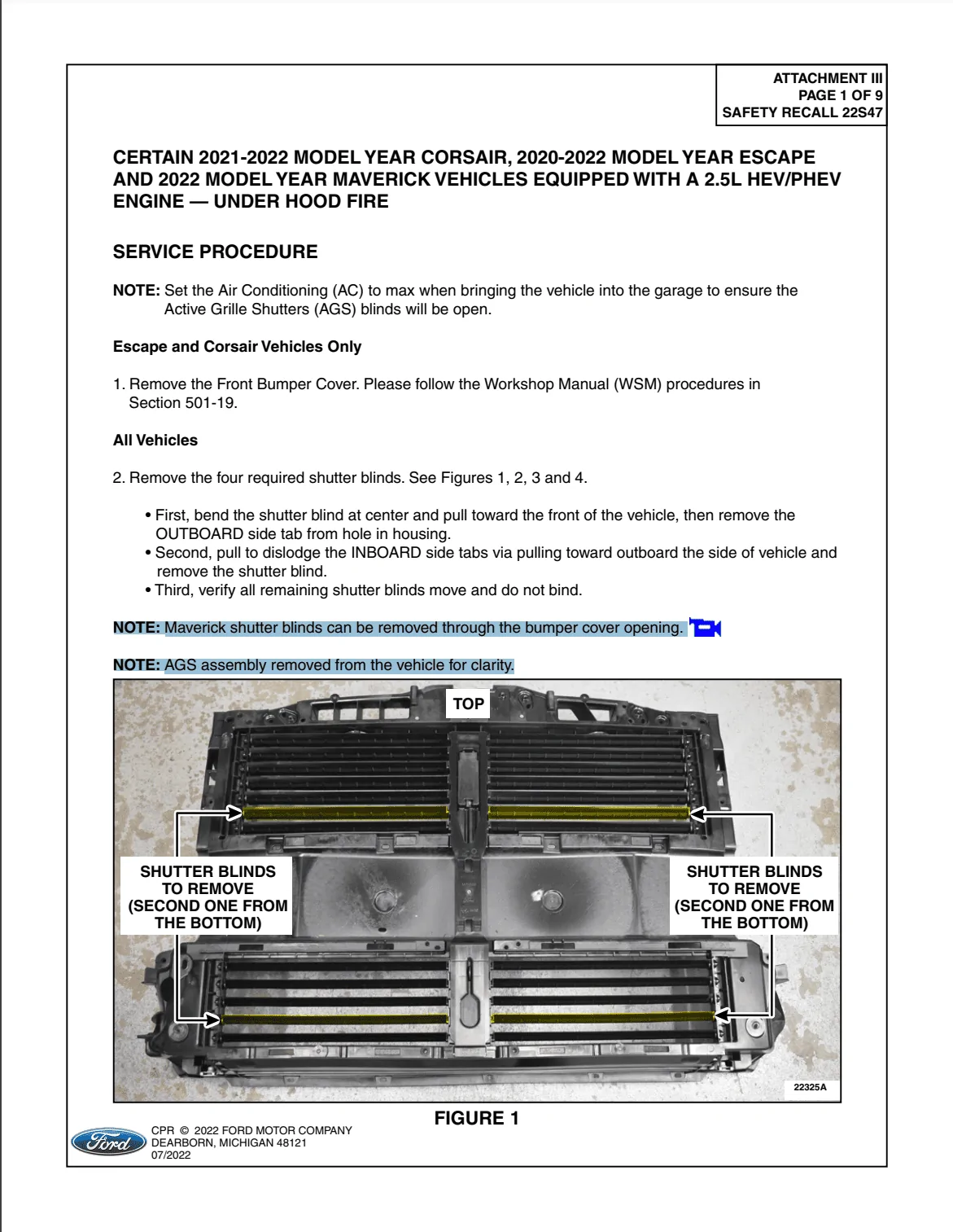

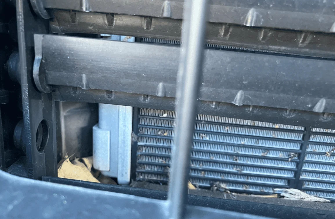

Is anyone else missing an Active Grille Shutter from the lower radiator? I noticed it last night when installing something. It doesn't even look like one was installed, and there is no way it fell out. Can anyone else check? I have a 2023 XLT Hybrid/Lux for reference. TIA

part of the fire risk abatement engineering change
Appreciate the clarification. I was examining it, and it didn't seem quite right. An interesting fix indeed.

next you might notice some random holes in your under engine felt ;)

jerrisn , As we say around here, fossil is funnin' you. Your hybrid shutters look like my hybrid and I didn't participate in the fire risk abatement engineering change . Nothing wrong there.

you were saying?
