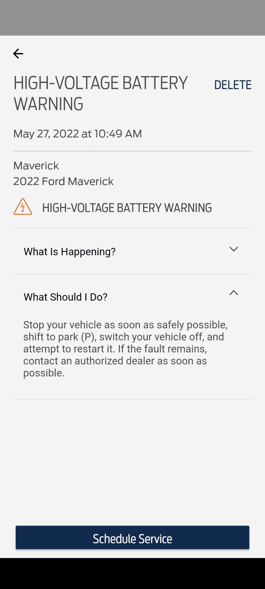

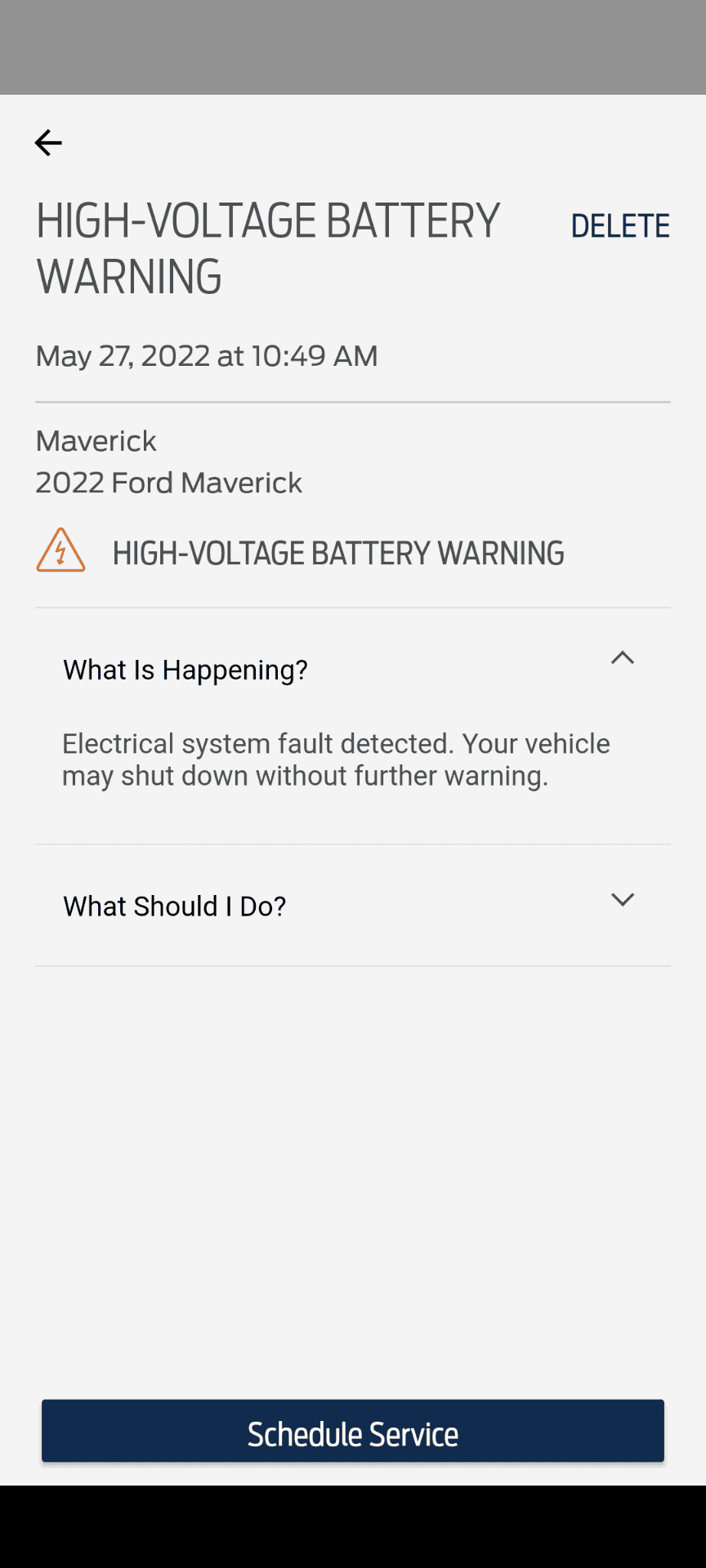

as posted in separate threads, I have experienced a complete shut down of my Lariat on 3 separate occasions with a "high voltage battery" warning on my ford pass app. After the warning the truck is virtually useless, limping to a stop, All 3 times I have been on the highway. Scary as hell, but thankfully nothing bad has happened. After about 5 minutes of waiting, the truck starts up again and I'm on my way My dealer had it for 2 weeks and read some sort of transmission codes, but neither they nor Ford knows what to do to correct this. I've seen a couple of similar posts on this site, but I'm wondering just how widespread this is. Doesn't give me a whole lot of confidence with taking it out on a long trip. Ford disappoints me too with their lack of a sense of urgency to get this fixed. Sorry to post about this again, just trying to get someone's attention!
With this being a genuine safety concern, please file a report with NHTSA.
