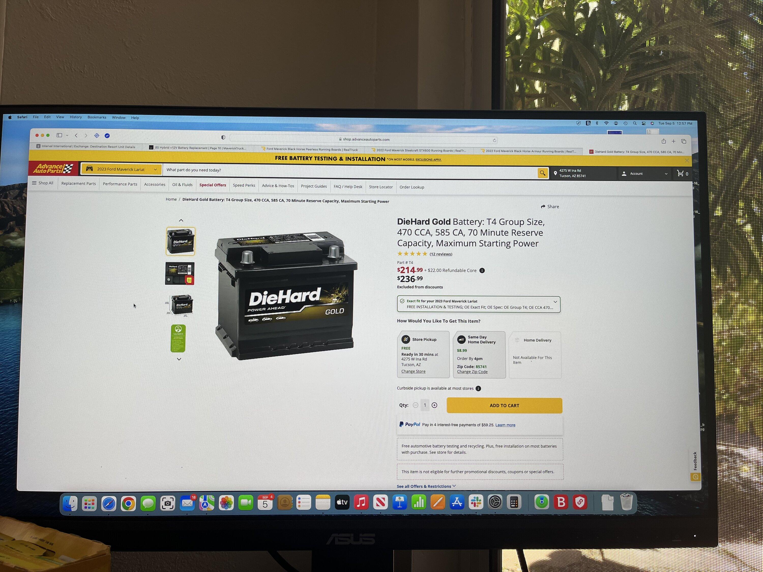

My OEM battery was replaced with another motorcraft battery under warranty, but that did nothing to fix my deep sleep. It went through months of additional diagnostics with no solution. I replaced my battery with an aftermarket AGM battery 2 years ago and haven’t had a single issue since.
