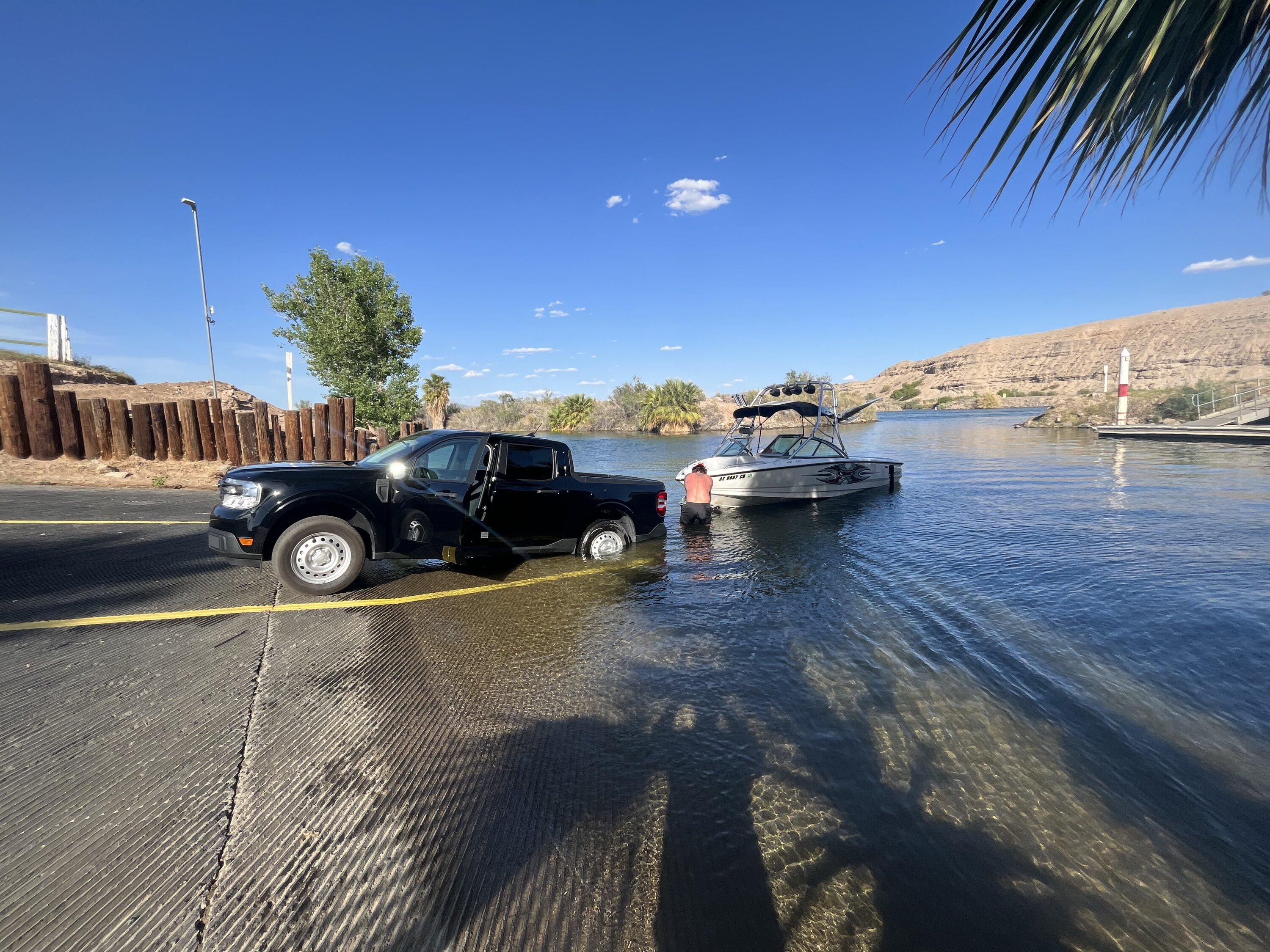

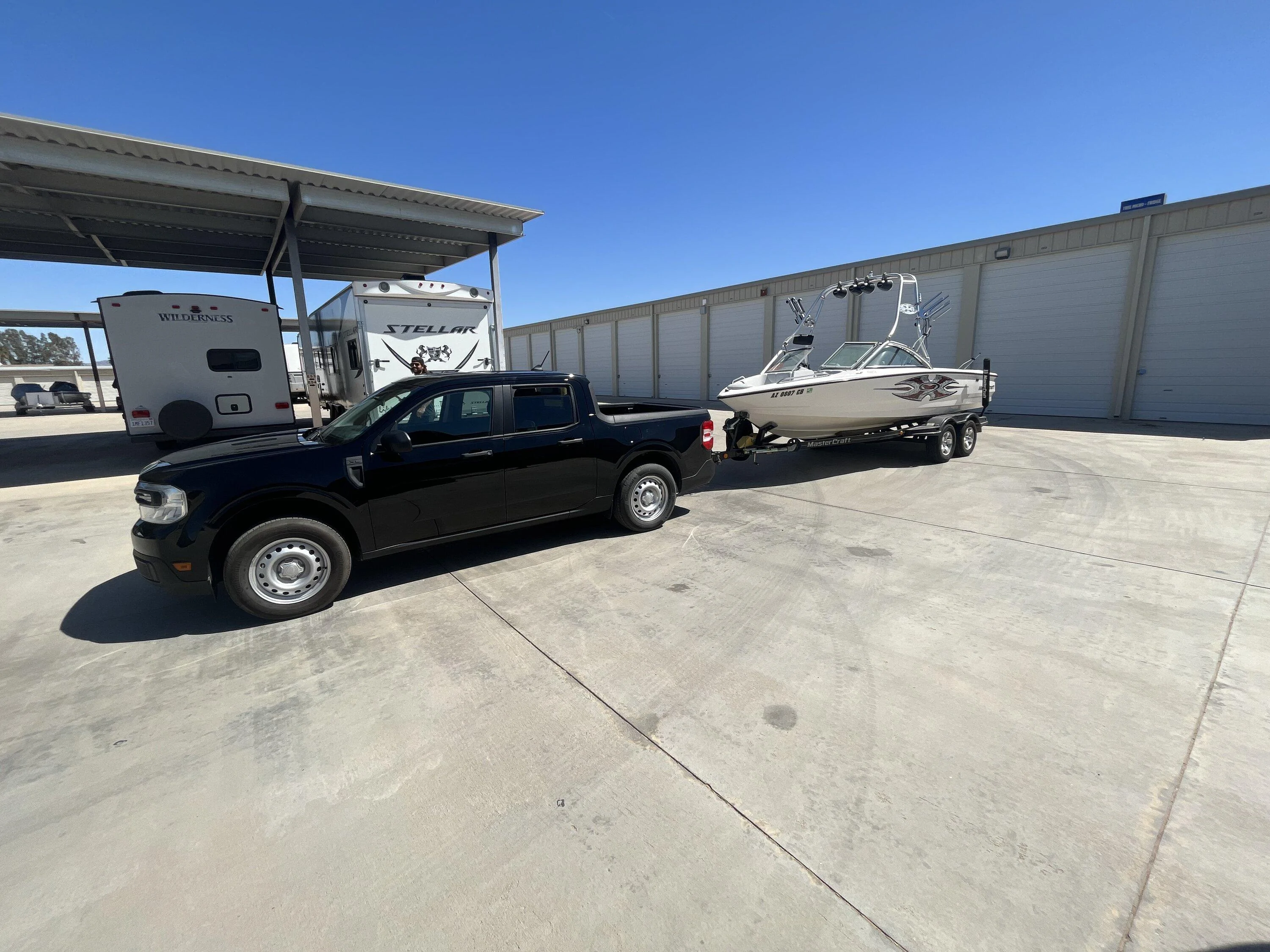

Towed the mastercraft x9 with our hybrid. Had concerns with the front wheel drive and traction pulling boat out but it’s was a non issue even with the crappy stock continentals!!!
Nice, a 4 cylinder hybrid pulling a V8!
