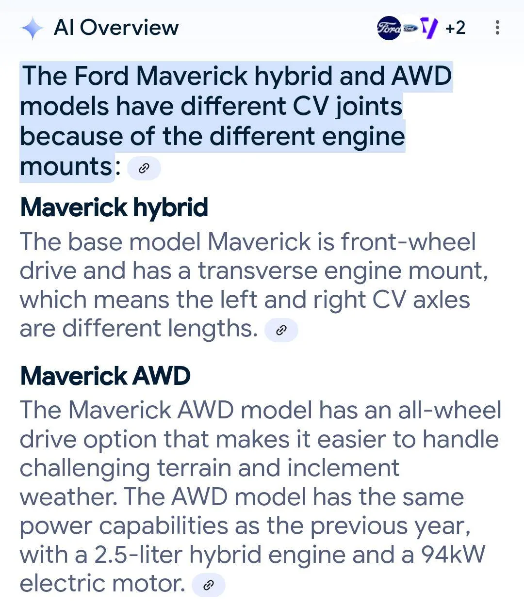

Not sure but cv joints could also be different from FWD to AWD. Saw an article showing the difference between FWD hybrid vs AWD in the 2024. Again not sure but on the www it appears so.
Ford Maverick Towing 2700 pounds with 2024 Hybrid? Screenshot_20241021-181605~2
