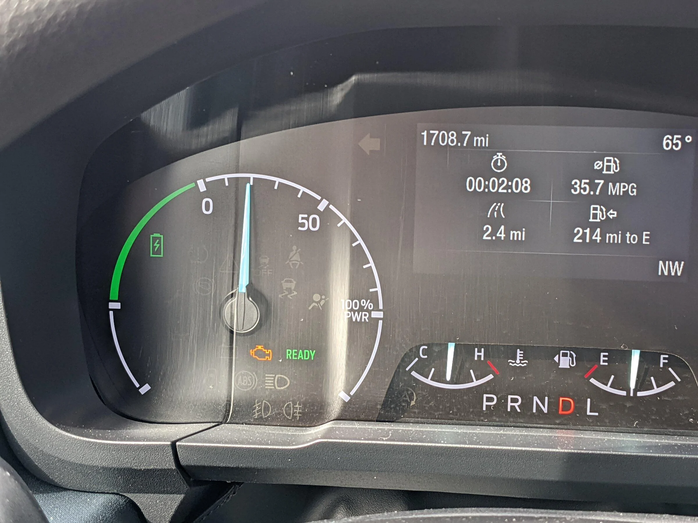

1708 miles check engine light comes on after a full throttle freeway entry...I knew all was fine had driven 250 to Pismo and Cambria. Boom after 1 hour light is off,Yeah good car did it's cycles and it went off!!! I knew nothing was wrong checked everything !!! All good light went off!!

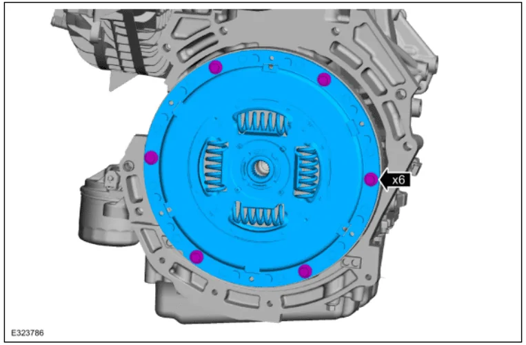

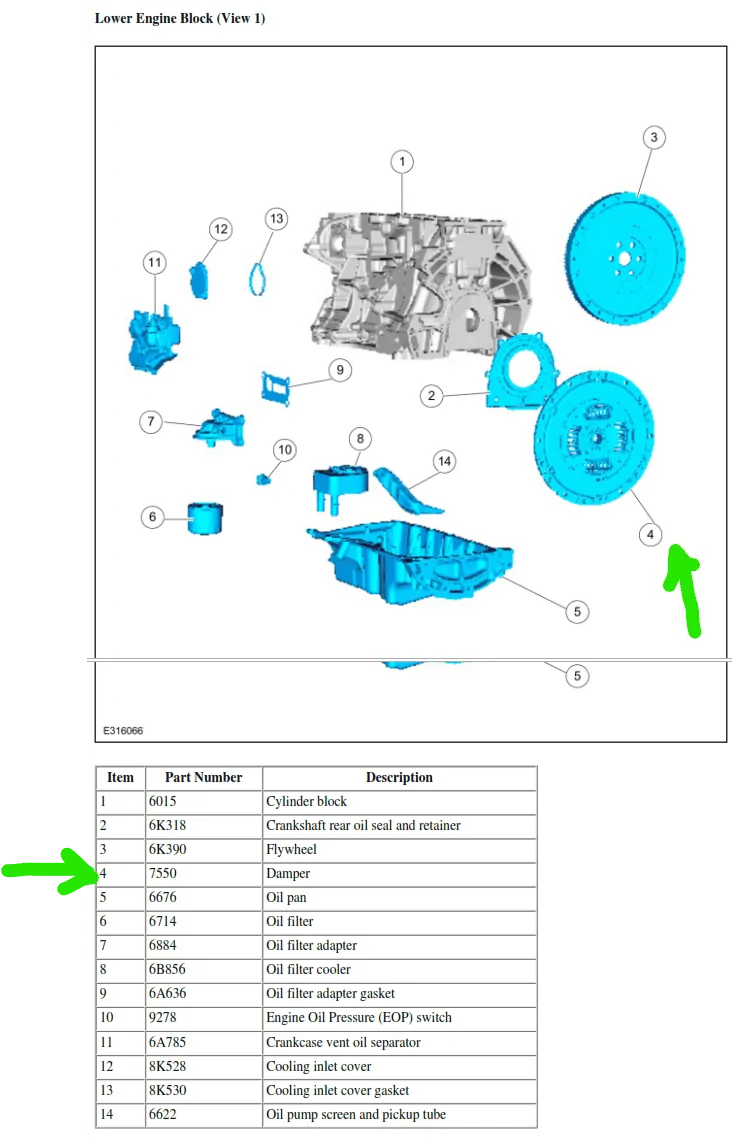

echnically there is a fixed clutch pack between the engine flywheel and input of the transmission as a fail safe if there's a power/load mismatch in either direction so things don't break. Presumably there's some function monitoring ICE engine RPM to trans input speed and a discrepancy there is flagging the CEL.
do you have schematic where it shows fixed clutch between the engine flywheel by any chance? since this is eCVT transmission and it has a flywheel i would assume it has a clutch.

Not sure if this is all there is to see in the manual.
Ford Maverick Hybrid check engine light comes on 1671124629678
Ford Maverick Hybrid check engine light comes on 1671125057929
