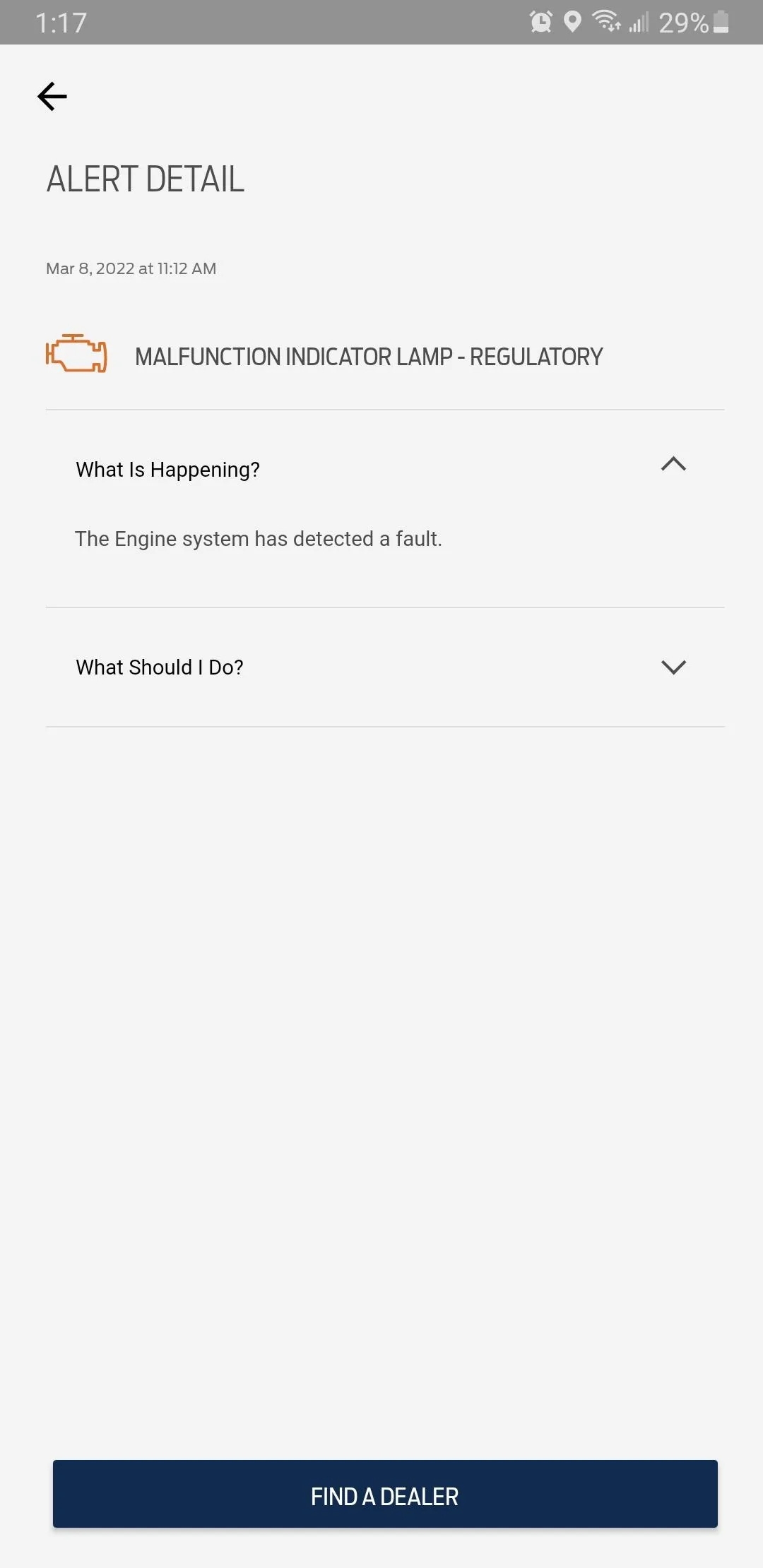

The same thing just happened to me. Xl hybrid with just over 1000 miles. I was merging onto the highway and stepped on it pretty good.(first really giving it power since I bought it). Soon after the CEL came on along with a red exclamation point. The dash told me to pull over when safe. I pulled over restarted the car and it started just fine but the CEL stayed on. Took it straight to the dealership.
The dealership said that it had to do with the transmission but it seemed electrical. They said Ford had an update for this issue that they installed it into the Maverick. Unfortunately they said the CEL came back on while they were testing it. So now they are thinking it is something mechanical.
I understand that this is a first year vehicle but it is still disappointing for this to happen to a vehicle I've had less than 2 months. Hopefully I didn't make a mistake going with a Ford...
Ford Maverick Hybrid check engine light comes on Screenshot_20220309-131737_FordPass
