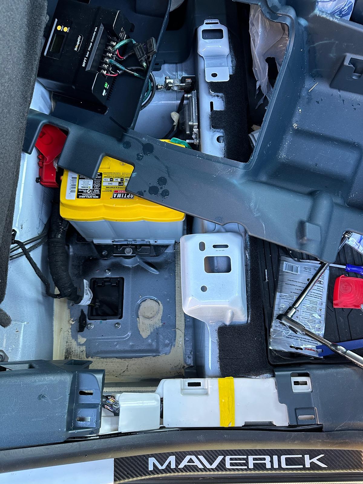

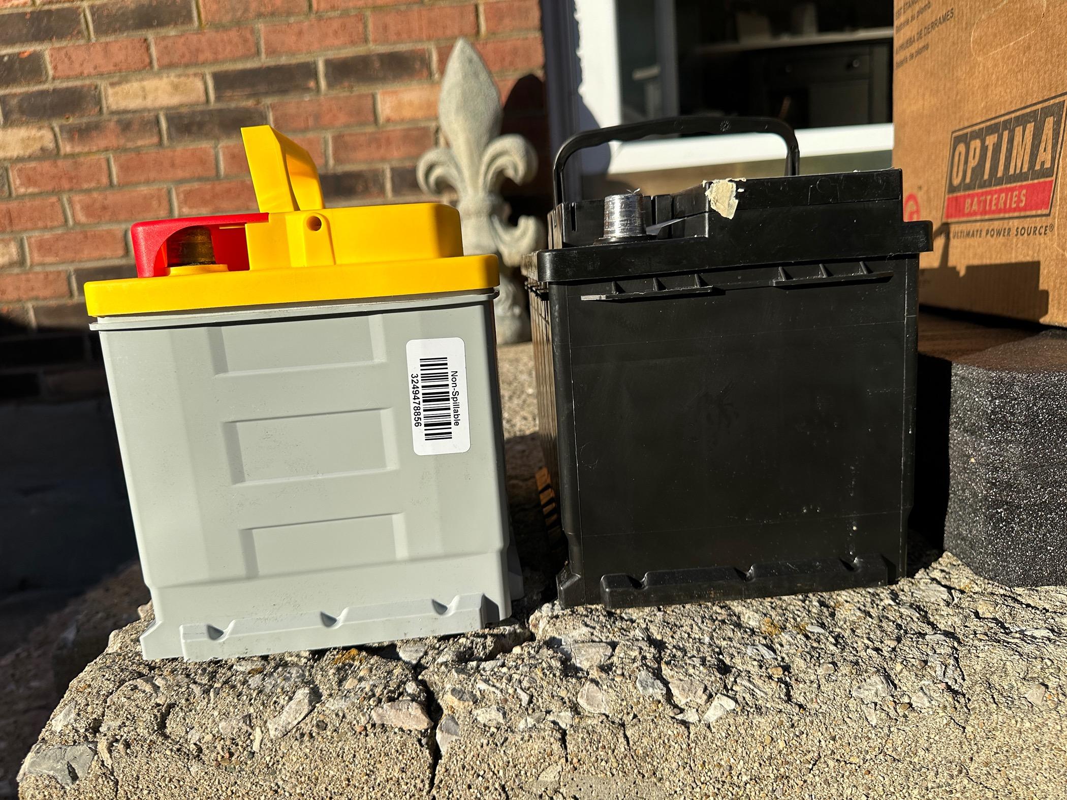

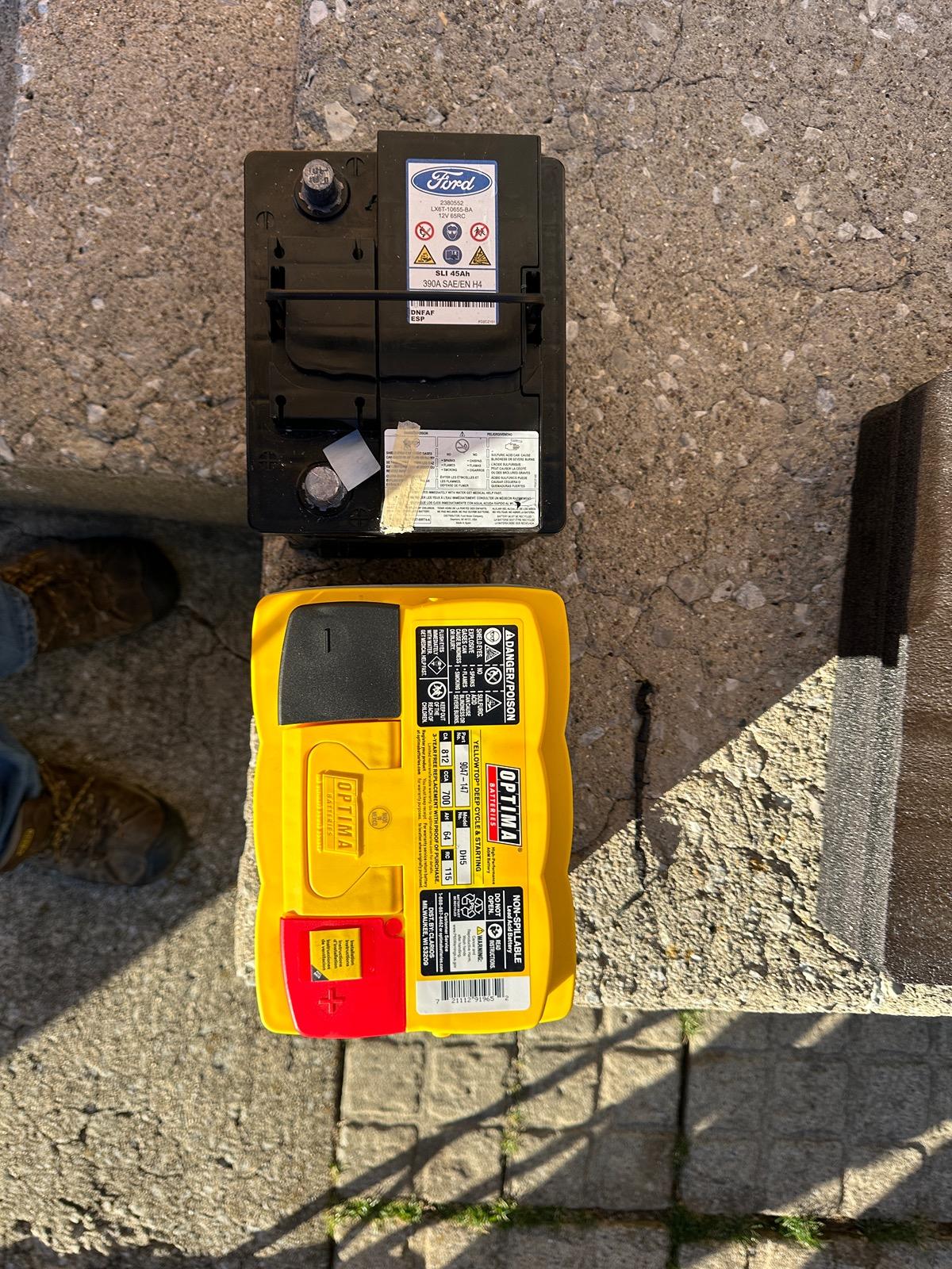

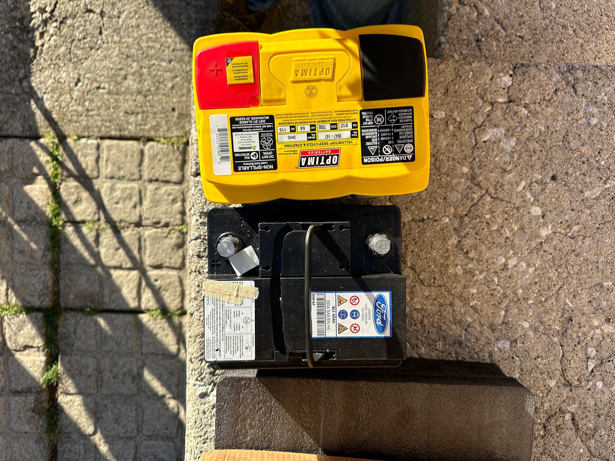

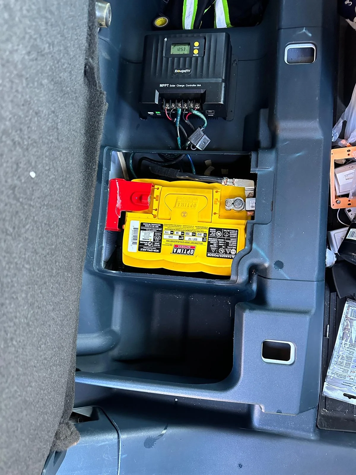

my optima yellow top is still going strong. No more deep sleep. I leave USB chargers on all night with no issues
When did you install the Optima? For how long have you been using it?
Tech Tye
Ken
Oct 10, 2023
217
193
Kentucky
2023 Maverick

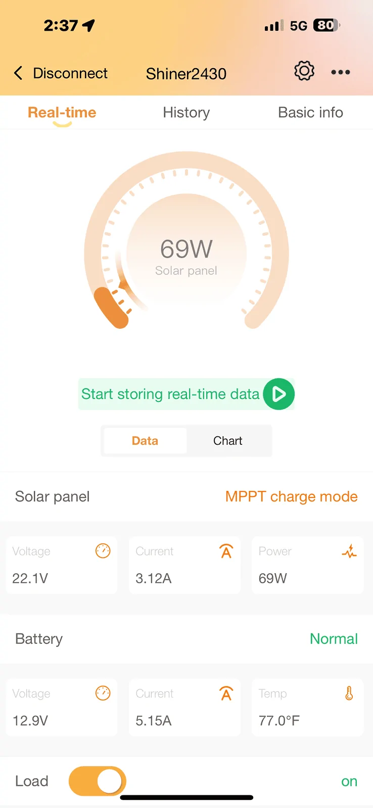

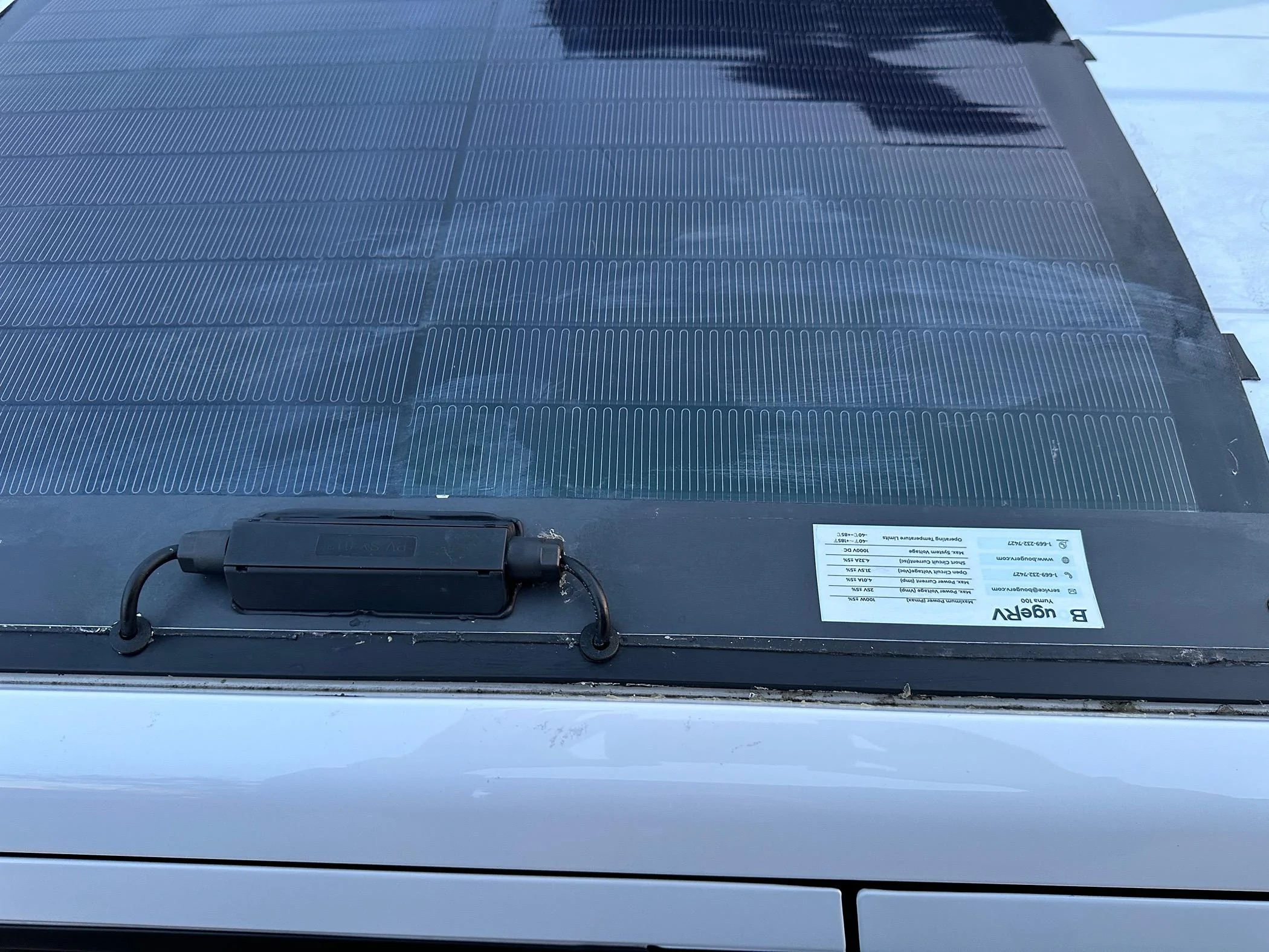

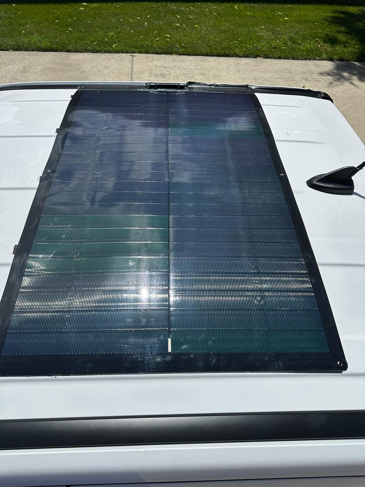

Since around last year September. I got fed up with the old battery not running my strobes for over 10 minutes after it was fully charged. I also would get deep sleep warnings after driving all day and parking for 15 minutes it would appear. Gone now! I also have a small 100 watt CIG solar panel on the roof that keeps it topped off when the truck is sitting there with the strobes running, it will charge the battery around 6 amps. That’s what the MPPT controller is for. I did do a small mod to get it to fit, small ears on the side were cut out with a grinder. Battery doesn’t move. It’s much easier to work with after pulling up the plastic trim around it. It’s cloudy today and getting 5 amps in the battery.CIG panels are super efficient .
