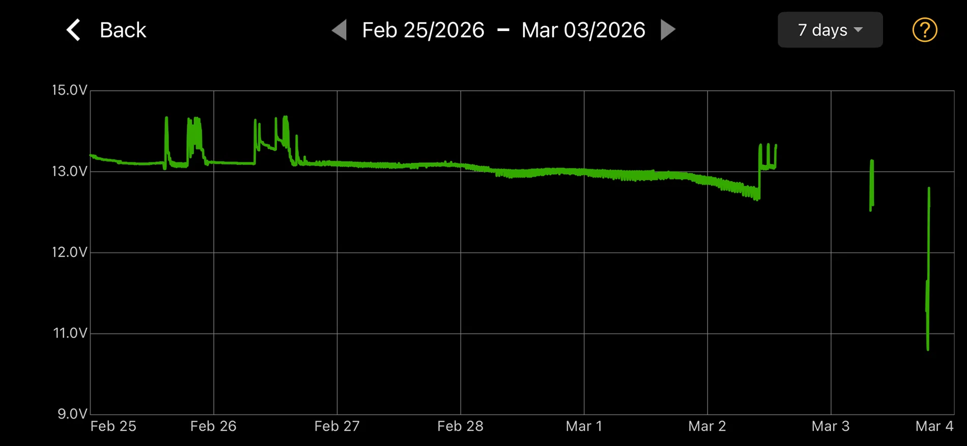

I like the suggestion. I just ordered one of these ODB2 sensors so I can monitor the SOC as the truck sees it. I will note that I've done the tape trick to get it fully juiced in the past, but I don't really think it's often that when I park after a 20 min drive that the voltage is less than 13.1V. What voltage is fully charged on the AGM?
The truck still has a rapid depletion of the battery (less than 7 days) -- I currently use a little bluetooth Voltage monitor, but don't really know how much it is helping me know because voltage curve and battery capacity are non-linear, and the logger stops working when the voltage drops out. See screenshot of March 2nd when the last deep sleep /dead battery occurred. The other screenshot shows normal operation when I don't let it sit.
What are your settings for the OTA functions?
Automatic Nightly checks, weekly, manual only?
Appears that faster drop on the 2nd was after a drive?
Wondering if you had a parasitic drain - several threads on that, which mistakenly include the undercharging this thread is dealing with.
2 software updates the dealer needs to do - one to the ACCM so not OTA available. Not sure if the ABS one is.

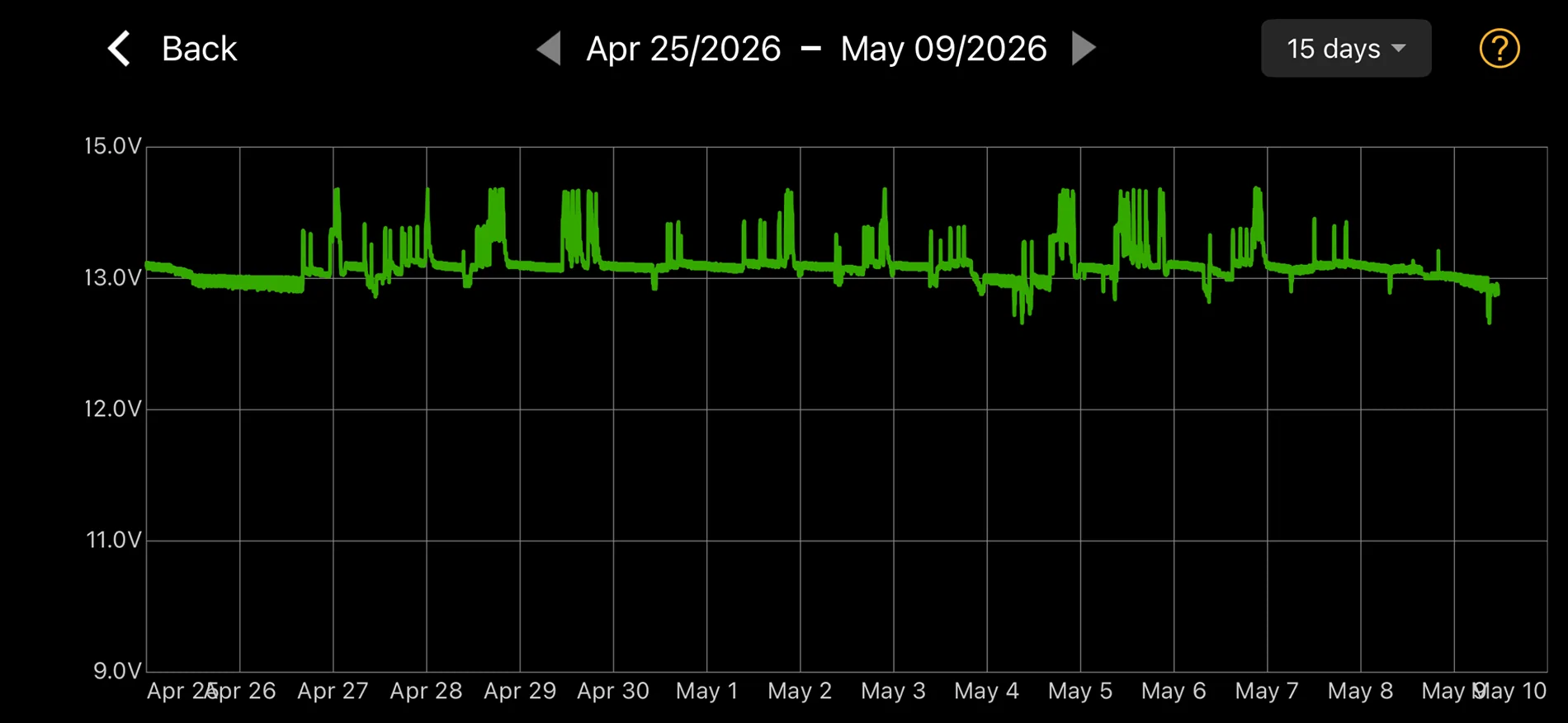

Didn't get a work-order, just the note below:
Unfortunately, that's all I got. The tech said "the vehicle battery monitor sensor needed to be reset." Whatever that means or does was not explained to me. Is that a process they could have done wrong? Voltages look good when fully charged on the battery so don't think the battery is my current residual issue. You very well might be right about the modem and failed coms though. You're better at troubleshooting than the dealer!

BMS Reset merely zero's out some tracking figures to start over on a new battery - informing system you have a new battery.
The next 9 hrs locked after that would do a BMS Relearn, for a 25MY probably learning about the state & health of the battery. For pre-25MY it has to estimate the battery specs, to then figure out the SOC & SOH.
They would have mentioned doing updates if they did it.
You should ask - since I had a 1 night battery drain and never a prior issue, don't the current SSM's regarding that apply?
The OTA aspect is just to slow your drain since it sits for awhile. Don't mention that to them - they confuse easily.
