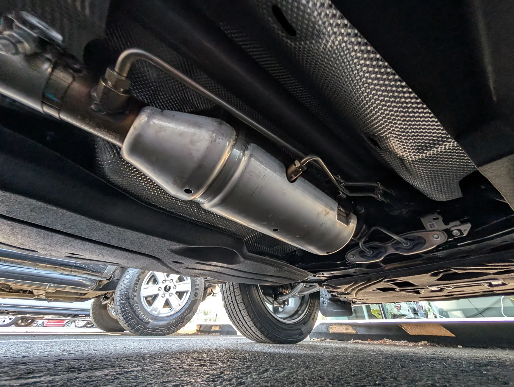

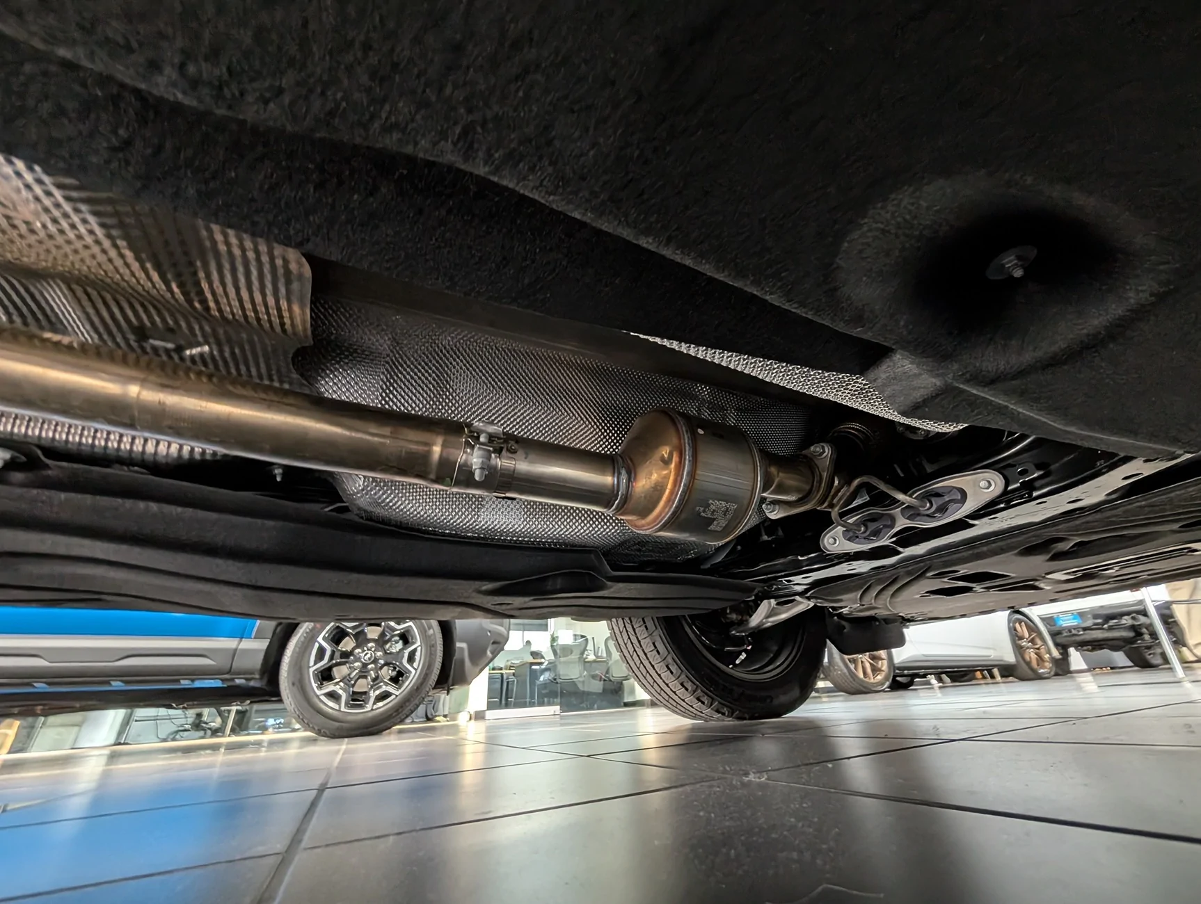

I was at a dealer in Oregon (CARB state) checking out Lobos, one had a GPF and the other didn't. Both window stickers have the 50 State Emissions option. The Lobo without the GPF had 4/23 on the window sticker and the Lobo with the GPF had 6/17.
Here are some pictures I took comparing with and without the gasoline particulate filter.

The non gpf lobo looks like it doesnt even have a secondary cat? Buy it!

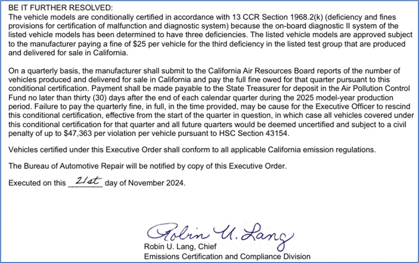

I don’t (and probably never will) understand why the Job 3 ’25 Mavs have GPF’s. Lots of oddities in the files data. Initially I thought the PM values had to be 1 mg/mile for the different tests and that the GPF was only way to get there. But doesn’t look that way to me, even the test data for a ’24 non-MPC 2.0L is below 1 mg/mile (and so is the ’25 MPC but no GPF 2.0L). So I’m guessing other emissions come into play to meet CARB LEV III (which includes MY2025 vehicles) and to meet upcoming CARB LEV IV regs (for MY2026 and beyond) and whatever federal Tier 4 regs require. It’s beyond my understanding or caring.
Other oddities for me:
*Didn’t realize the costs involves for testing – many hundreds of thousands of $ Ford paid the EPA.
*The ’25 Ford 2.5L hybrid had 3 x CA OBD II ‘deficiencies – with fine’. Not sure what they are. A $25 fine/vehicle ain’t bad but the penalty for quarterly non-payment seems harsh….

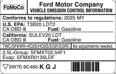

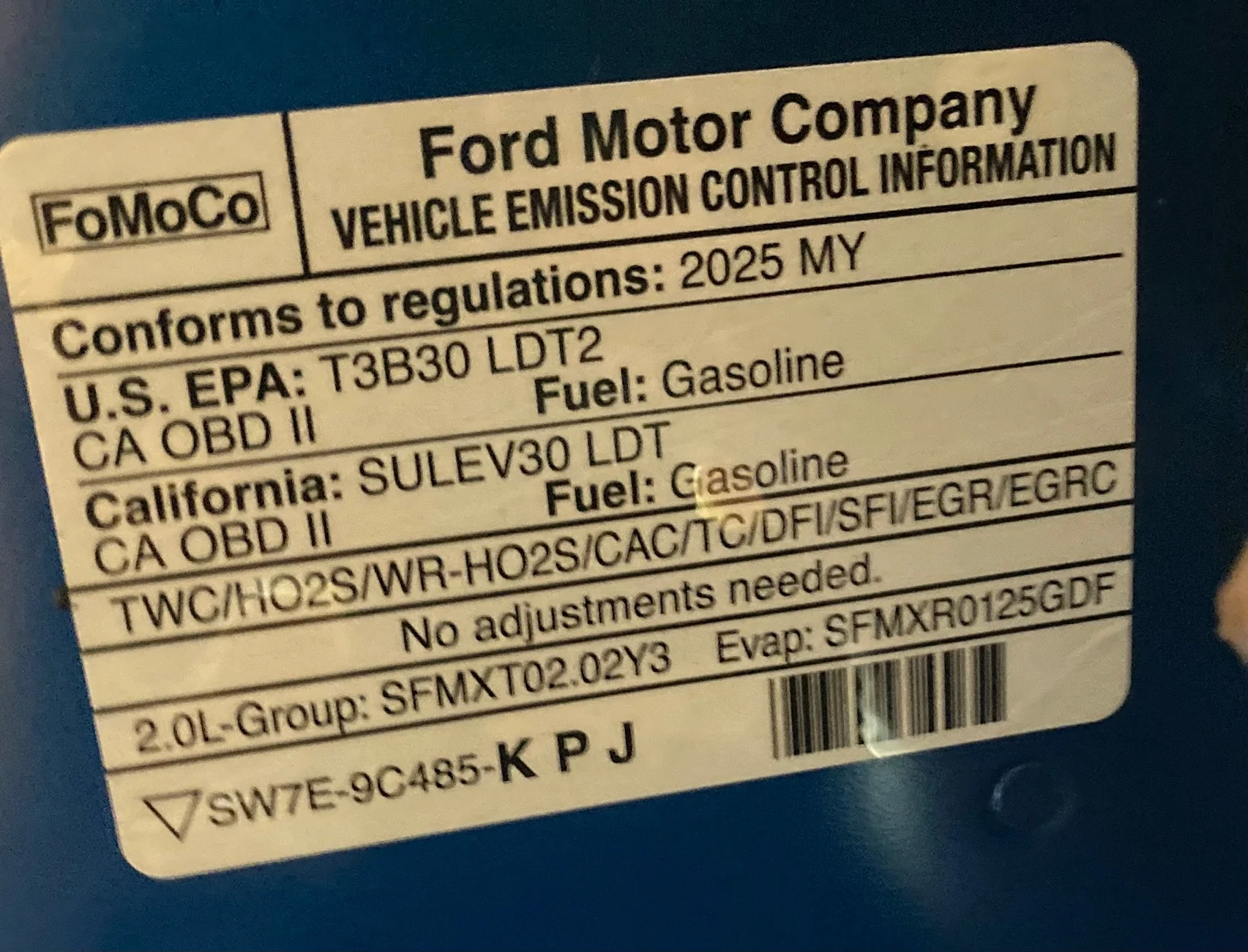

Decal under my hood has the California Designation as SULEV. That stands for Super Ultra Low Emissions Vehicle.
My fears that CA would consider my non “50 State Emissions” truck a “dirty little Maverick” were unfounded. Dude - I’m Super Ultra Awesomely clean!
In the recent past California was giving stickers for SULEV to drive solo in carpool lanes.
Ford Maverick How to tell if a Mav has a GPF from the sticker? IMG_9396
I’m curious to see the decal on a Maverick that has a GPF…

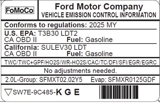

From above attachment, I think looks like this:
Ford Maverick How to tell if a Mav has a GPF from the sticker? VECI_25 GPF

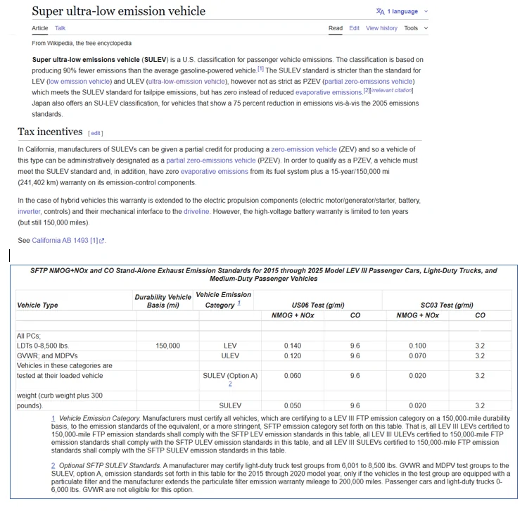

Aha...I didn’t think things through on all the reasons Ford maybe put the GPF on the ’25 Mav Job 3 2.0L’s. I forgot rule #1, follow the money. They brought the ’24 2.0L from a ULEV50 to the ’25 2.0L (either with or without GPF) now being a SULEV30. There’s money (partial credit) in that. Still don’t fully understand how that optional SULEV standard thing works, maybe that extra 300# they give pushes it over 6000 lb GVWR, IDK.

Thanks for the Pictures with the GPF and without Mine was built in Jan 2025 and looks like the bottom picture underneath My Maverick.
IIRC that's the secondary Cat in the picture the Primary Cat is up closer to the engine and You can't see it in the picture.
Correct. The secondary cat is still there - but is now covered by that fancy GPF housing. The primary cat is still up out of sight where it’s always been.
