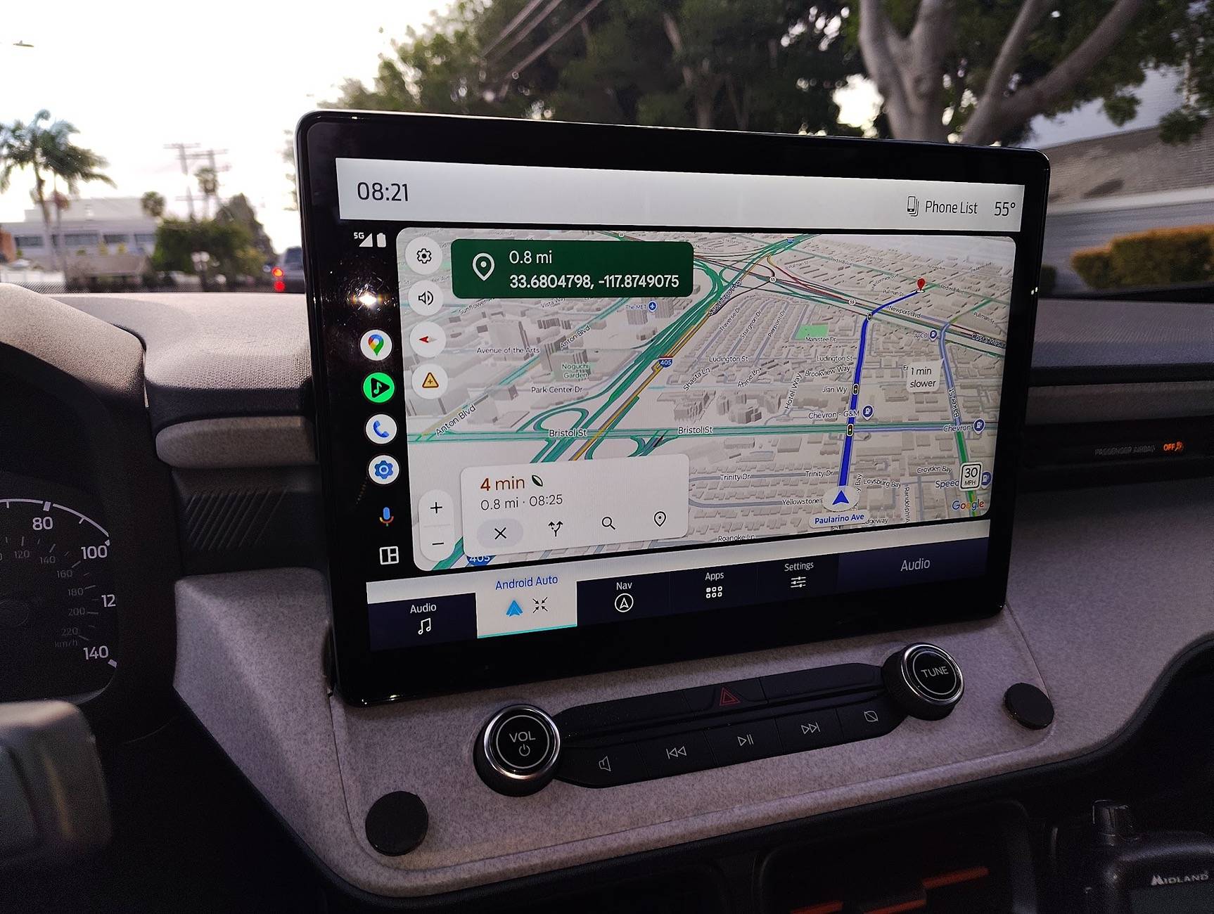

Add another one to the done & dusted category. '24 XLT Hybrid.
Only outstanding issue is that android auto is not muting the audio when giving directions. Is this how it works with Sync4 or am I missing something in the programming maybe?

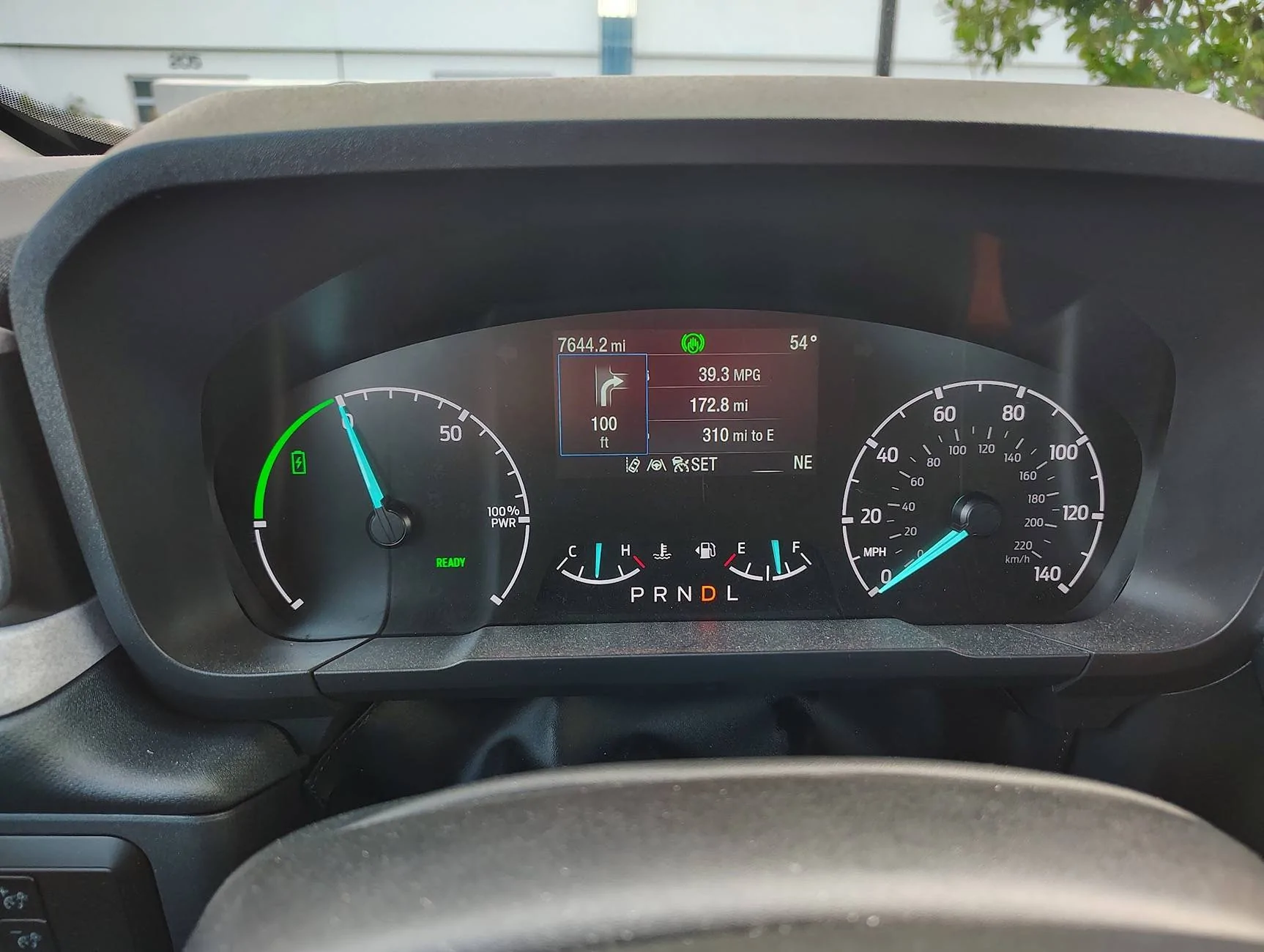

I was not expecting to see this pleasant surprise. Turns in cluster!

Both AA and Sync Nav work great!

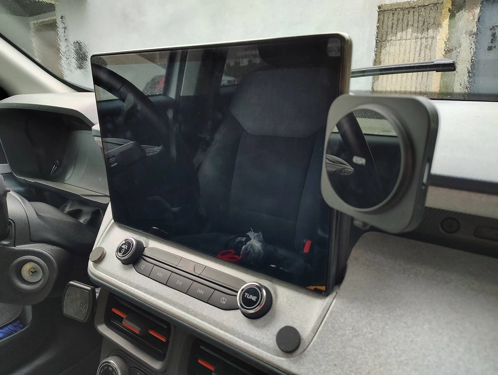

A quality de-pinning tool is a must for this project. You also want to make sure your soldering skills are up to snuff and have shrink tubing and a good heat source/gun. Also make sure you give yourself plenty of length so you're not yanking on the harnesses. Color code your wires and make a wiring diagram/spreadsheet to keep track of the connections as you go.

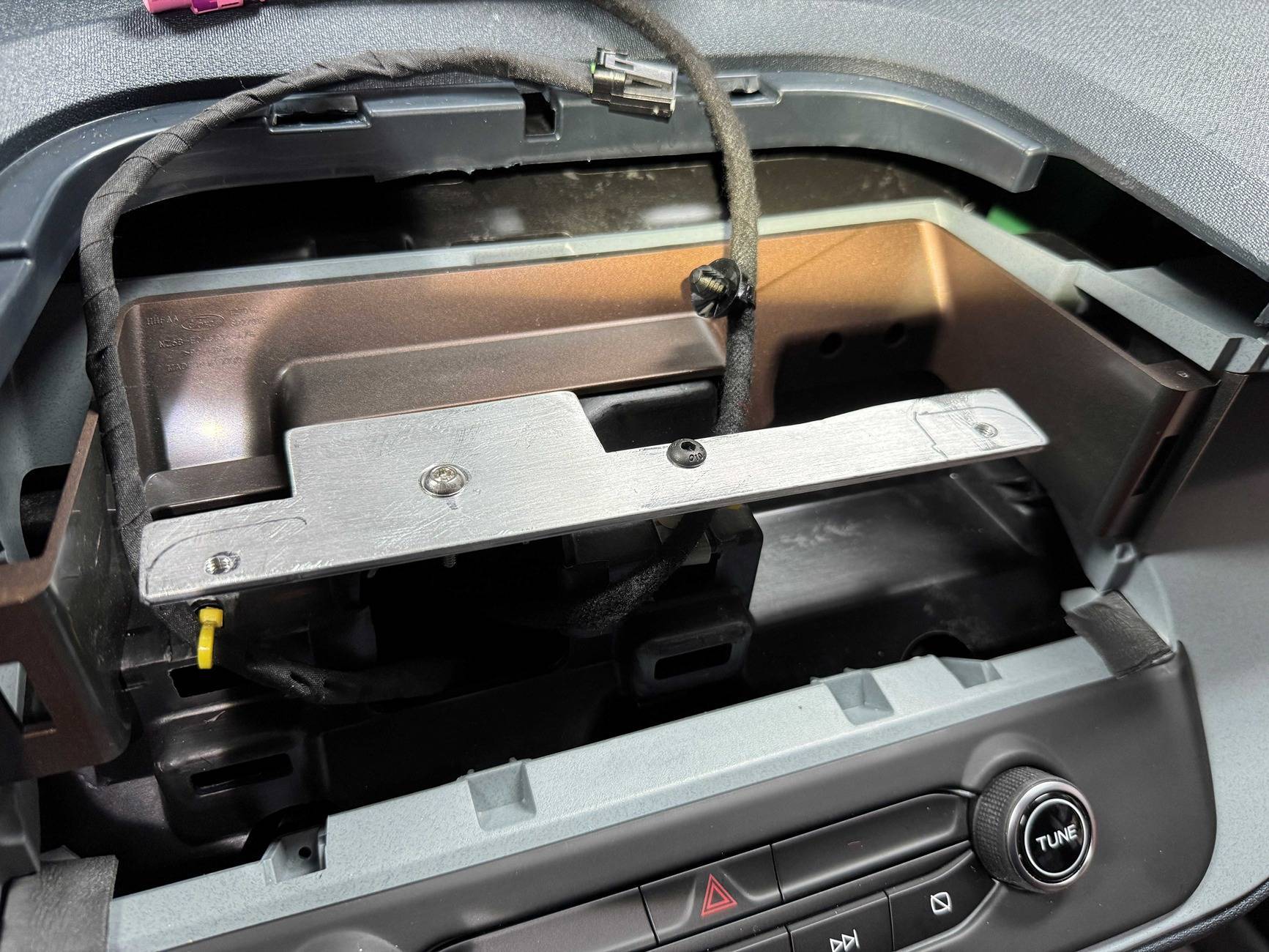

I was able to mount the APIM using the OEM bracket. Bed the tabs a little and use a sheet metal screw with a body clip to secure the sides. Middle screw uses a nylon square nut.
Ford Maverick How To: Sync 3/4 swap for non Sync 3 XL/XLT Screenshot 2025-03-08 at 10.29.12 AM
Ford Maverick How To: Sync 3/4 swap for non Sync 3 XL/XLT Screenshot 2025-03-08 at 10.30.56 AM
Ford Maverick How To: Sync 3/4 swap for non Sync 3 XL/XLT Screenshot 2025-03-08 at 10.30.51 AM
I used a variation of the mounting that @Bobert47 used in this post:
Ford Maverick How To: Sync 3/4 swap for non Sync 3 XL/XLT IMG_5324.JPG

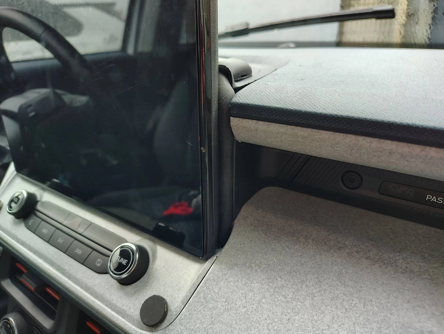

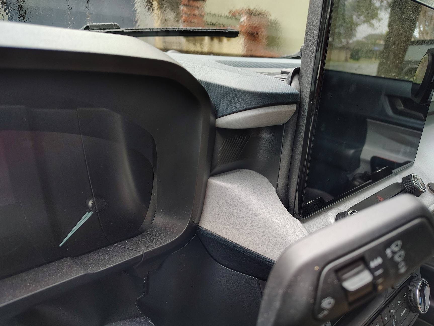

I found the install a bit wobbly without all 3 screws securing the aluminum bar so I countersunk the left one and used a flat head cap screw to secure it. It will not interfere with the screen bracket if it sits flush. OEM screw in the center and a longer pan head on the right. I had some spacers in the junk drawer that fit for the left and right screws. Sorry, no pics of mine, I was in a hurry to get it done. I did not contour the bar, only cut width and depth to fit the hole. There was more than enough room to fish the wires through. There are some gaps on either side but it is nice and secure. Looking for ides on how to fill it in. Maybe a section of round rubber gasket?
The screen itself is attached the same way (2 holes drill & tapped, center stut cut off) with the largest screw size that would fit the steel bracket (M6?).
So far so good. The screen is MUCH sharper and easier to read. I wish the stock screen had been just a bit bigger as I really had no complaints about the Sync 2.5 system. The radio worked and AA worked with my wireless dongle. Maybe I got lucky?
