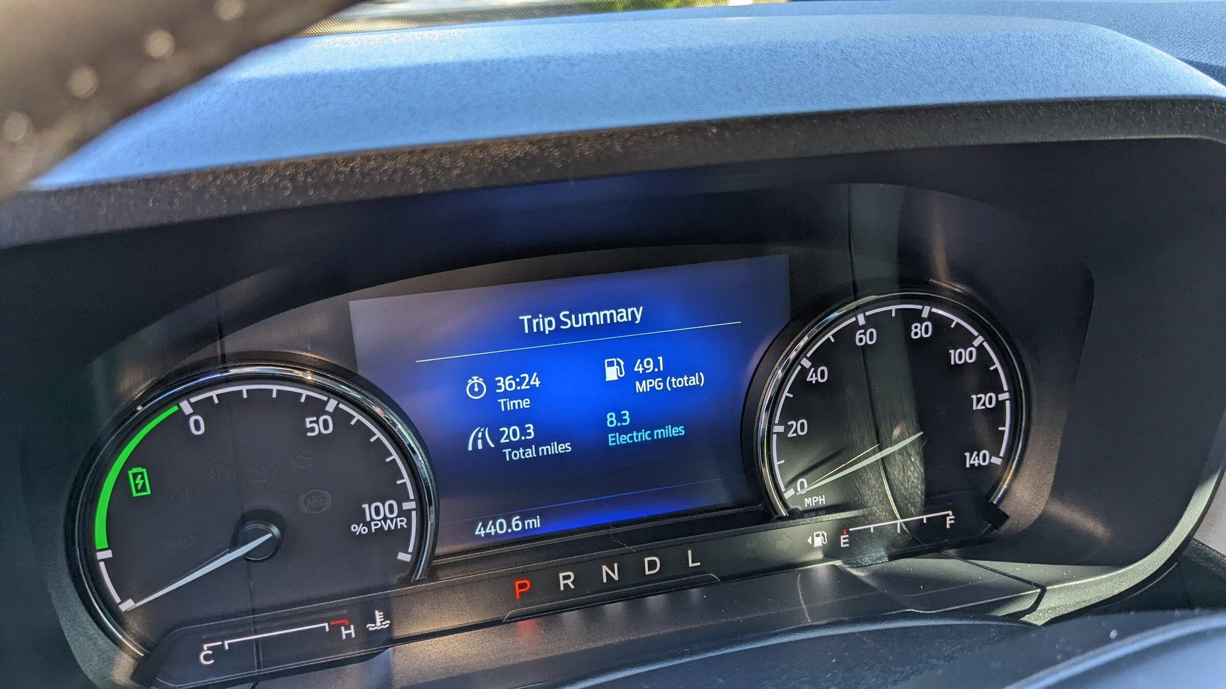

The Maps app usually has an Eco mode friendly route you can take. So I tried it out, and drove as normal as I could. I think this was my best mpg I've done. There was traffic on the way home so that slowed me down. If I took the Eco Mode friendly route to work it wouldn't have taken as long. It probably be slightly better if I had remembered to switch to Eco Mode, but Normal mode is just as good.

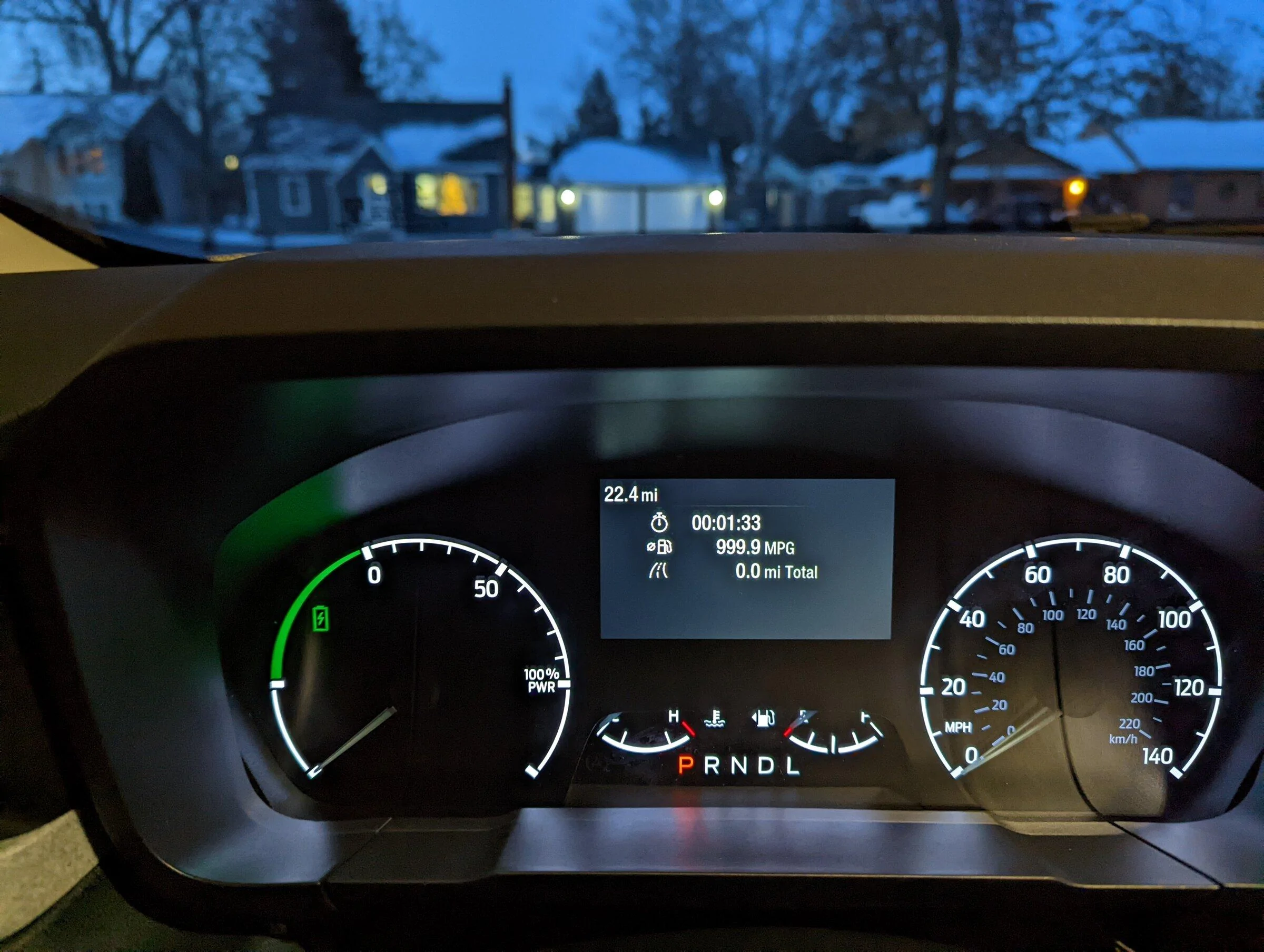

One thing I've noticed in the first couple days driving my Maverick is that the real time MPG monitor actually shows higher MPG with "moderate" acceleration rather than "light" acceleration. That said, I'm not putting too much stock in the hybrid's performance and mileage characteristics right now since it's not seen the warm side of 20°F yet (currently -6°F), but I'm wondering if others have seen this as well.
