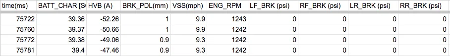

I don't recall what was going on here, maybe a red light going green with traffic, because I didn't have to stop completely as brake pressure never came on and brake was let go at 5 mph, but almost coasting to 0. So no
Had been slowing from 29 mph, ICE was on because below 40% SOC.
Maybe brake pedal being 1 mm or less mattered.

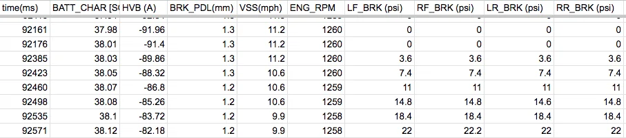

Here's another same trip.
From 25 mph braking to a stop, ICE on below 40% again.
Amps higher with ICE but still in regen, brake pressure started at 11.2 mph. Brake pedal over 1 mm. Still not upwards of 3mm a hard press comes in at.

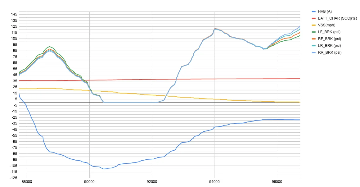

This is the full stop info - dug into pads for whatever reason initially, but backed into total regen again with no pressure applied at 18 mph. Until that 11.2 mph auto-pressure overlap with regen. The max brake pressure at 5 mph had pedal at 0.8 mm from then on. Was actually at 1 mm at 7.5 mph.

Alright, that answers my question.
I was not looking for anecdotal evidence. Your graph and data proved to me that while my truck says I’m still in 100% regenerative mode, the trunk in fact is applying the physical brakes!
Bob
Ya, the EV and Brake Coach must be showing if you are getting the max they will allow.
So 100% recovered - of what they were going to allow.
Totally in the regen box as speed slows - not counting the pads they are going to gently use.
As commented on - some overlap works a whole lot better than switching from regen to the pads.
I might see if I can find a hill that allows a speed with that light brake pedal at constant below 10 mph - say going down a hill in slow traffic.
Would that ride the brakes the whole way to some degree? (seems like it)
That might be a case for Low mode taking the whole load - and hoping the goofball behind you can tell that despite no brake lights - you are not speeding up.

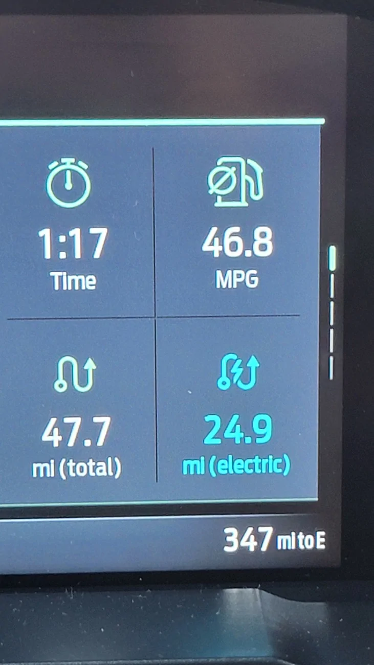

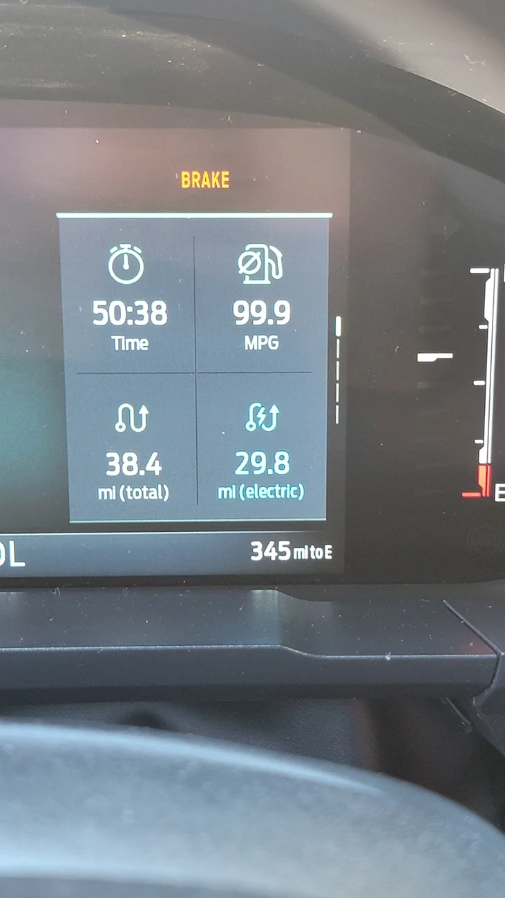

●Econ mode must be set each time as normal mode is default. No way to default it that I know of.
●L selector if in town adds to regeneration.
●Turn off the AC or heat and use fresh air only if possible.
●Anticipate and use regenerative braking
●Did a Sunday to Tahoe yesterday, 29 mpg up the mountains all Hybrid.
Kirkwood to Sutter Creek 99.9MPG 50 mins 38 miles with 29.8 on electric... downhill lol.
Sutter Creek to home 46.8mpg over 47 miles of country roads and suburban city streets.
Do I win the game?
