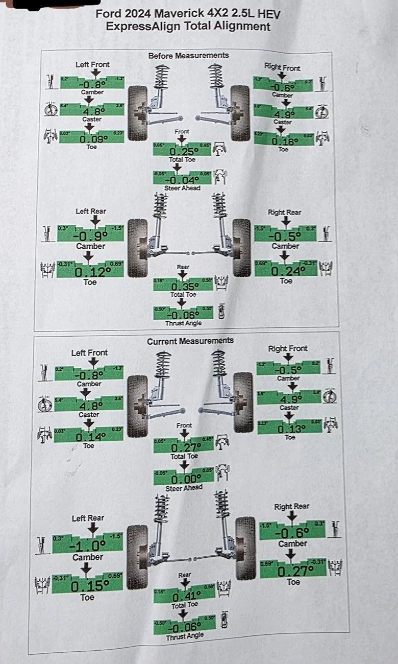

Can you post the alignment measurements?
A consistent pull is typically too much negative camber on the opposite side. Could also be rear alignment.

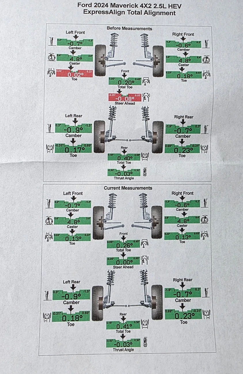

Here's the alignment reports. The one with all the red is the first one. The other one is a week or so later.
Ford Maverick Alignment problems? 20260606_171430
Ford Maverick Alignment problems? 20260606_171412

For some reason it uploaded one of those images twice. There are only two reports.
