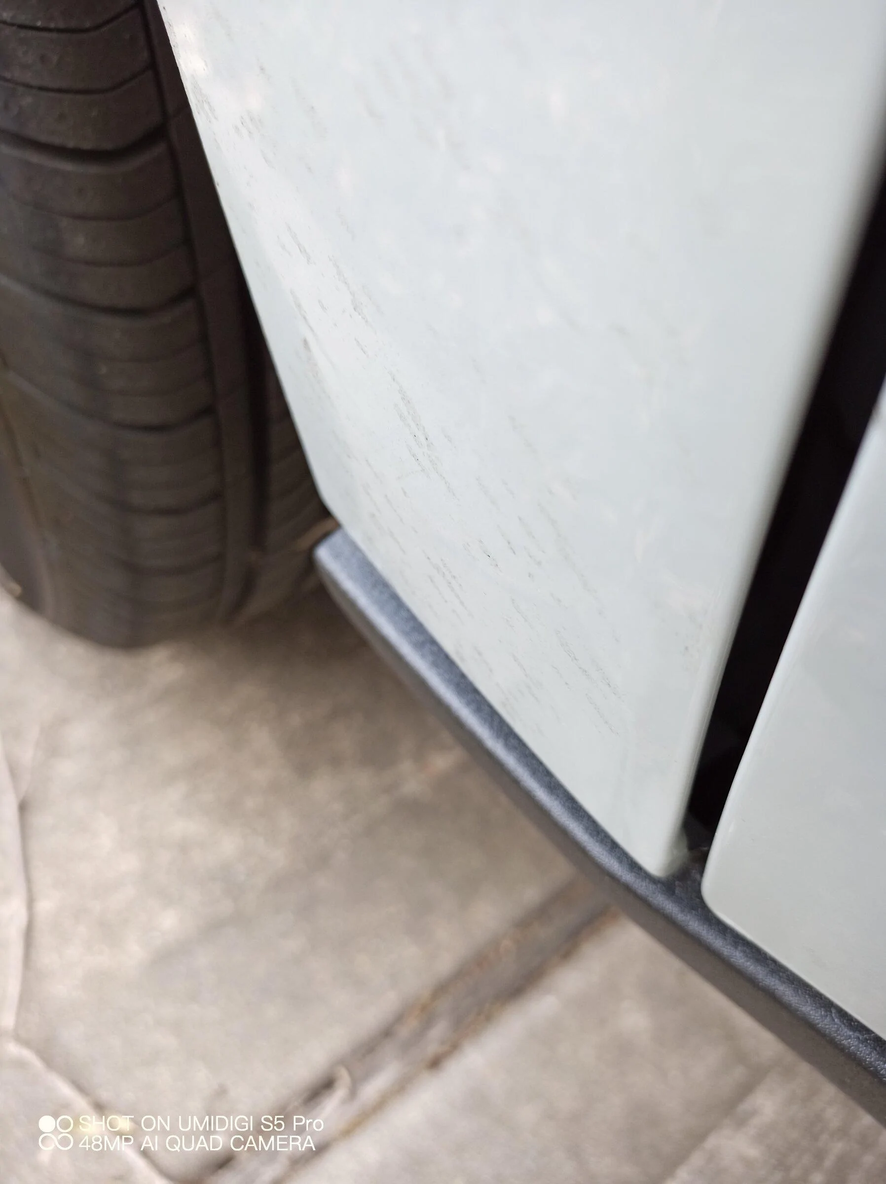

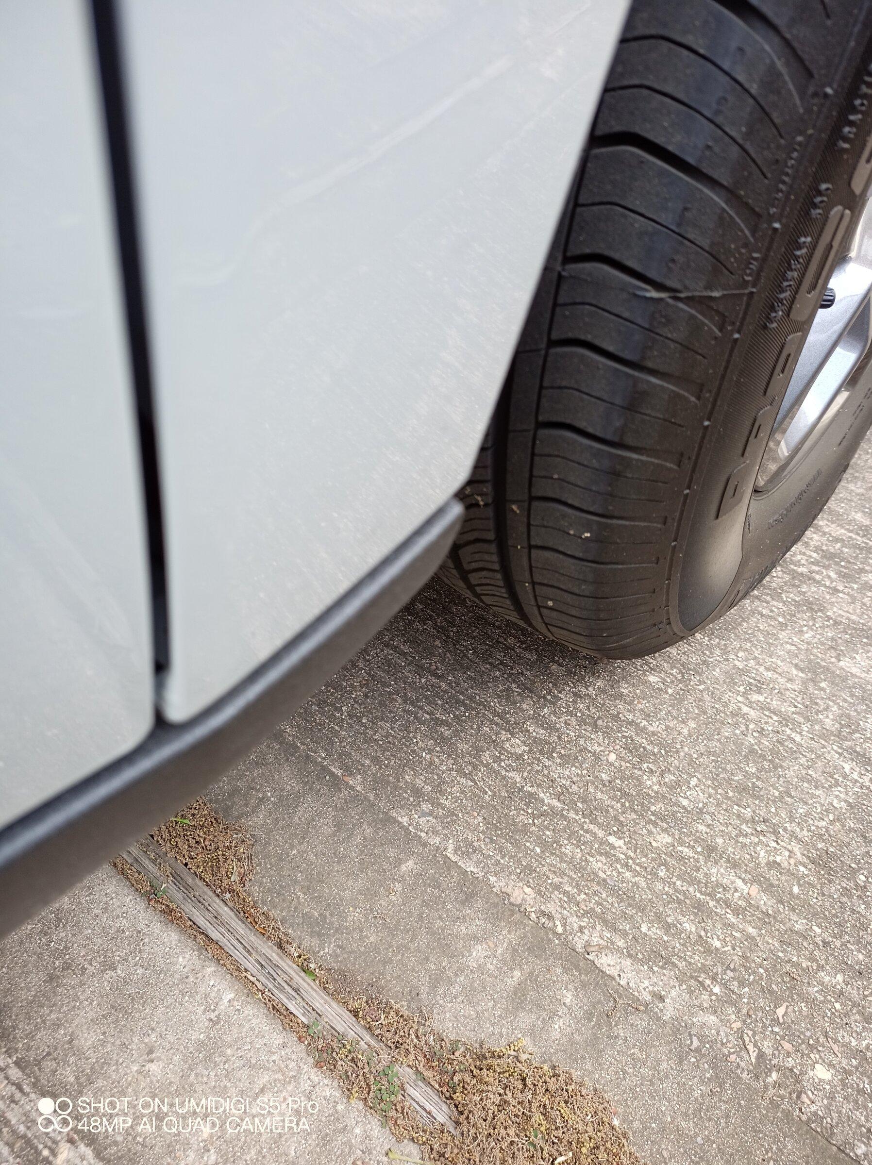

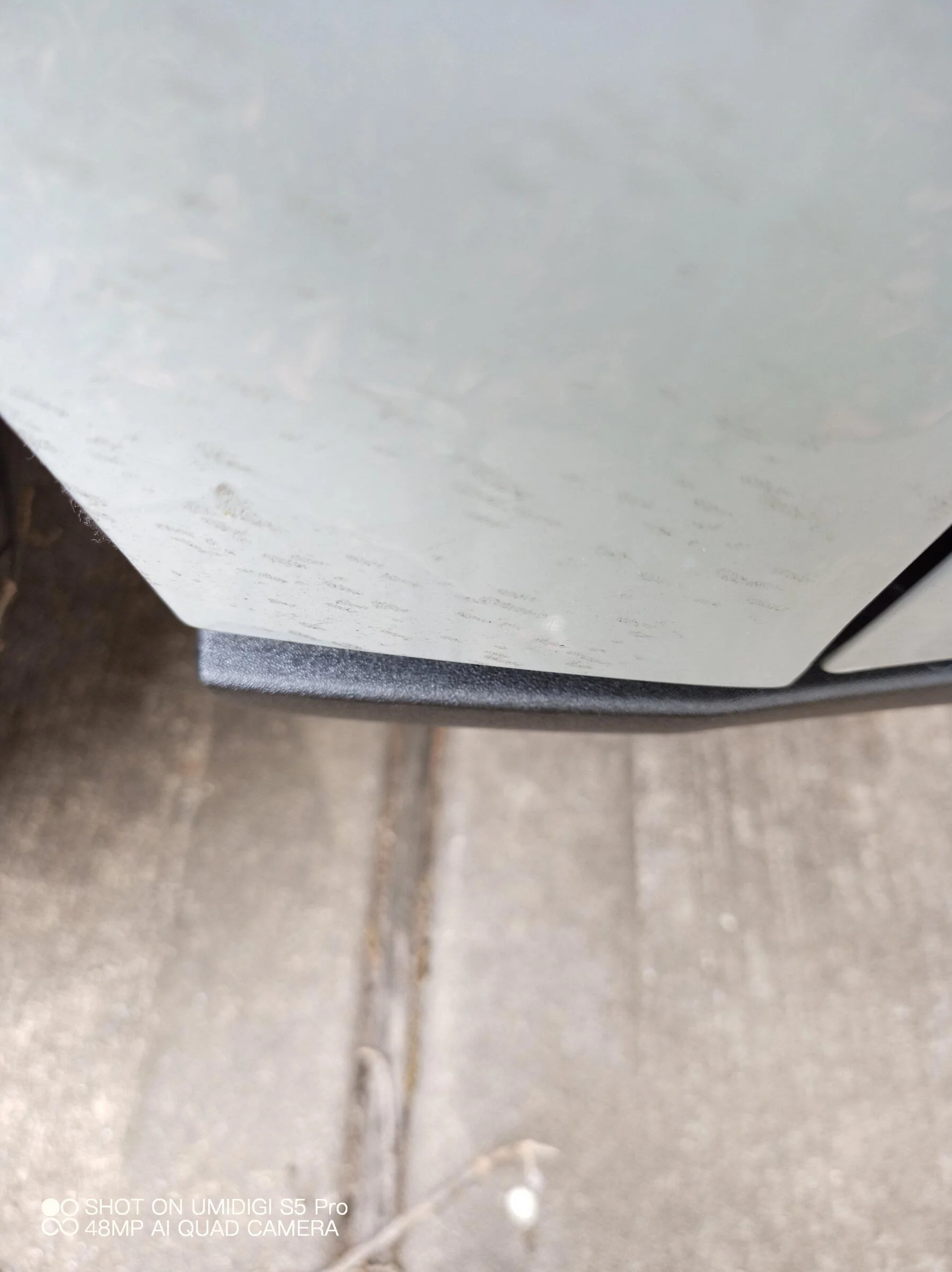

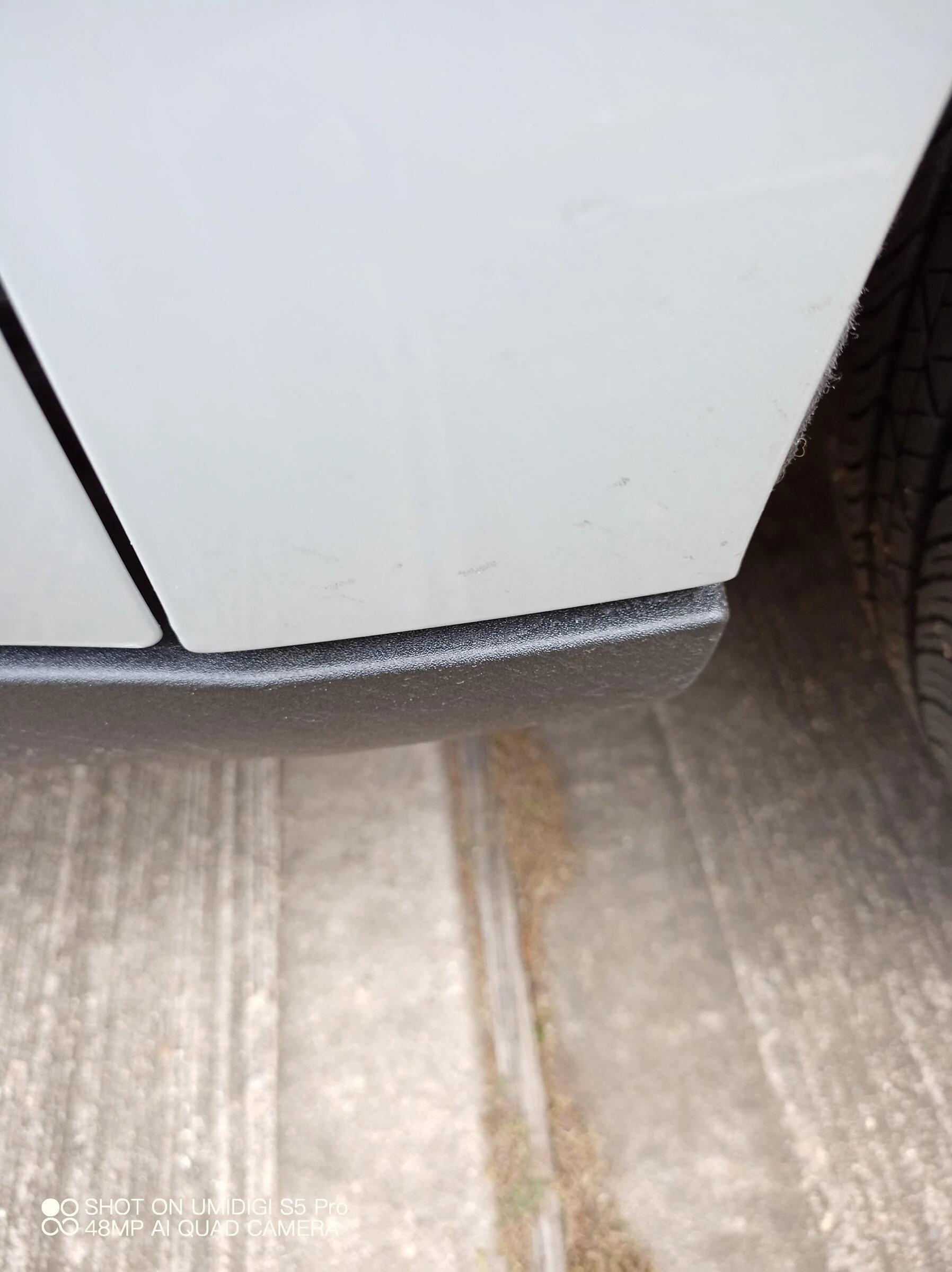

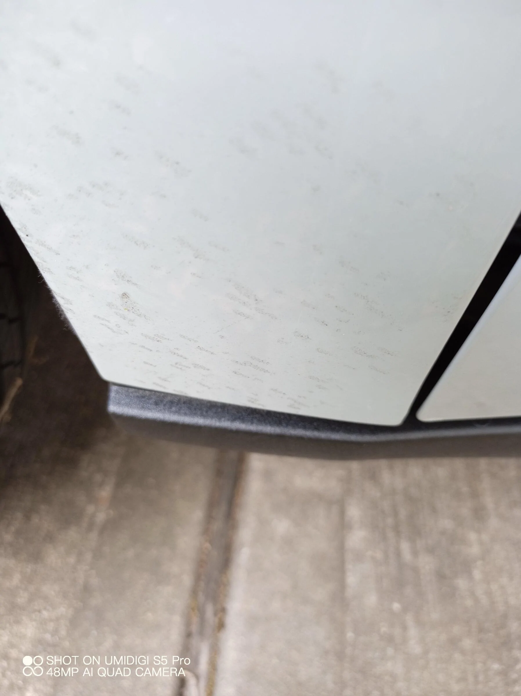

Front driver fender just aft the front wheel seemed misaligned vs passenger side. Plastic sticks out or fender pushed in on driver side vs flush on passenger side. Planned to get molded splash guard but may have big gap on driver side.

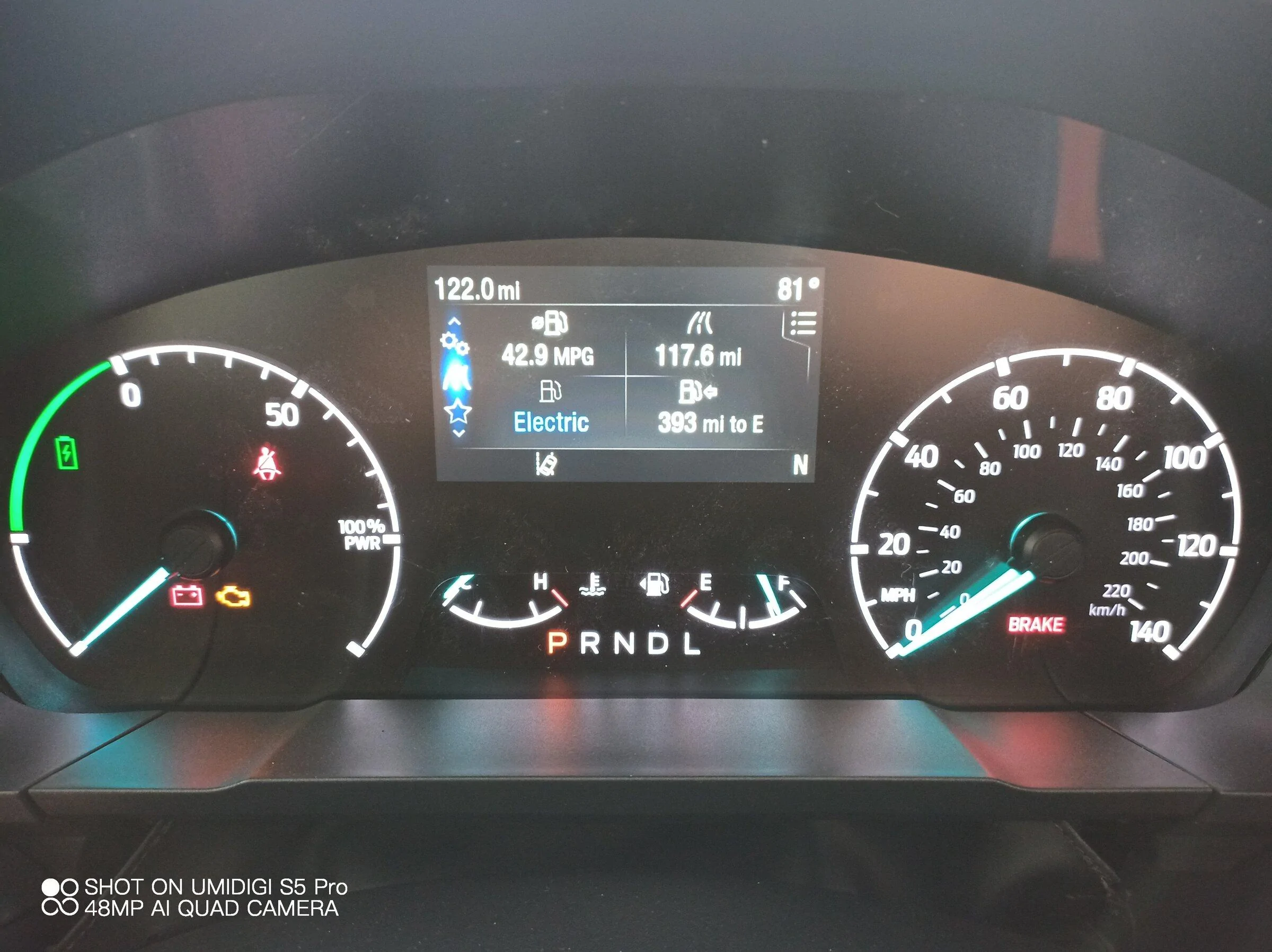

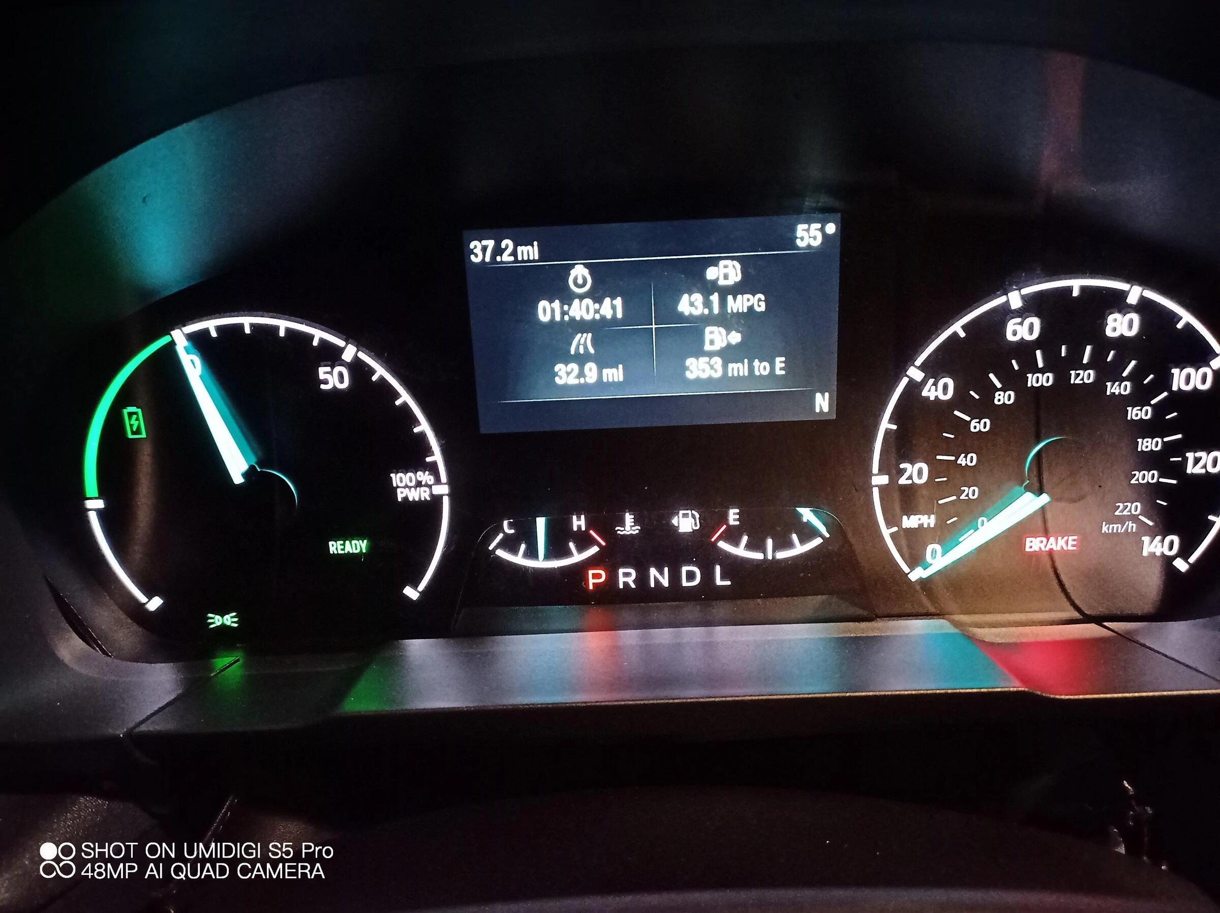

Great gas mileage so far. Mixed city & hwy. 122 miles total with 42.9 mpg computer reading. Haven't driven enough to fill gas tank for hand calculation.

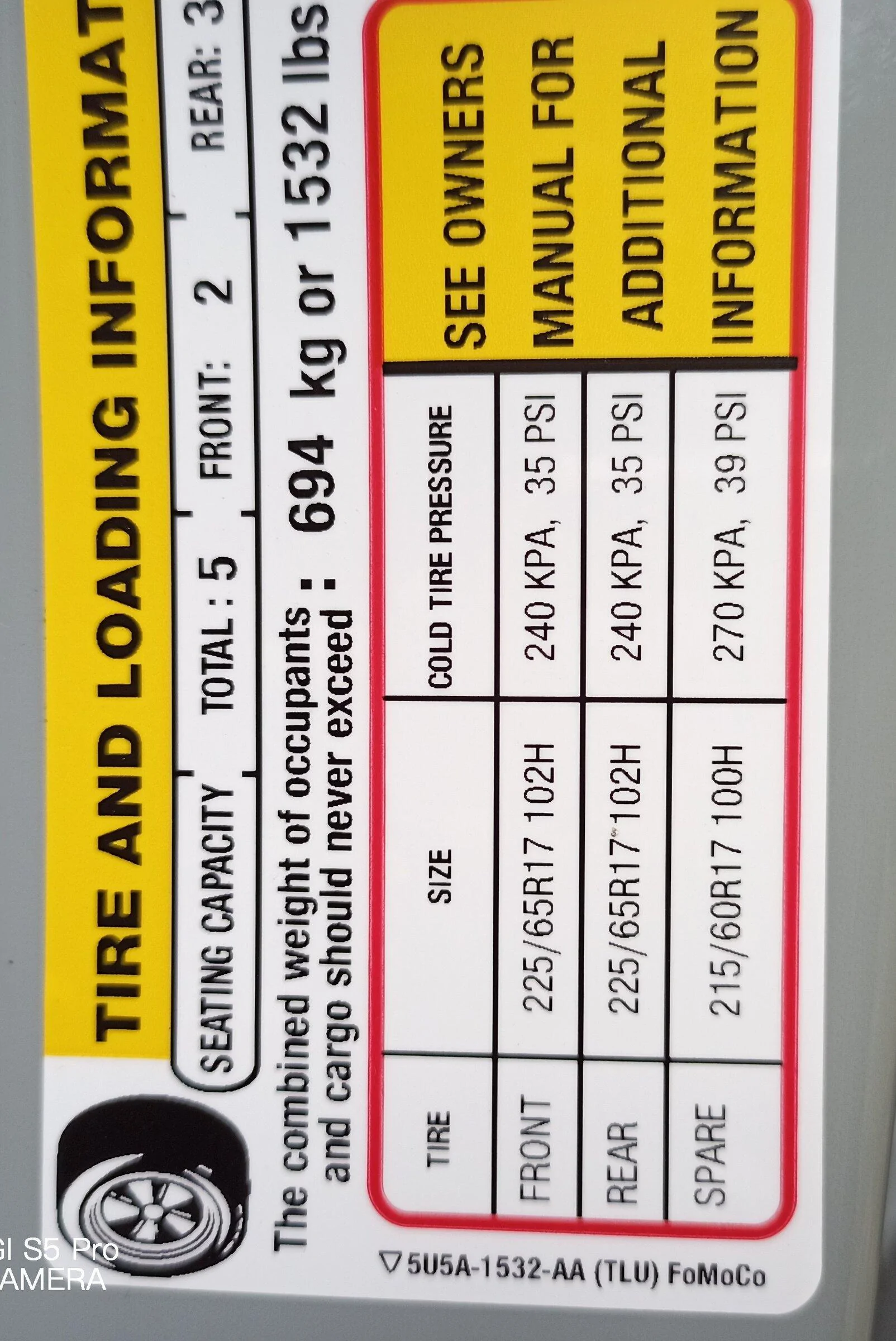

Factory tire pressure inflated to 39 psi.

One more thing. Maverick hybrid distance to empty increases as I drive. RAV4 hyrbid distance to empty drops faster than mgp/mileage traveled. Both computers display similar mpg numbers.

So, the pedestrian alert works regardless of gas eng on or off, forward and reverse, and the Distance to Empty is based off the average MPG for the past 500mi, regardless of when the trip meter/avg MPG was last reset. Because it's based on cumulative mileage, it's also affected by any idle time during assembly, setup and/or dealer prep. After you've put 500mi on the truck yourself, the DTE should be accurate. Tire pressure, 39 is a bit high, but honestly, I usually leave the tires a psi or 2 high during pre-delivery setups myself, knowing it'll drop over time. The brake pedal feel takes a bit of getting used to, as do a few of the drivetrain noises. I wouldn't be too concerned about the clank, esp if it hasn't acted up since.

Braking is different than my other vehicles. You have to get use to it. Alignment, talk to the dealer about fixing it.

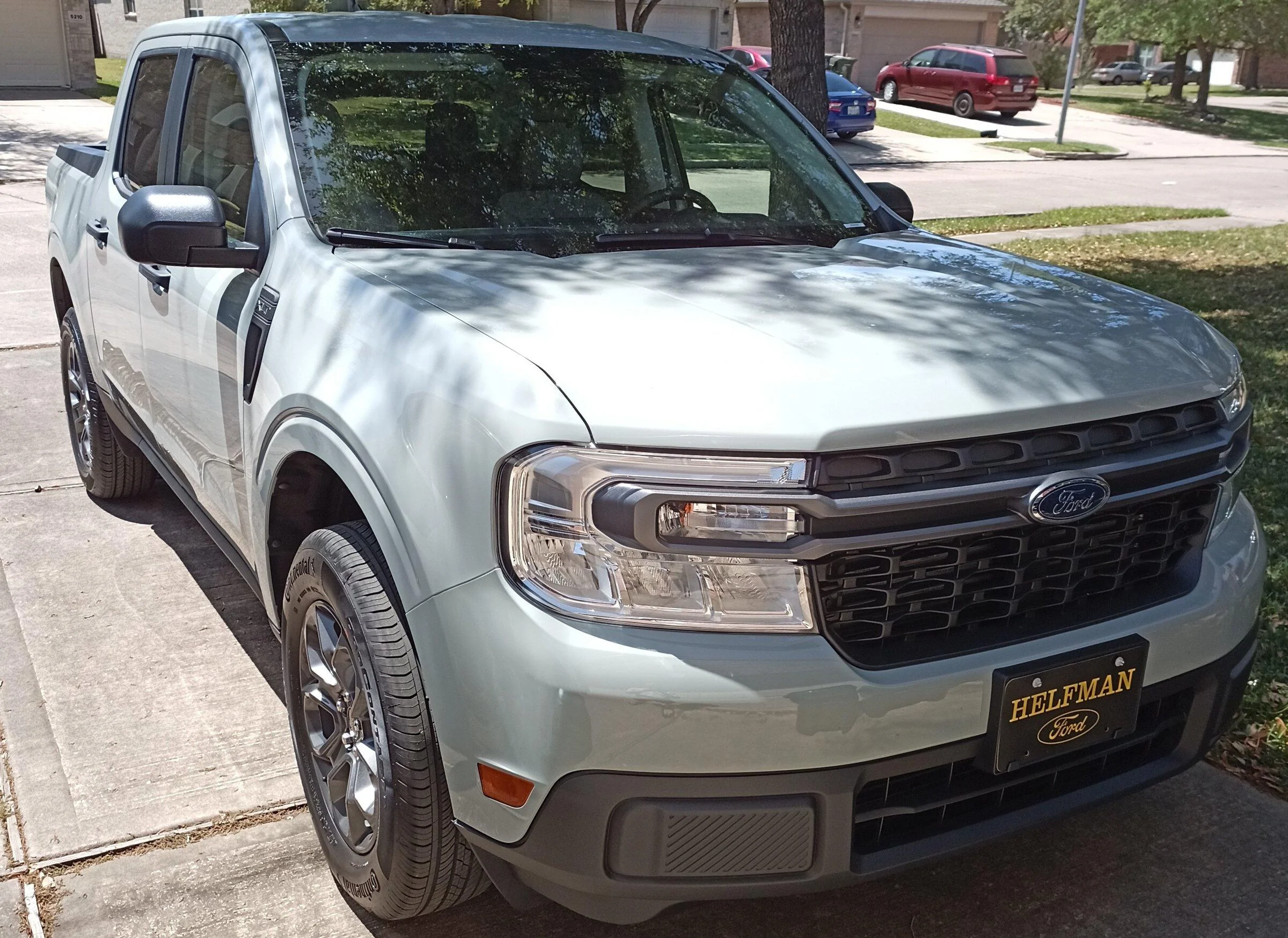

Yup, hood is lower on driver side.
