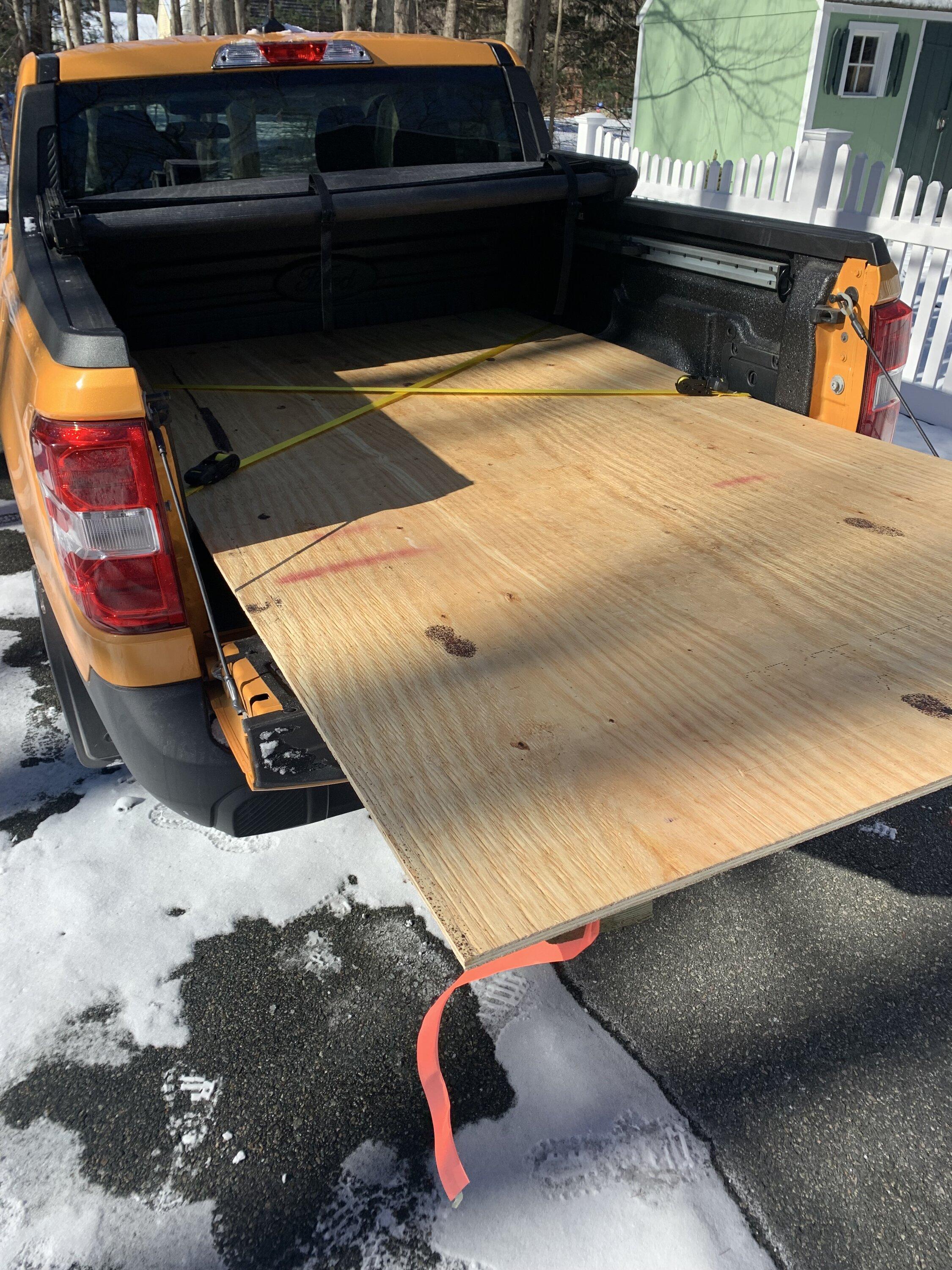

This weekend:
Saturday: two sheets of 5x5 Baltic birch plywood at an angle (had to remove the folding tonneau cover) but forgot to take a photo
Sunday: one sheet of 4x8 of cheap plywood and two 8-foot 2x4’s
both times it took me 15-30m in 20-degree weather to find the best way to lash it down — I think I need ratchet straps that have more adjustability, or to revisit my boyscout knot-tying lessons and use regular rope
in this photo, hook end in the anchor by the tailgate, up through the D-ring at the front of the bed then diagonally across to the opposite side of the tailgate was the best fit for the straps
Ford Maverick Hauling plywood experience IMG_5360

For VERY LIGHT loads, just use the hooks on the tailgate.

Get yourself some soft-tyes, these extend the length of your straps, and you can leave them attached to your D-rings and tie down hooks so you don't have to reach under the 4x sheet.
https://www.powertye.com/collections/soft-tyes/products/1in-12in-soft-tyes

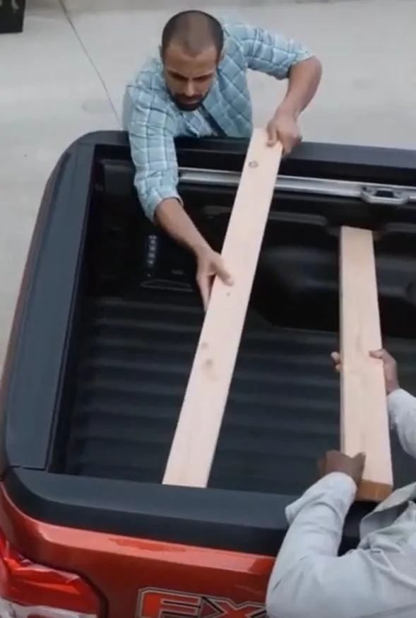

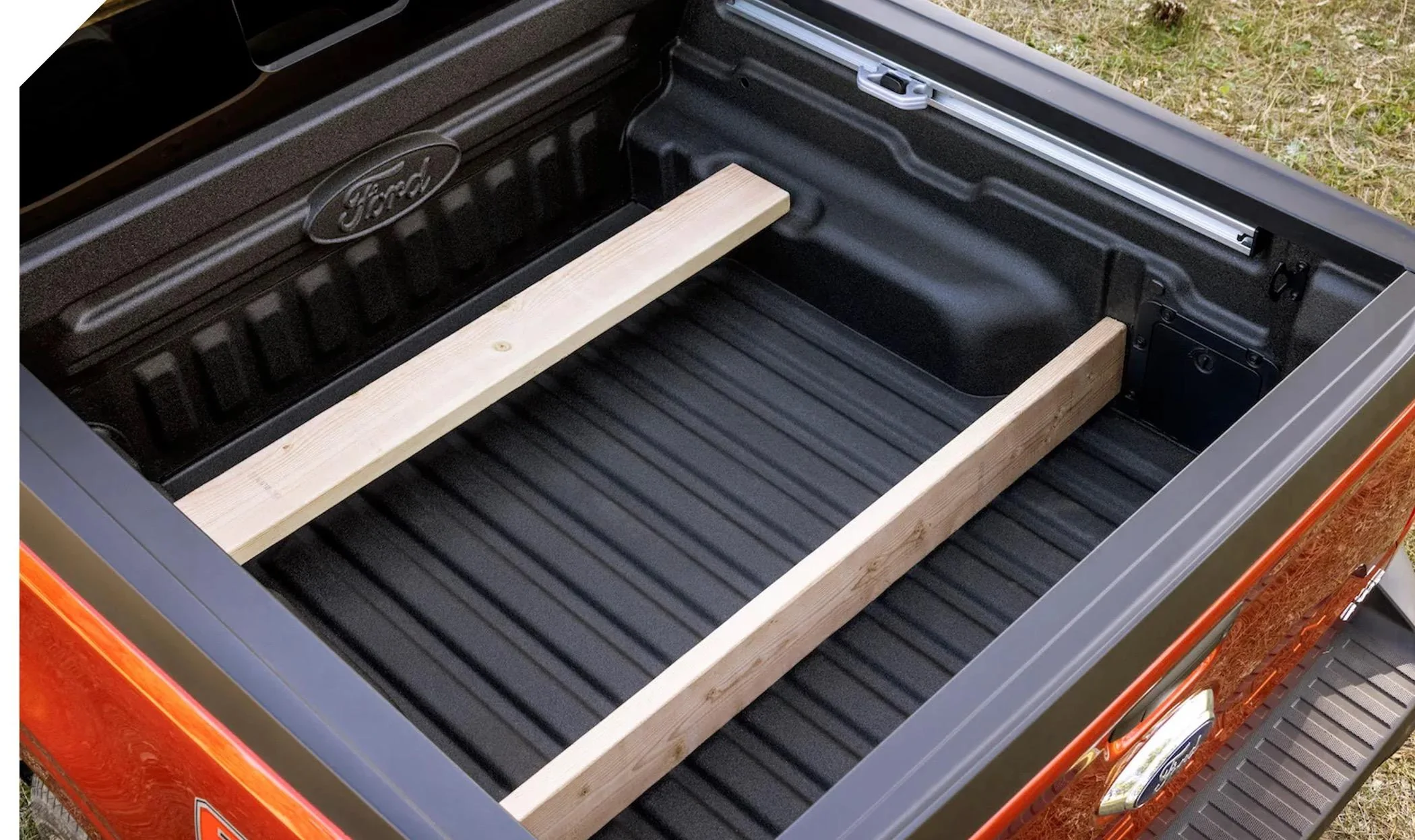

Yes it is.
at 2:00
Thanks for sharing these things. I'm impressed with the features but unimpressed that there's very little info showing off these functions that's easily found.
Ford Maverick Hauling plywood experience tailgate_bed

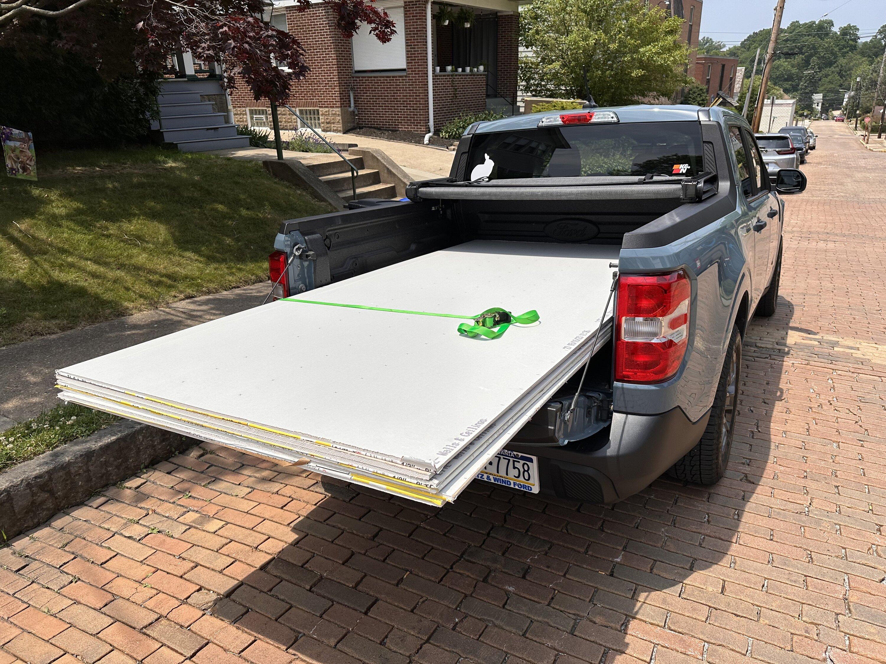

Here is some very specific information on making the lumber supports that are level with the angled tail gate and the wheel wheels;
Near tailgate = 6-5/16” x 54-½” sitting on ½” Tractor Supply mat, ½” 45 degree notches in bottom corners, two hand holds at 16” on center with center line 2” from edge and overall 1-¼” x 3” with ½” roundover
Near cab = 38 degree bevel on ends, 7-¼” x 48-½” long point to long point
Cabot Acrylic Solid Color Stain Black
Ford Maverick Hauling plywood experience IMG_1792
