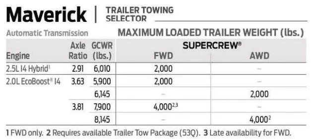

Are these numbers (1500 hauling, 2000 towing) to be used separately? Or can you do both at the same time?

2000 max if towing, 1500 if you're not towing. Anything hauled subtracts from the towing limit.

That’s what I thought, just wanted to confirm. Thanks
You're welcome. I had to double check when I got mine because it seemed like the towing only being 500 more than payload made me think maybe it was additional.

The number you're looking for is the Gross Combined Weight Rating (GCWR) which is the sum of vehicle + payload + towed.
Ford Maverick Hauling & Towing Combined 1651706168736
Source: Maverick towing guide (obviously you can ignore the now defunct info on FWD w/ tow package)
