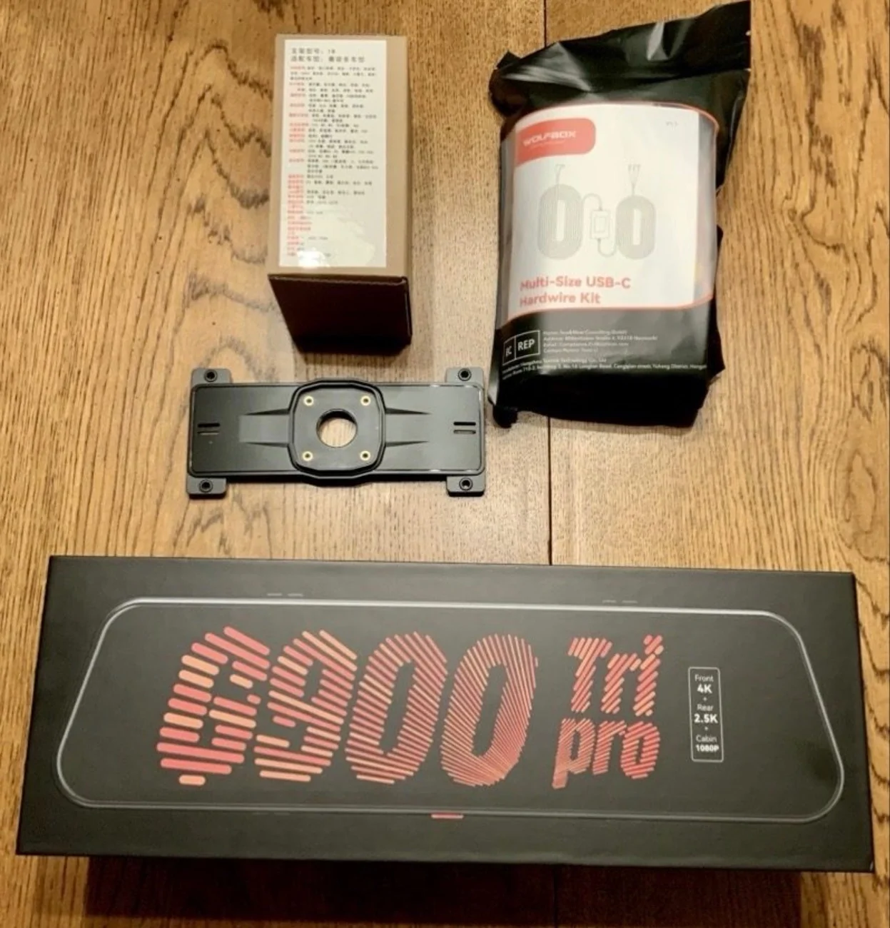

I looked at that and don’t get it. Does it attach to the stock mirror? Are the cables hanging all over?

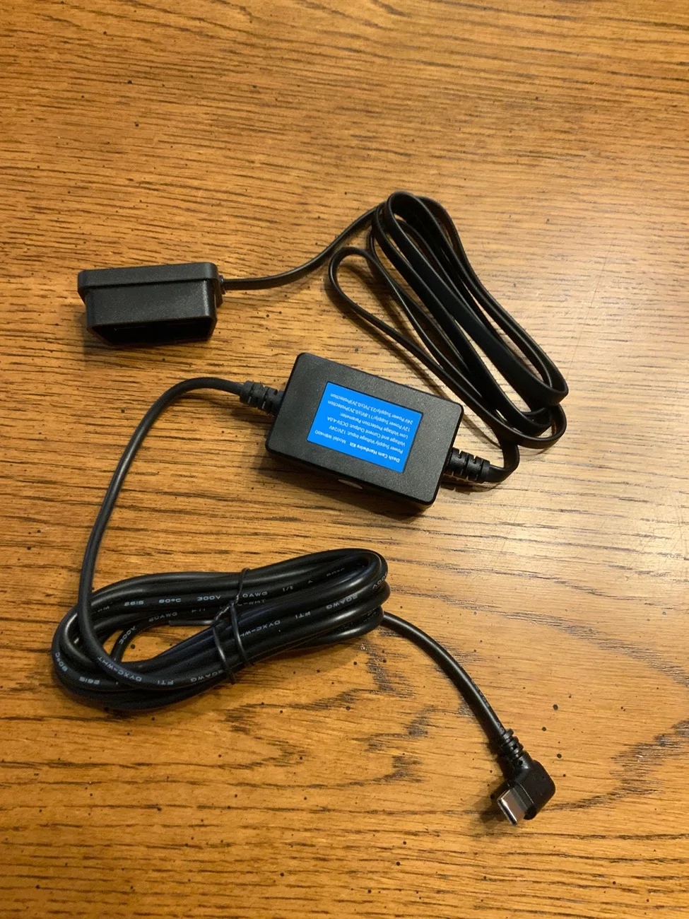

I removed the OEM installed rearview mirror and installed the WolfBox Dash Cam in its place verses using the enclosed straps and ran all the wiring behind the headliner and trim it’s a very clean installation no wires exposed - I grabbed the power for the main unit using the OBD II port (more photos available if you search WolfBox Dash Cam)

I like this one. See any issues?
WOLFBOX G900Pro 12MP WiFi Touch Screen Rear View Mirror Dash Cam Smart Mirror with Exclusive 30-Month Warranty
no issues with mine and the installation was fairly painless I think the brand is a good one

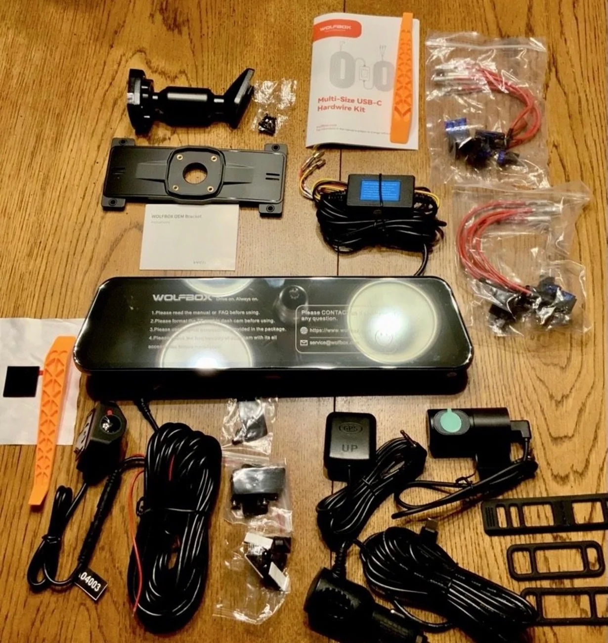

Thats a lot of wires.....wowza
I didn’t need most of the wires there are a number of ways to install it since I used the OBD Port II I didn’t need the fuse taps and wiring associated with that
