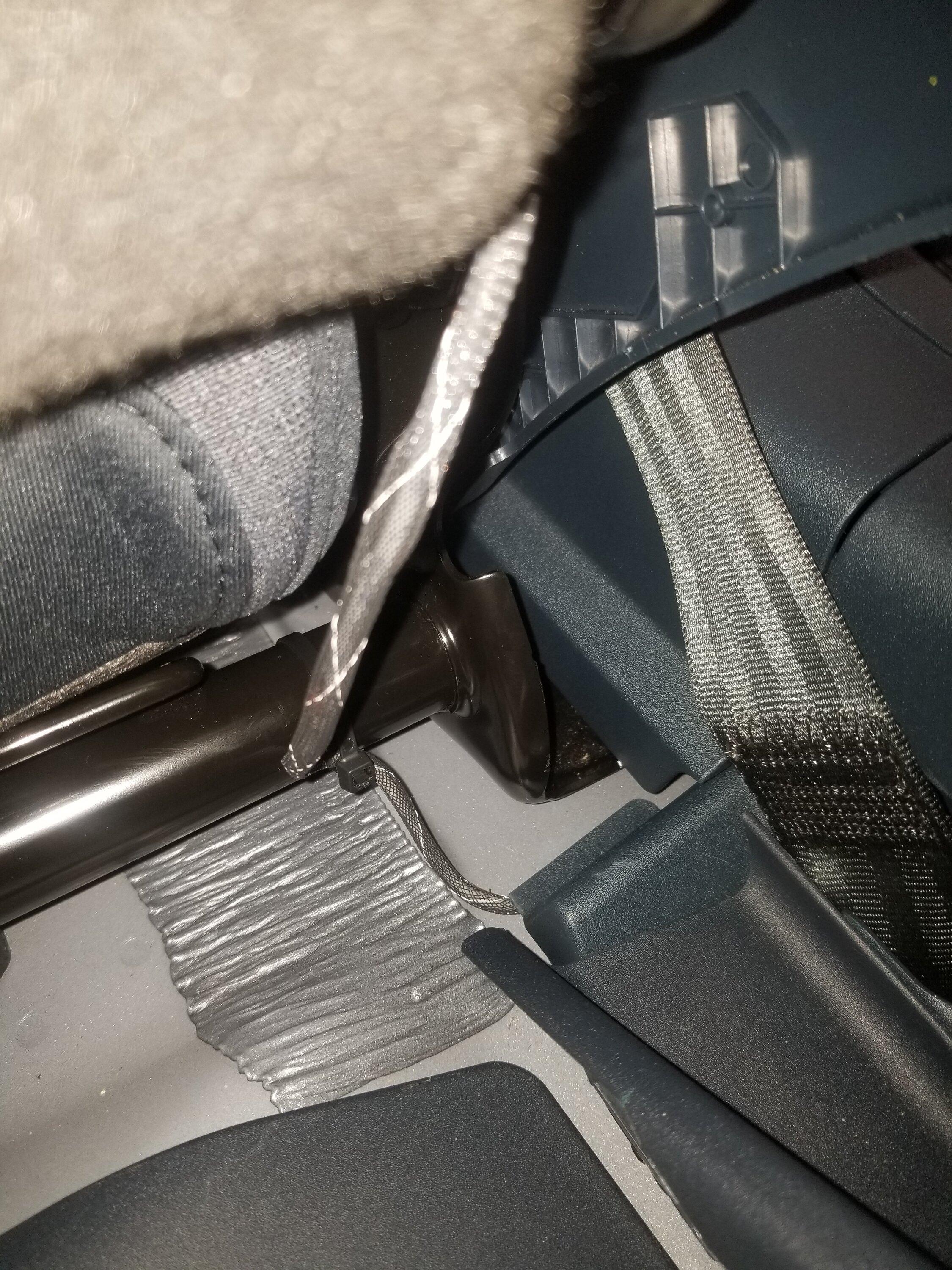

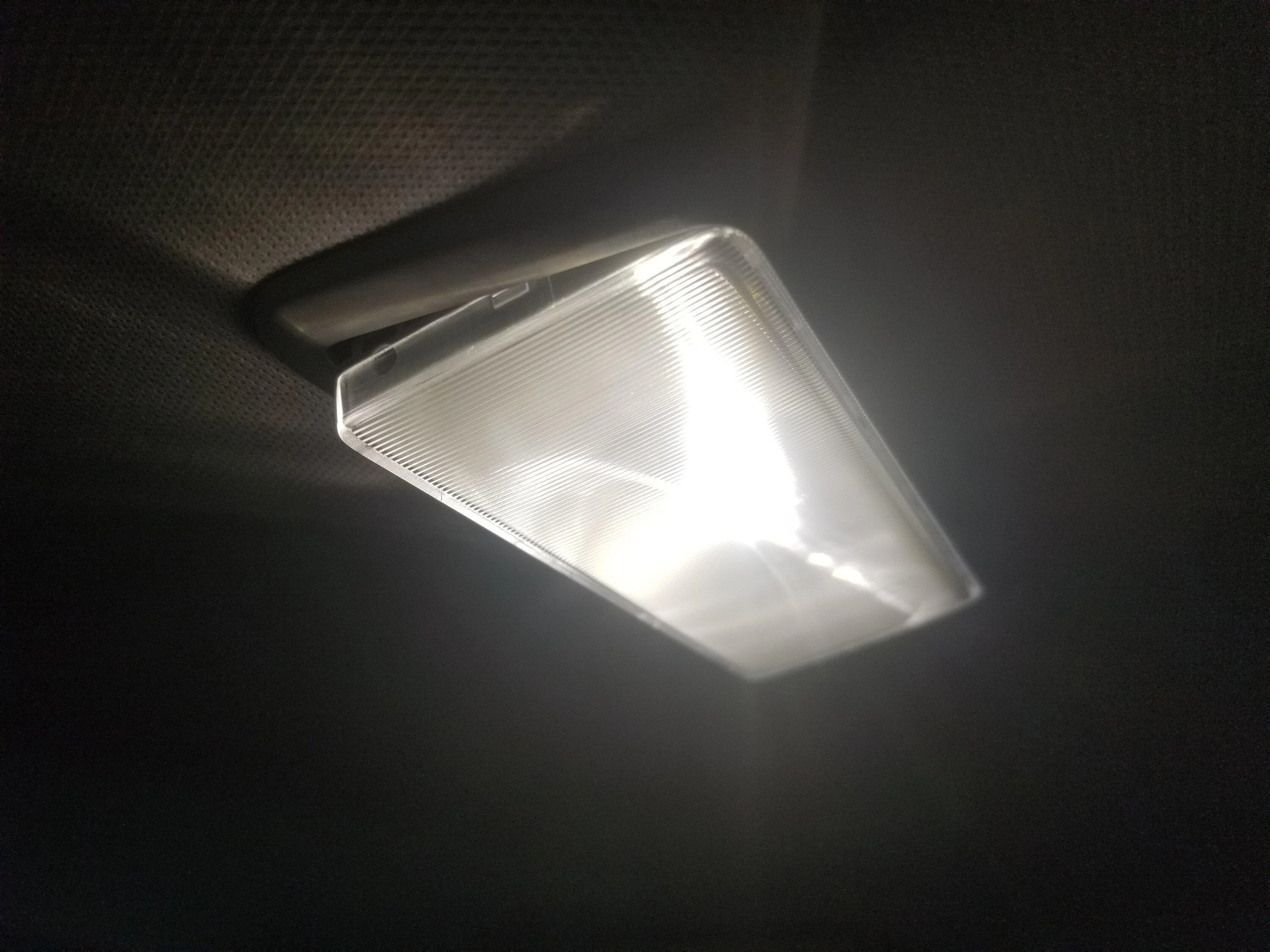

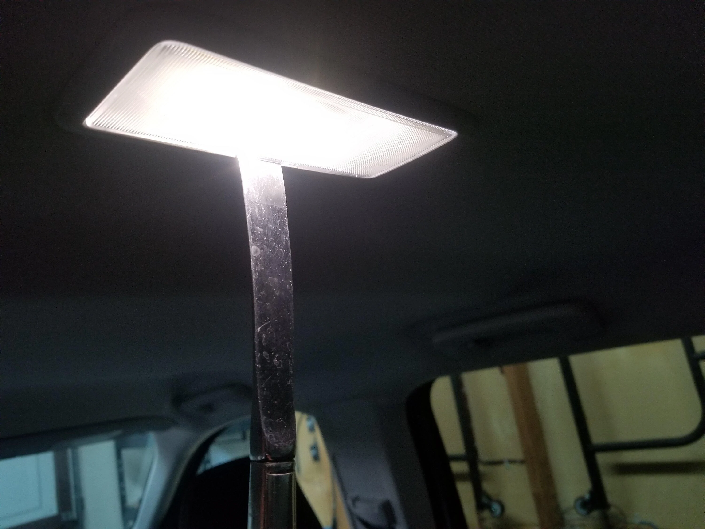

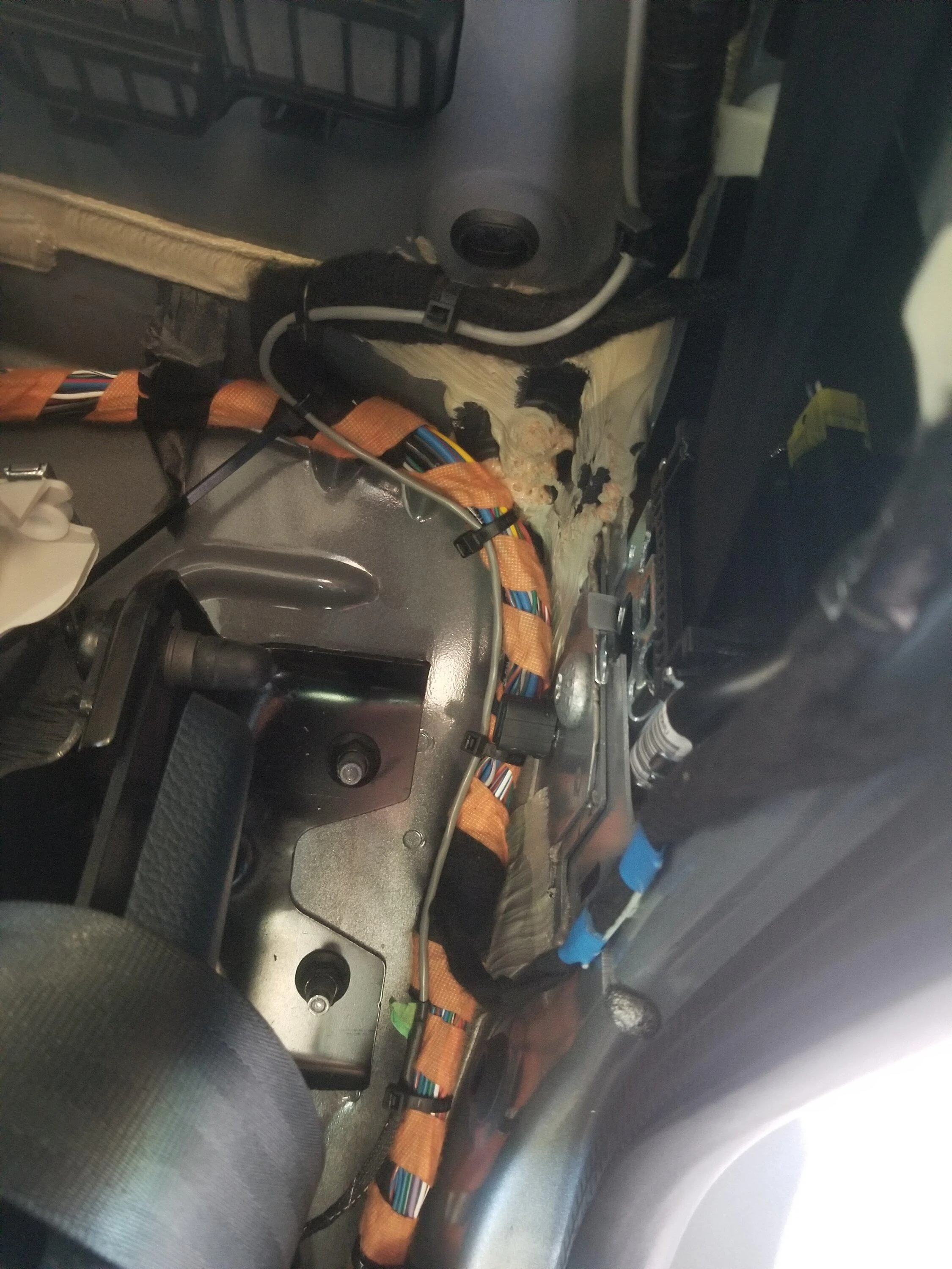

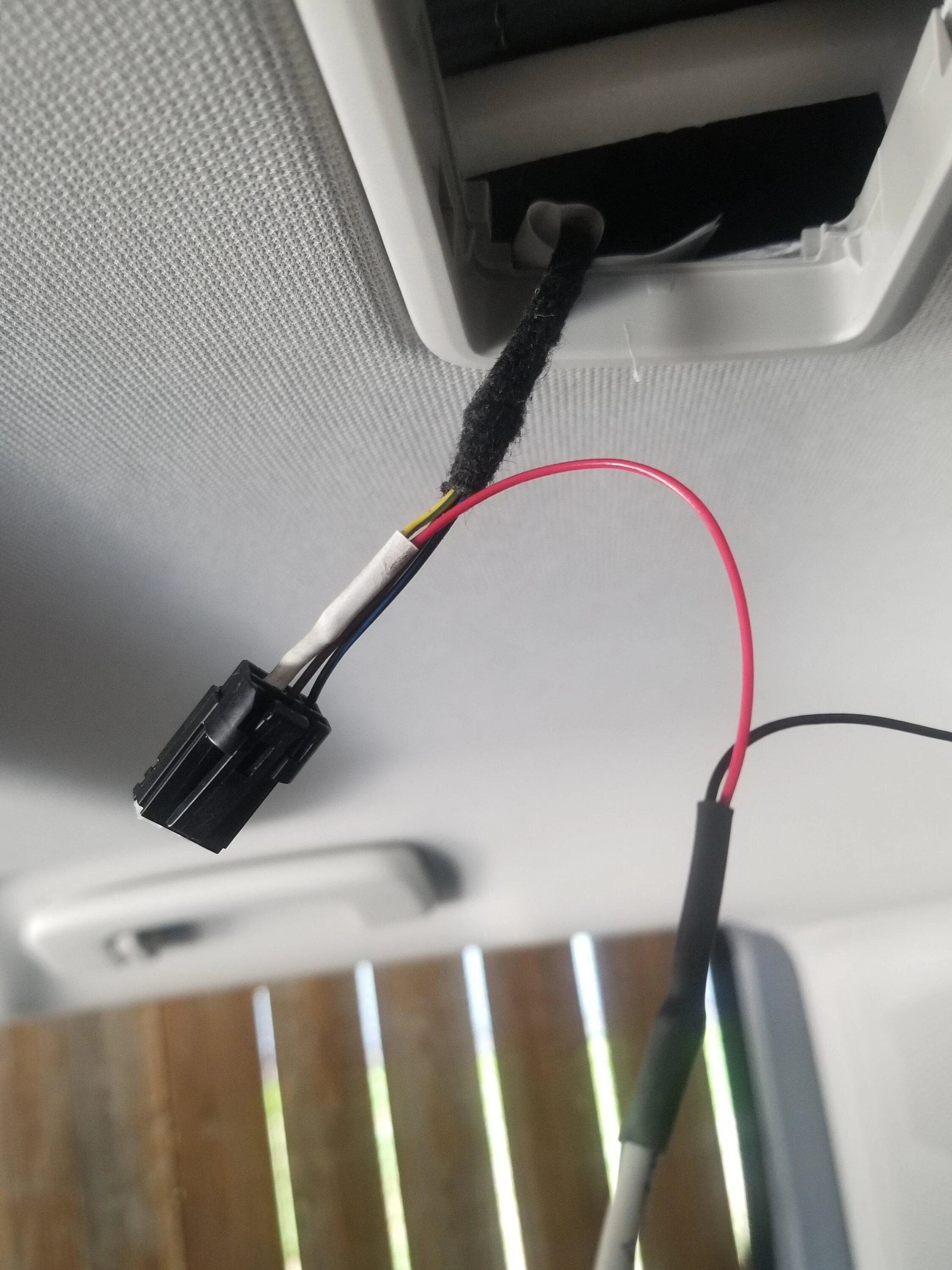

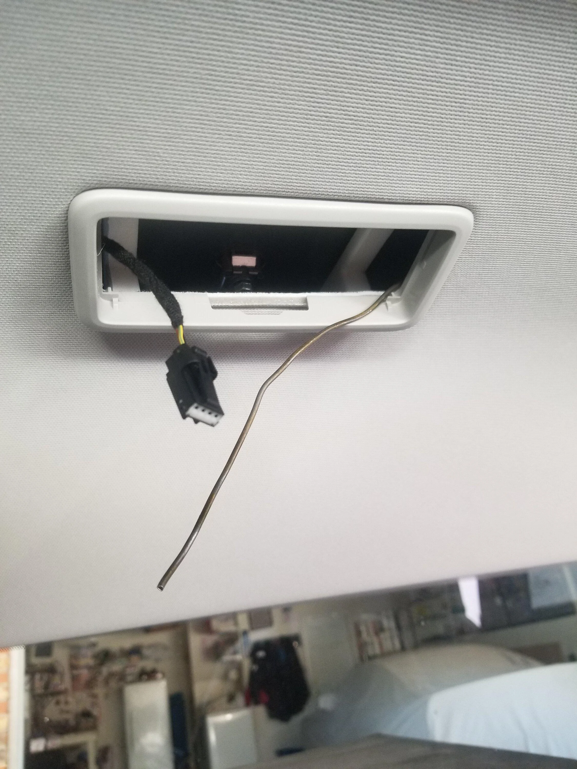

Hurt myself? Seriously, what am I gonna hurt myself on? Straightened out coat hanger with U shaped hook on the end, never pulled the headliner. Figured out how to pop the light out. Used a butter knife to pop it. Fished the coat hanger from the dome light hole to the C pillar. Taped my wire to it, and pulled it through. Only removed L/H C pillar plastics.

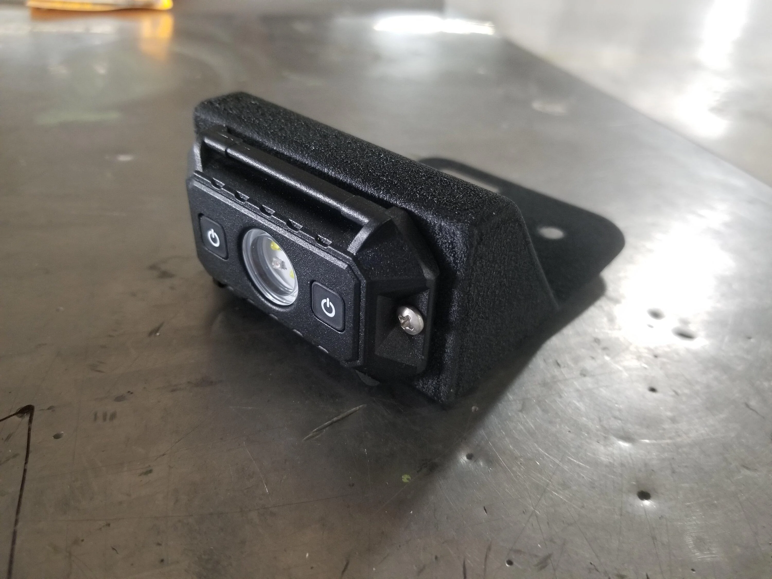

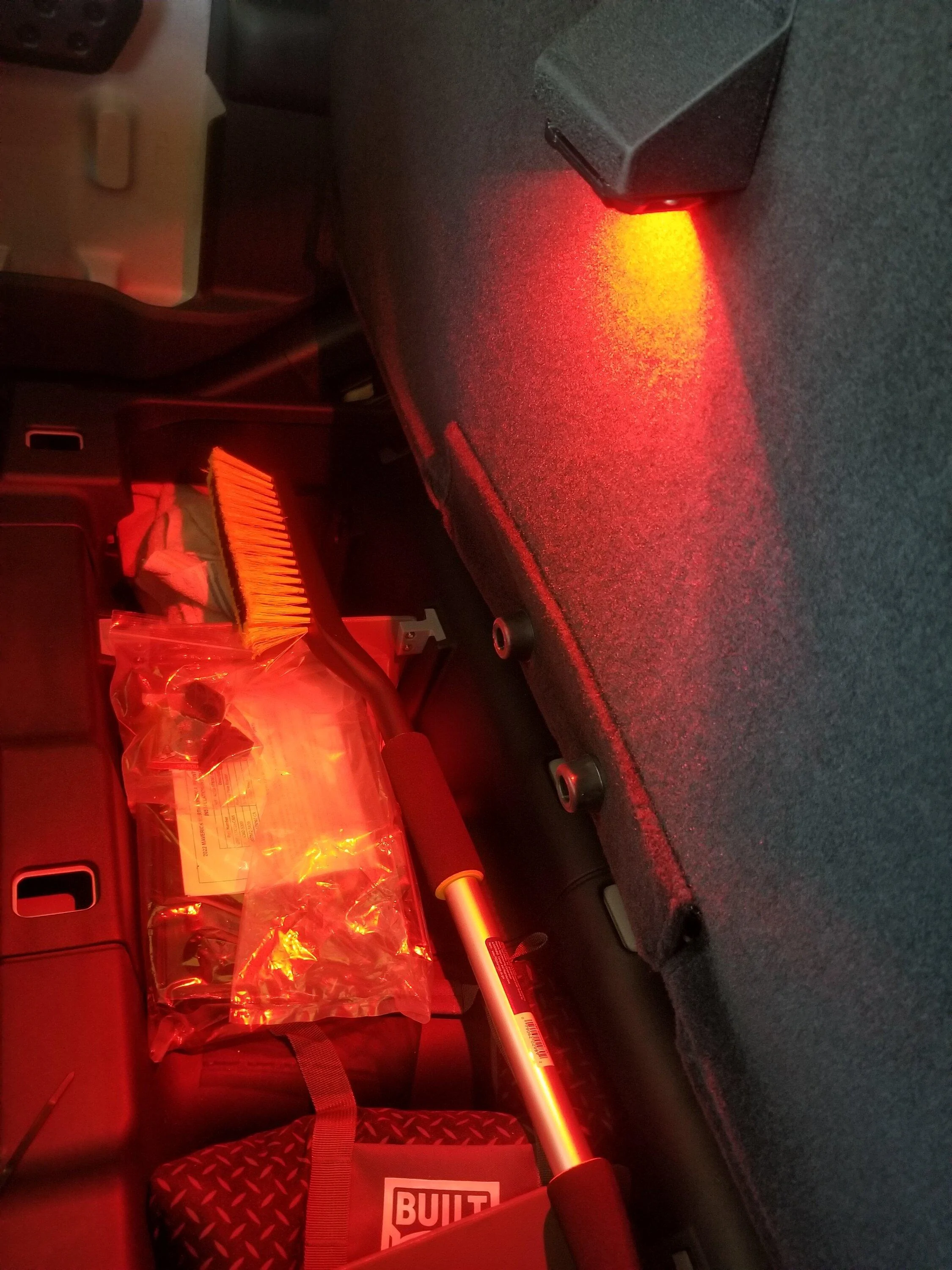

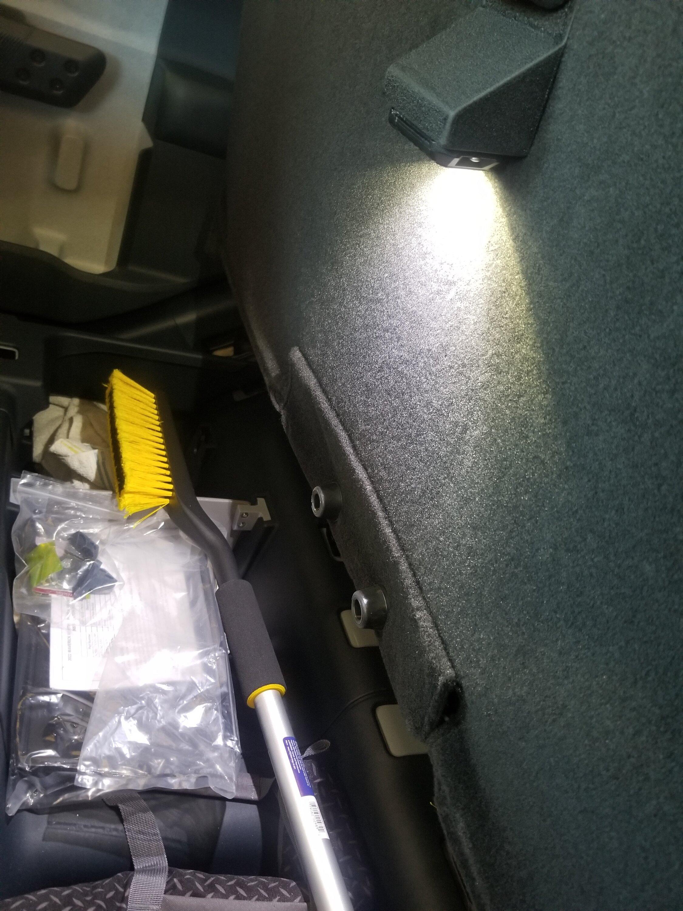

Out of curiosity, why did you want to run a wire from the C Pillar to the rear dome?

Homemade under seat cargo light housing, with high bright LED light for a side by side buggy. Dome light hot times out after 15 minutes, and I added a mercury switch to also shut it off when I lower the seat.

Great idea!

Thanks!! I was thinking that something like a car trunk light would be ideal.
