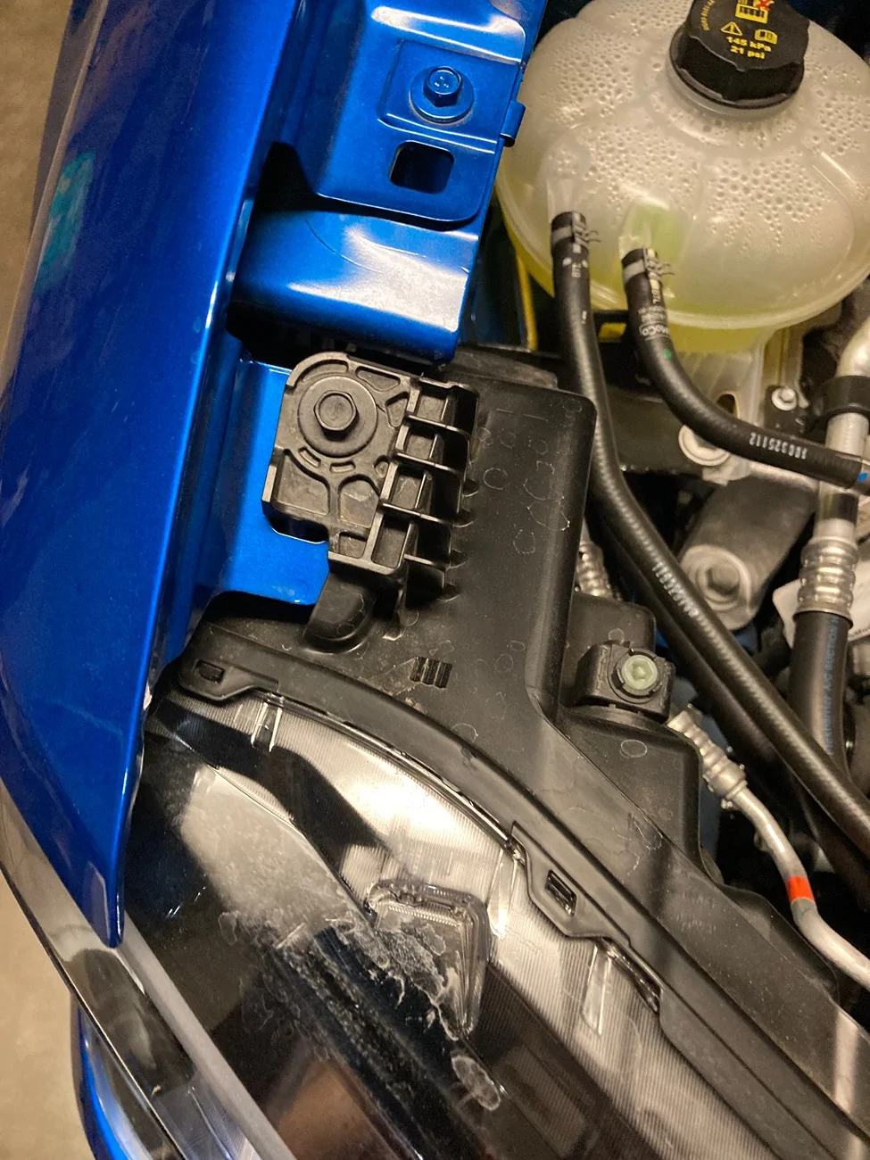

The passenger side headlight needs to sit 2 mm further inside. The driver side is sitting correctly.
Taking to the dealer does not seem to be an option. I think I will have to take off the bumper and
even then don't know if its adjustable. Is it worth the trouble?
That gap would bug me enough to fiddle with it - although that whole headlamp assembly would cost $1000+ so I would be careful fiddling.
Seems the headlamp unit needs to be shifted down & over a bit. It didn’t shift when you installed the aftermarket bulb?
Anyway, the only bolt I would loosen is the one on top (see below) to see if there is any adjustability before retightening.
If not, the idea of a bit of clear drying window seal/caulk is something I would try to waterproof that gap. Good luck.

Installing aftermarket bulbs takes 30 seconds each side. It is right there once you open the hood.
To get to the headlights, the bumper (grill is attached to the bumper) need to be taken off.
Maybe, I will do it in Oct when it gets cooler. Not a big deal. If I do, will post pics.

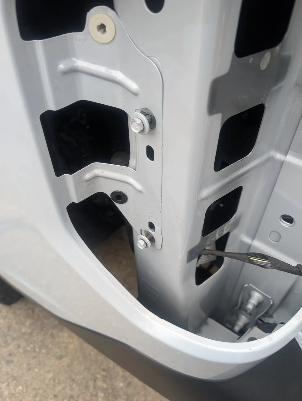

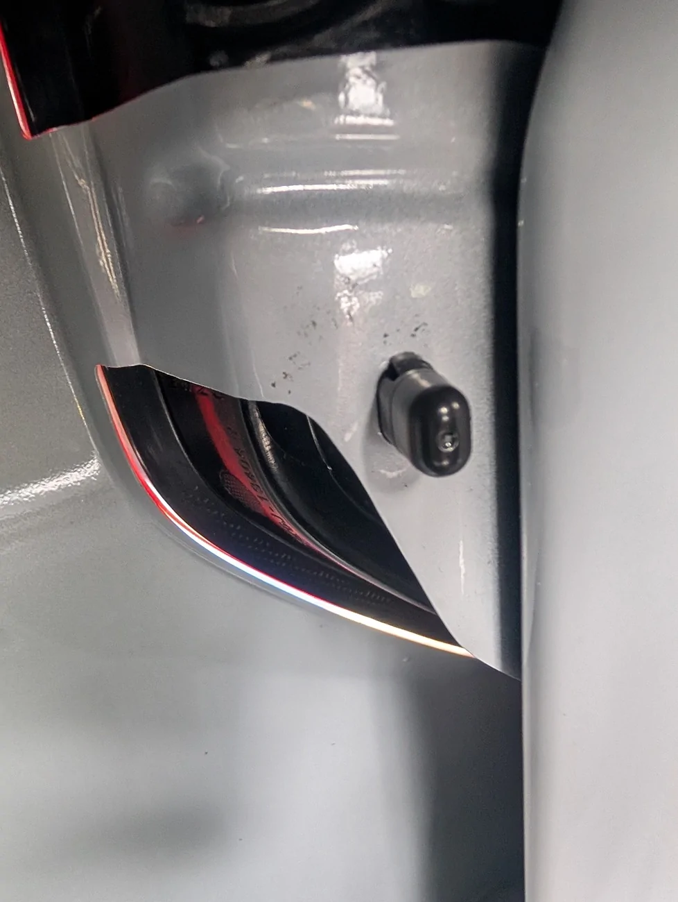

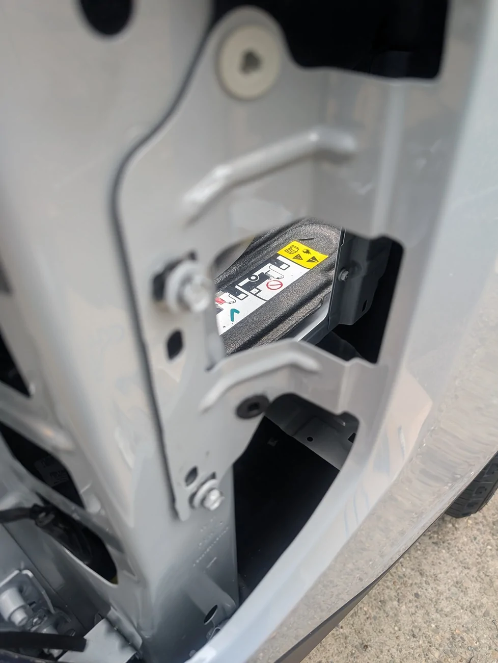

As for the back lights, there was no gap but it was popping and I fixed it for good.

Took the pics but never posted. Here are the pictures showing what causes the back light to pop up. You need to adjust the frame bar or whatever its is called. It happened when I was putting a contraption in my truck bed.
