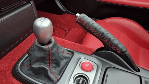

My s2000 has a manual hand brake you have to release (old style).

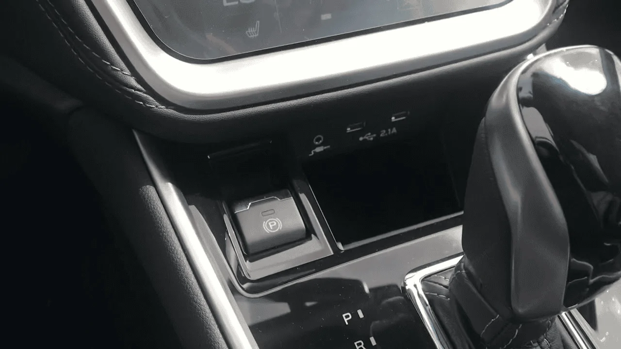

My wife's Subaru legacy you HAVE to press a switch same as the Maverick to release the electronic parking or else it won't move.
