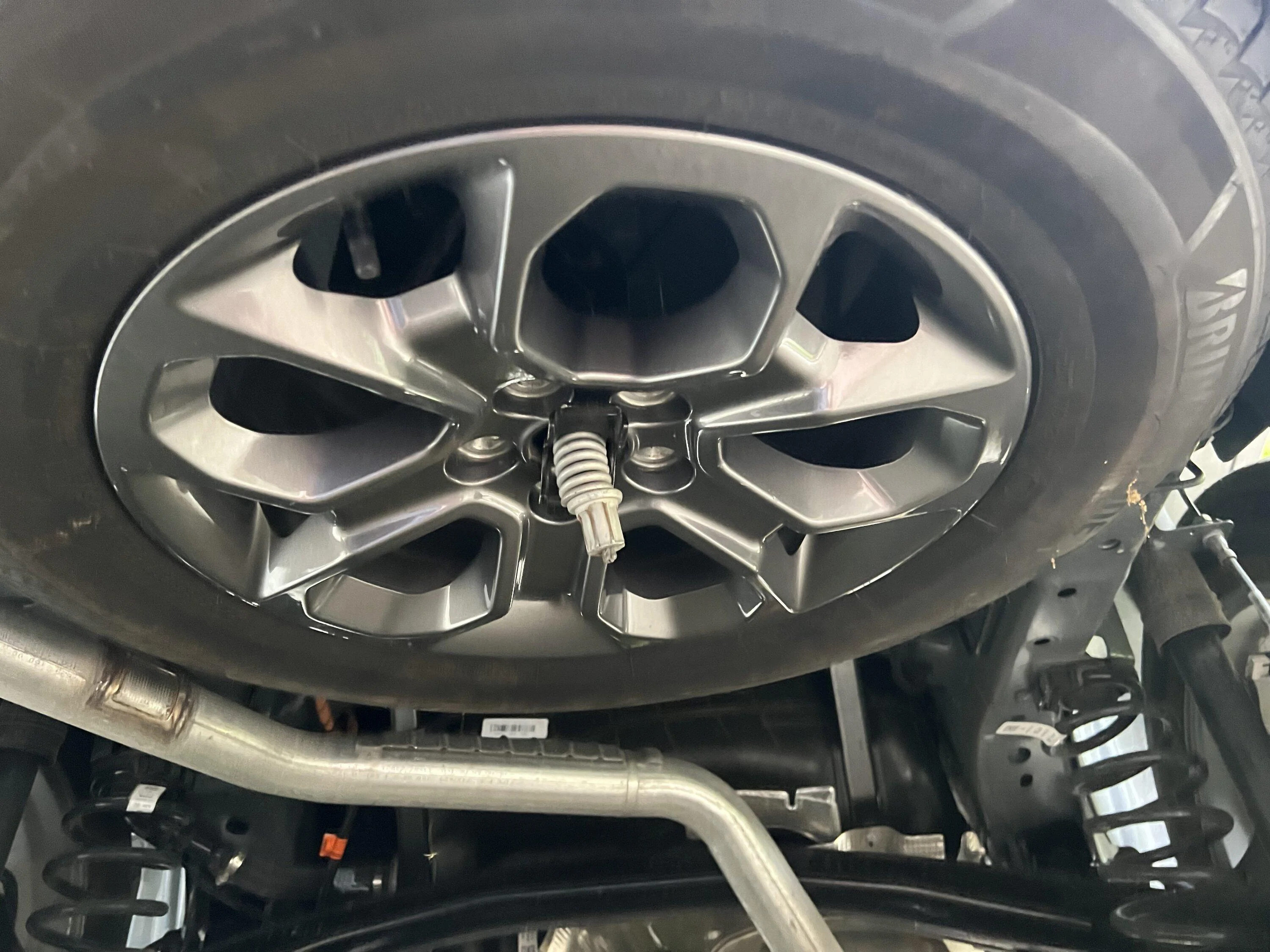

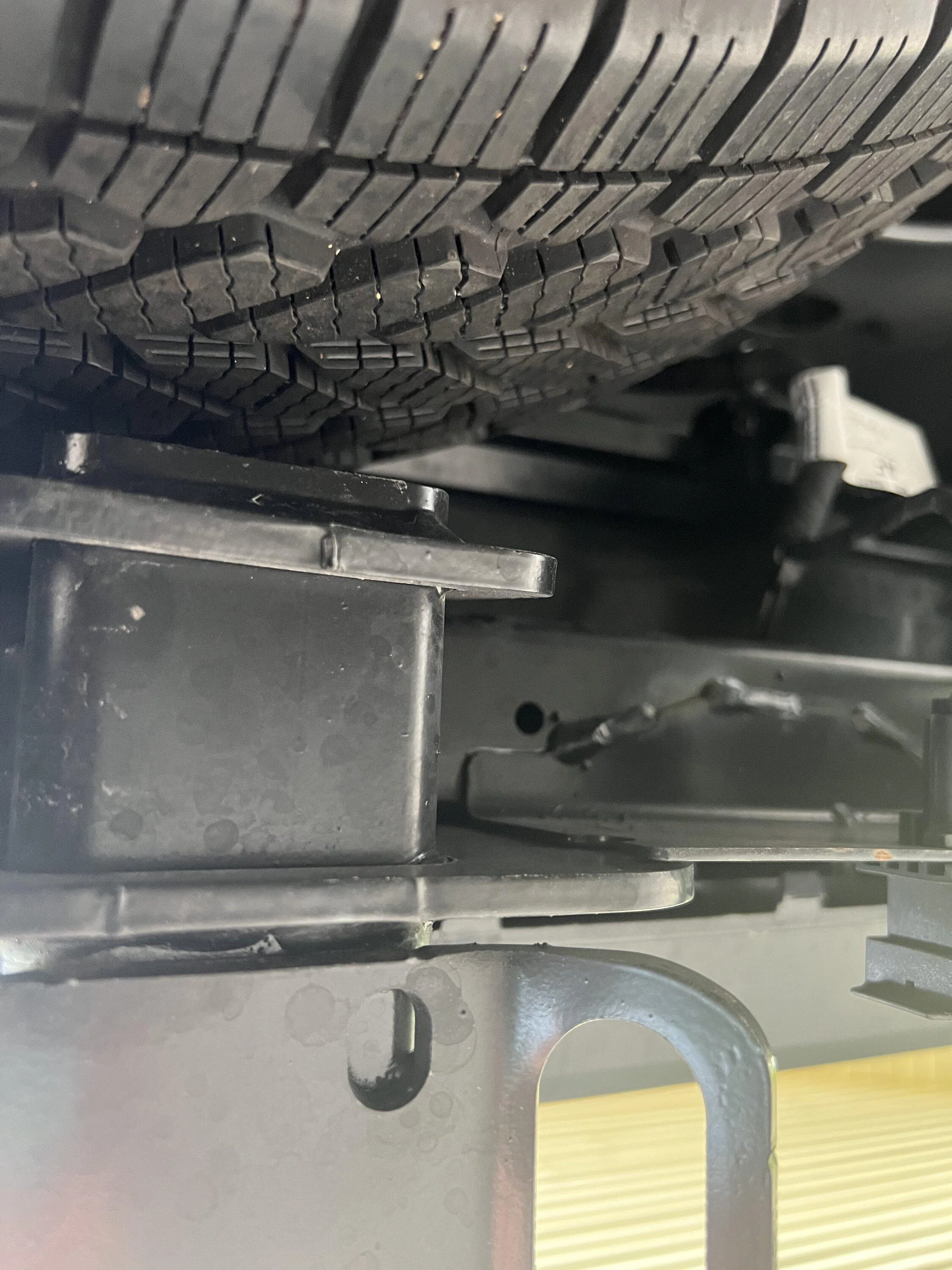

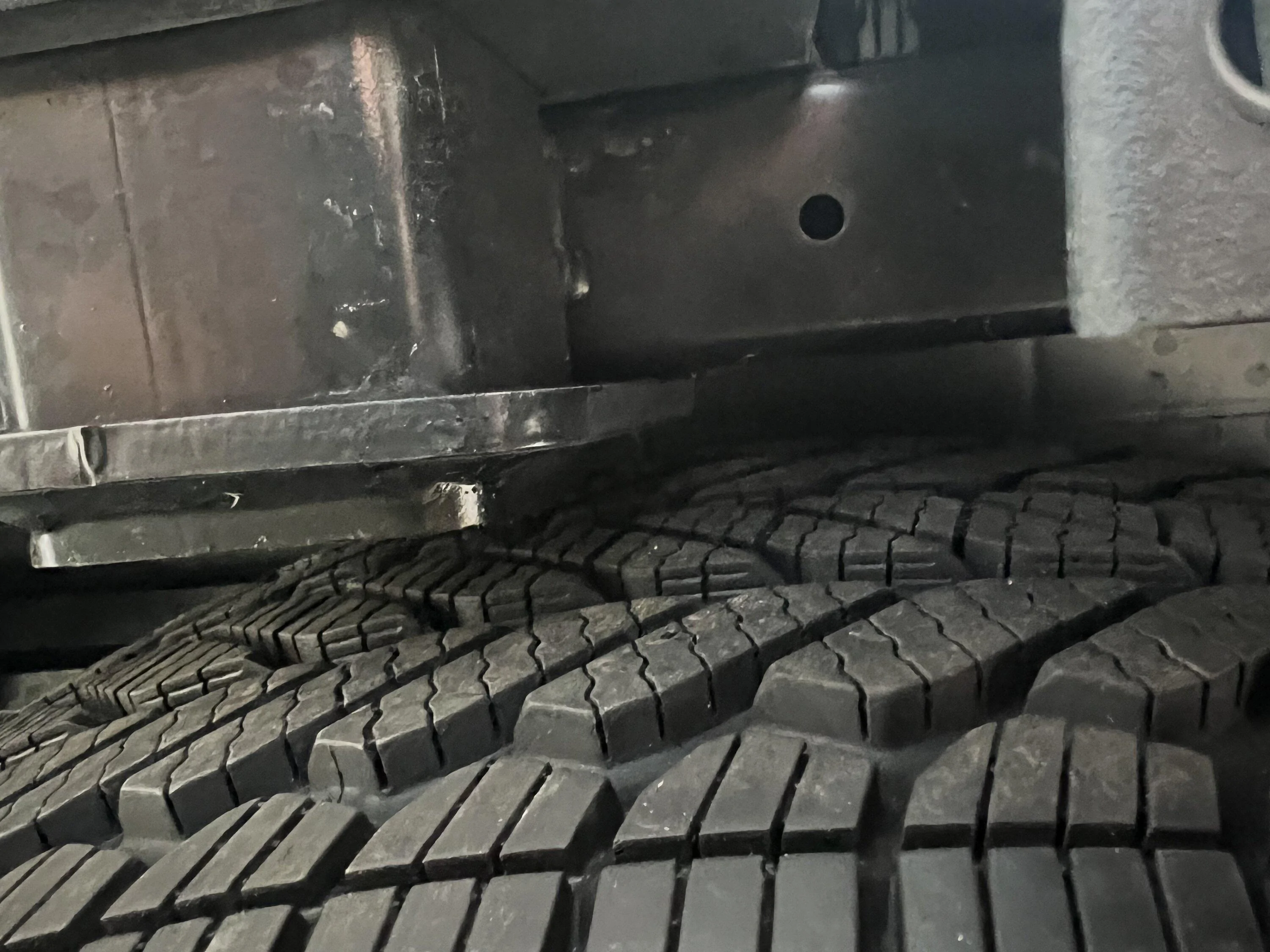

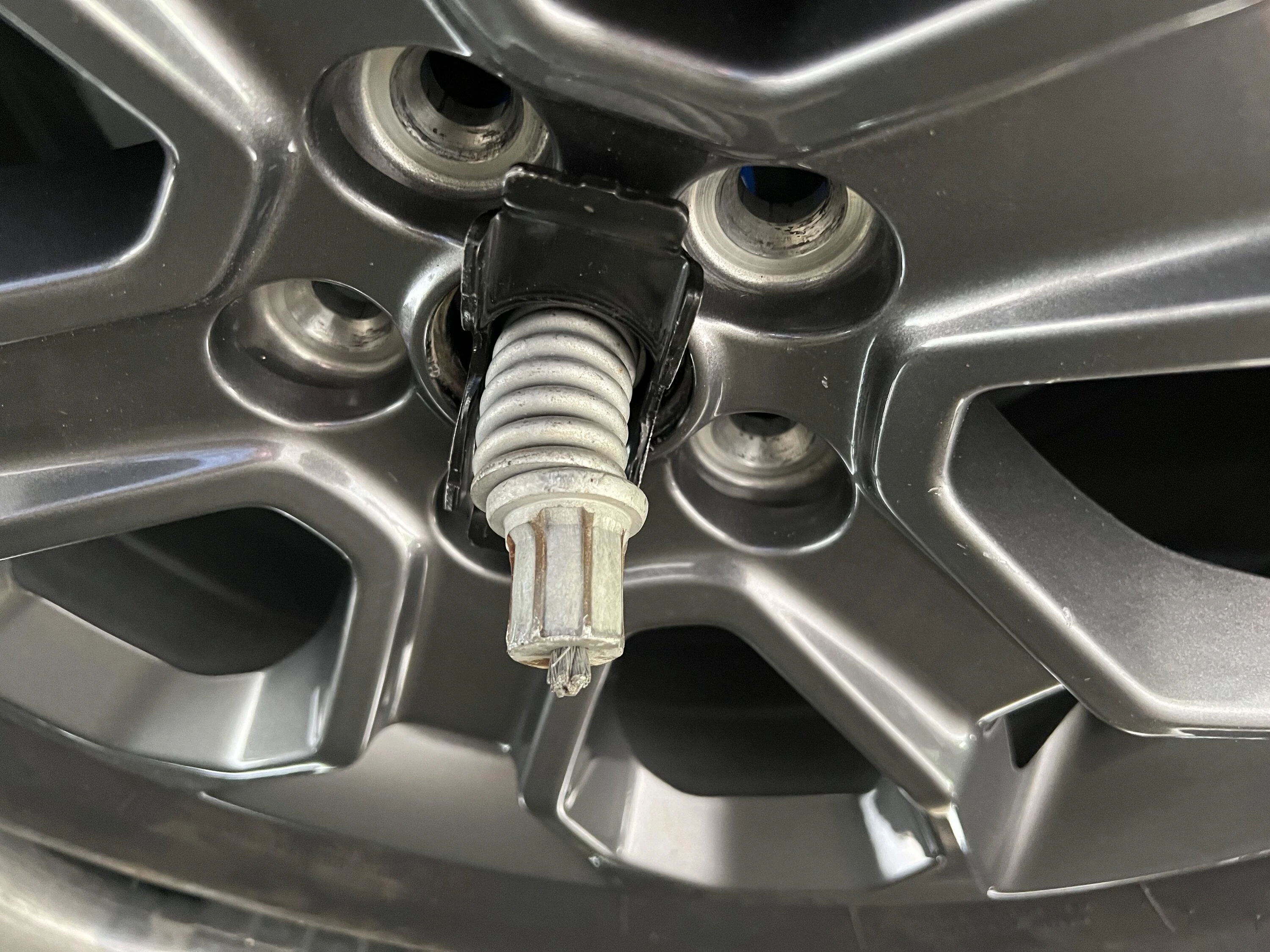

Concern that with front wheel drive I wanted to ensure I had a matching tire. Plastic adapter not applicable to this installation so removed. Otherwise snug and seems to fit. Center hole diameter makes threading the bracket through a little trickier.

I think it is good (photo attached). One reason I posted this was in case I did something dumb that could cause the vehicle to explode, etc…. Hoping someone will save me if so. Seems like it fits well to me but could benefit from the securing bracket being optimized for this type of rim. Perhaps a powder-coated washer/plate with a slot in middle to distribute bracket fore across the center of rim?
