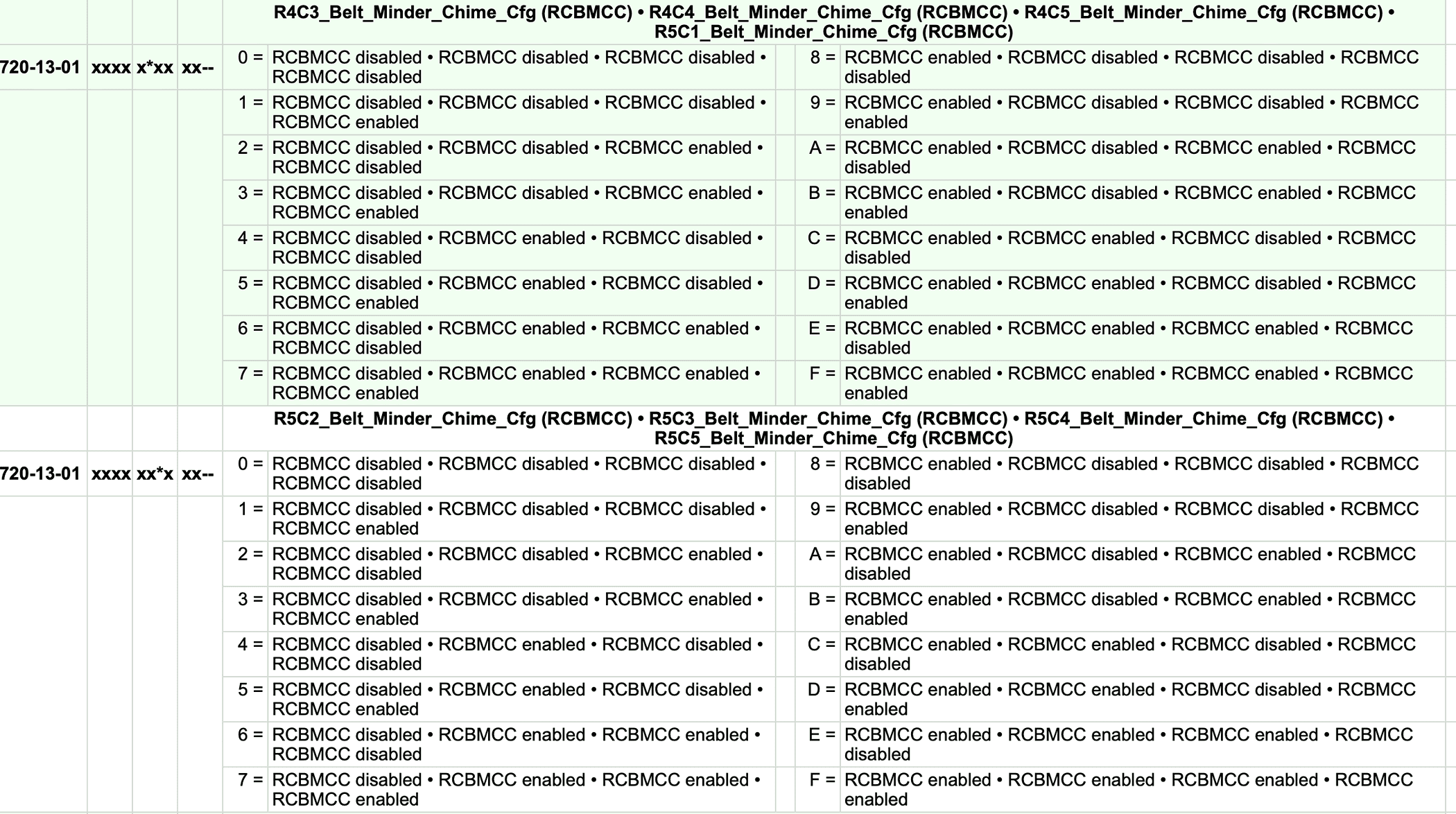

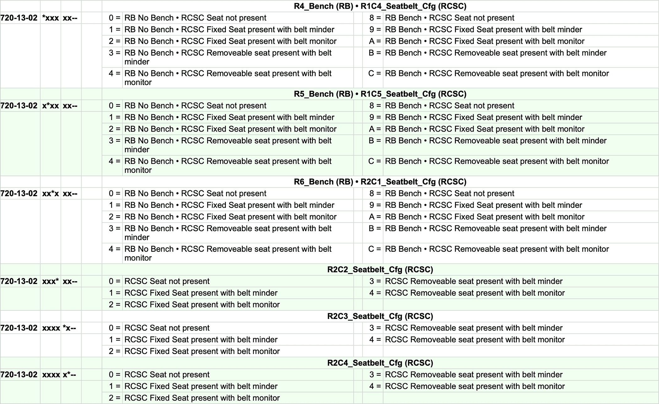

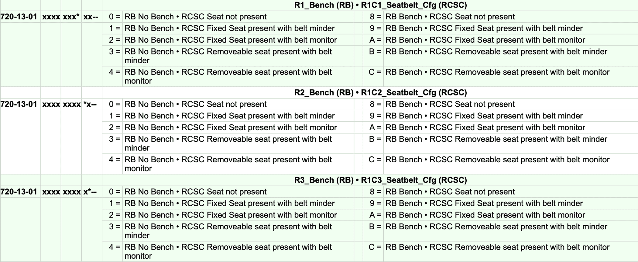

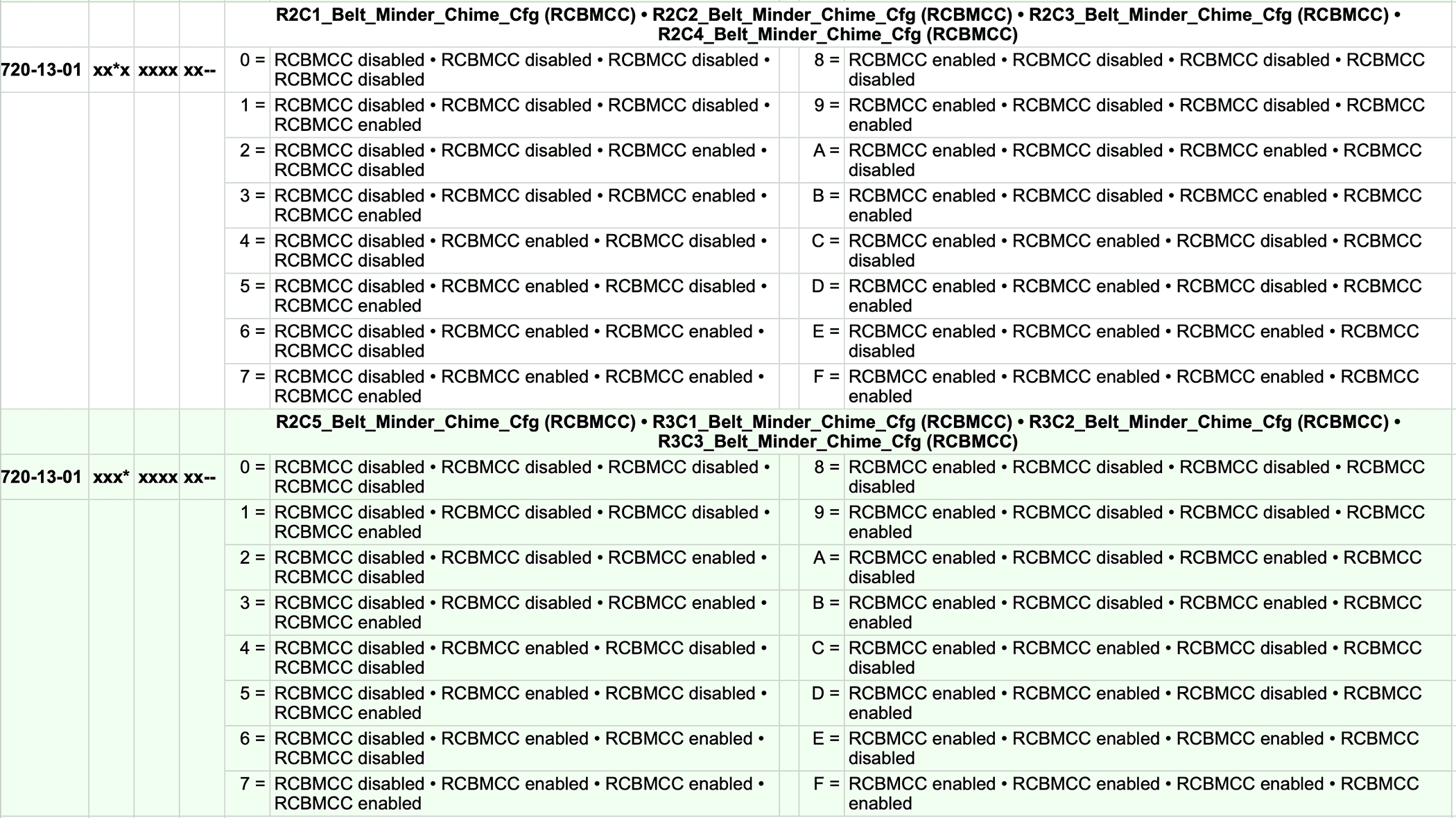

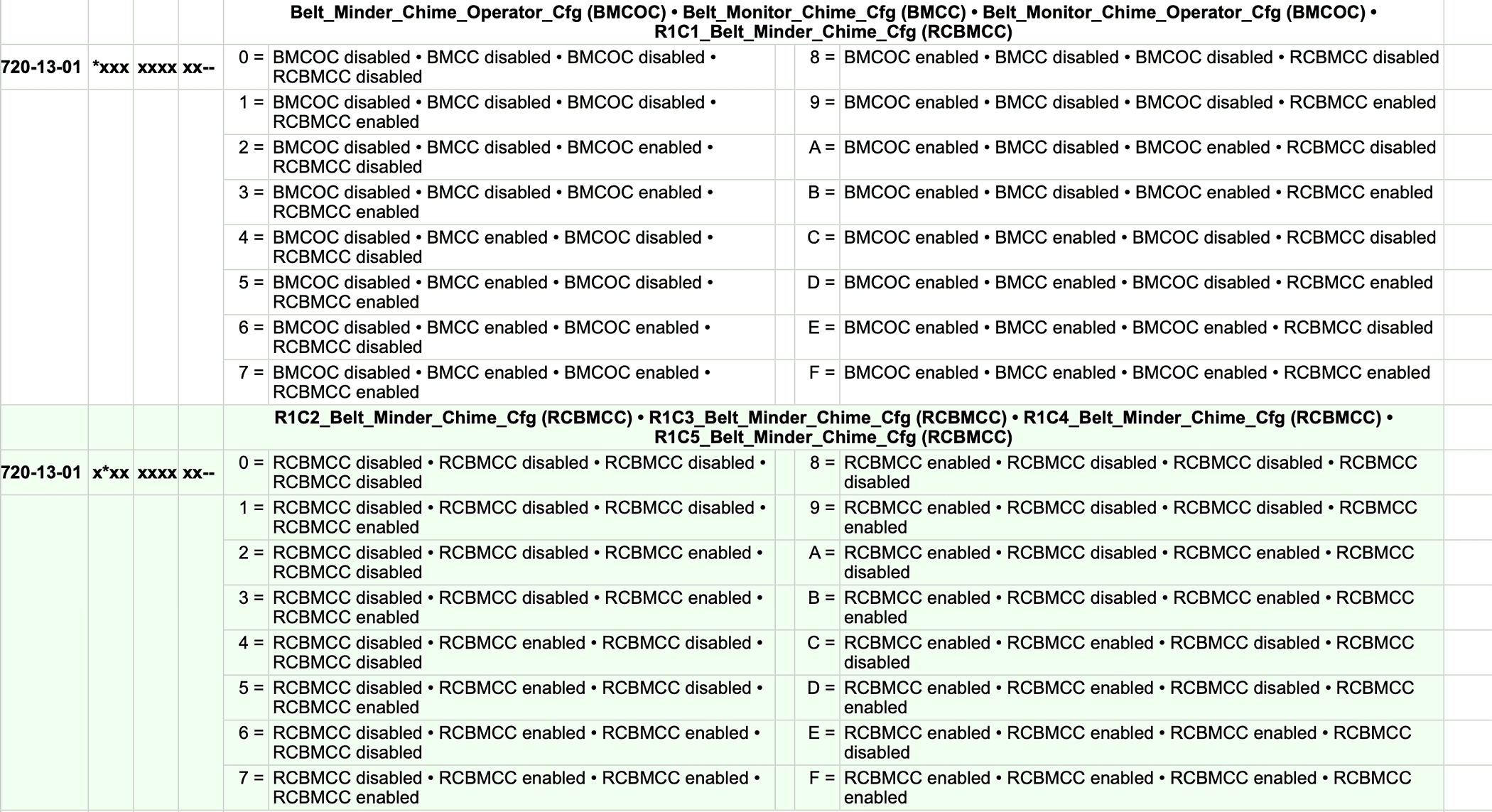

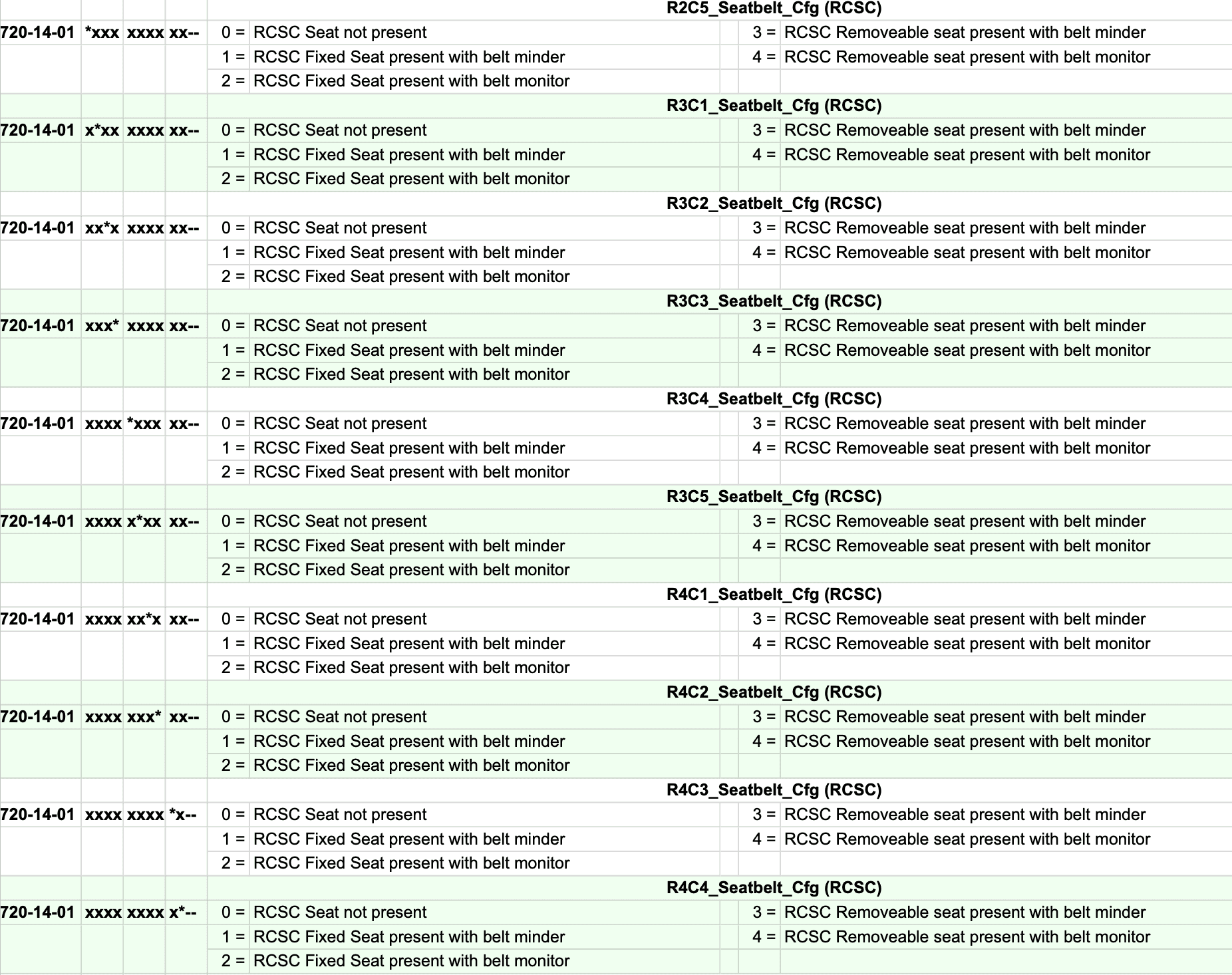

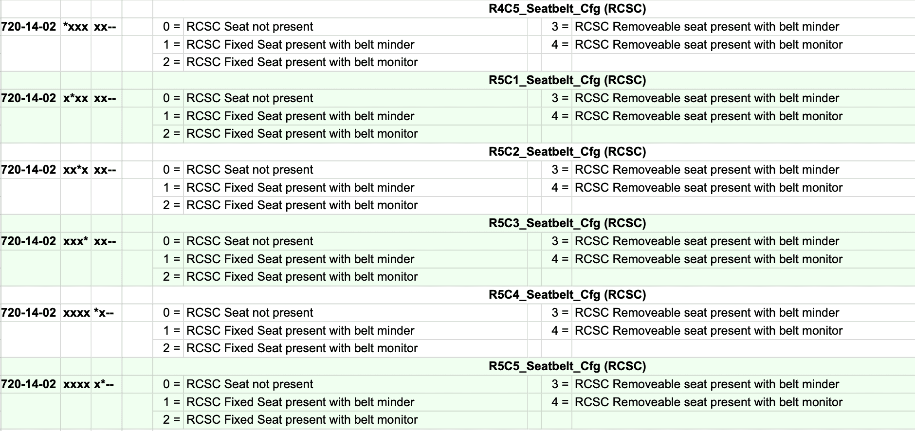

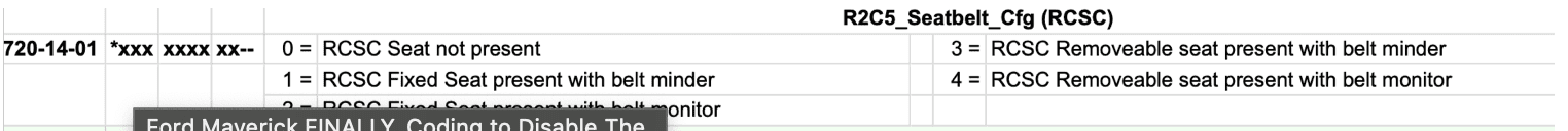

If you would like to keep the Minder (the dash light and chime) and not the Monitor (the seatbelt screen) I would suggest doing the following coding based on this diagram and my original coding in my Maverick.
720-13-01 9100 0001 8000
720-13-02 0110 1000
720-14-01 1000 0000 0000
720-14-02 All Zeros
Ford Maverick FINALLY, FORScan coding to disable the Seatbelt Information Screen! (CONFIRMED WORKING) Screenshot 2024-03-21 at 12.48.06 PM

Good to know. On my maverick 720-14-02 was already all ZEROs from the factory but I did not know if this was the case for ALL Mavericks. My 720-14-01 was all Zeros except the first digit which was originally a 2. Which according to the coding in the spreadsheet has to do with the seatbelt monitor.

I tried just doing the 720-13-01 and 02 to zeros, but it didn't kill the pop-up. When I did 720-14-01 and 02 it worked! Shout out to @EONR24 for this fix! I have a '23 EB Lariat Lux FX4 4K.
