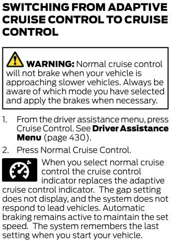

Sorry, I was not clear. This is what I meant by turning off the Adaptive feature.
To turn off the gap settings on a 2025 Ford Maverick's adaptive cruise control, you would typically use the up and down arrows on the steering wheel cruise control switch, repeatedly pressing the button until the gap setting reaches "0" or is completely deactivated, effectively turning off the adaptive distance feature and reverting to a standard cruise control mode; consult your vehicle's manual for specific instructions.

There's a section on my Escape's center screen to select ACC or Normal Cruise Control under Driver Assistance.
When set to normal cruise control and turn on CC with steering wheel button it chimes and pops up a warning on the IPC that it's only normal crusie control mode and I'd have to press OK.
25 manal has the section, don't know if the truck has it or not.
