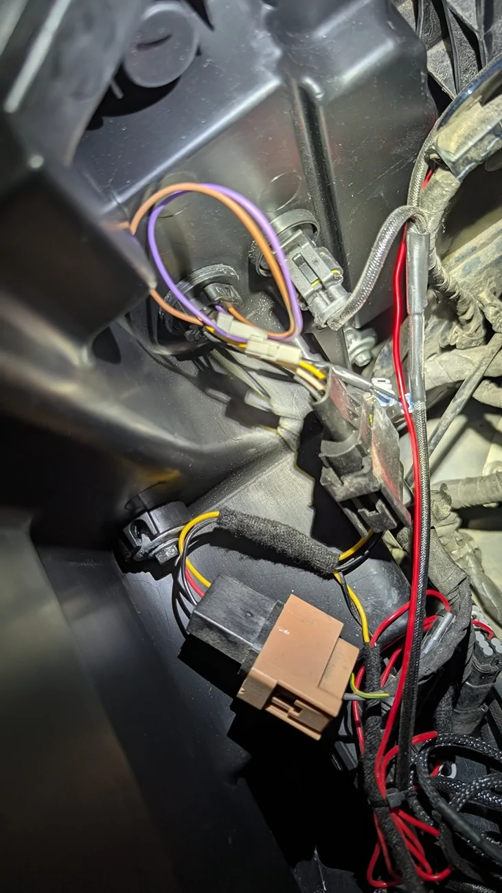

I would definitely cover those wires with some tessa tape.

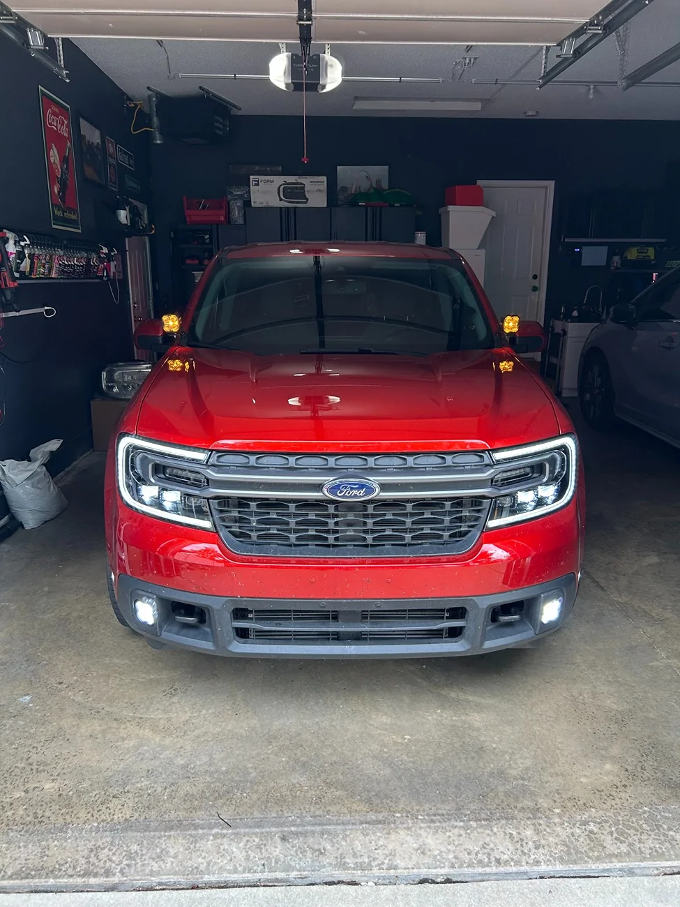

Eh, anyone can draw their own conclusion. So far I've only seen a few people having issues. As is typical with any product. At least buying from Form/Diode gets you solid customer service and a 2 year warranty. Since I've gotten my replacement passenger side lamp I've been just fine. I only had to do minor beam adjustments.
