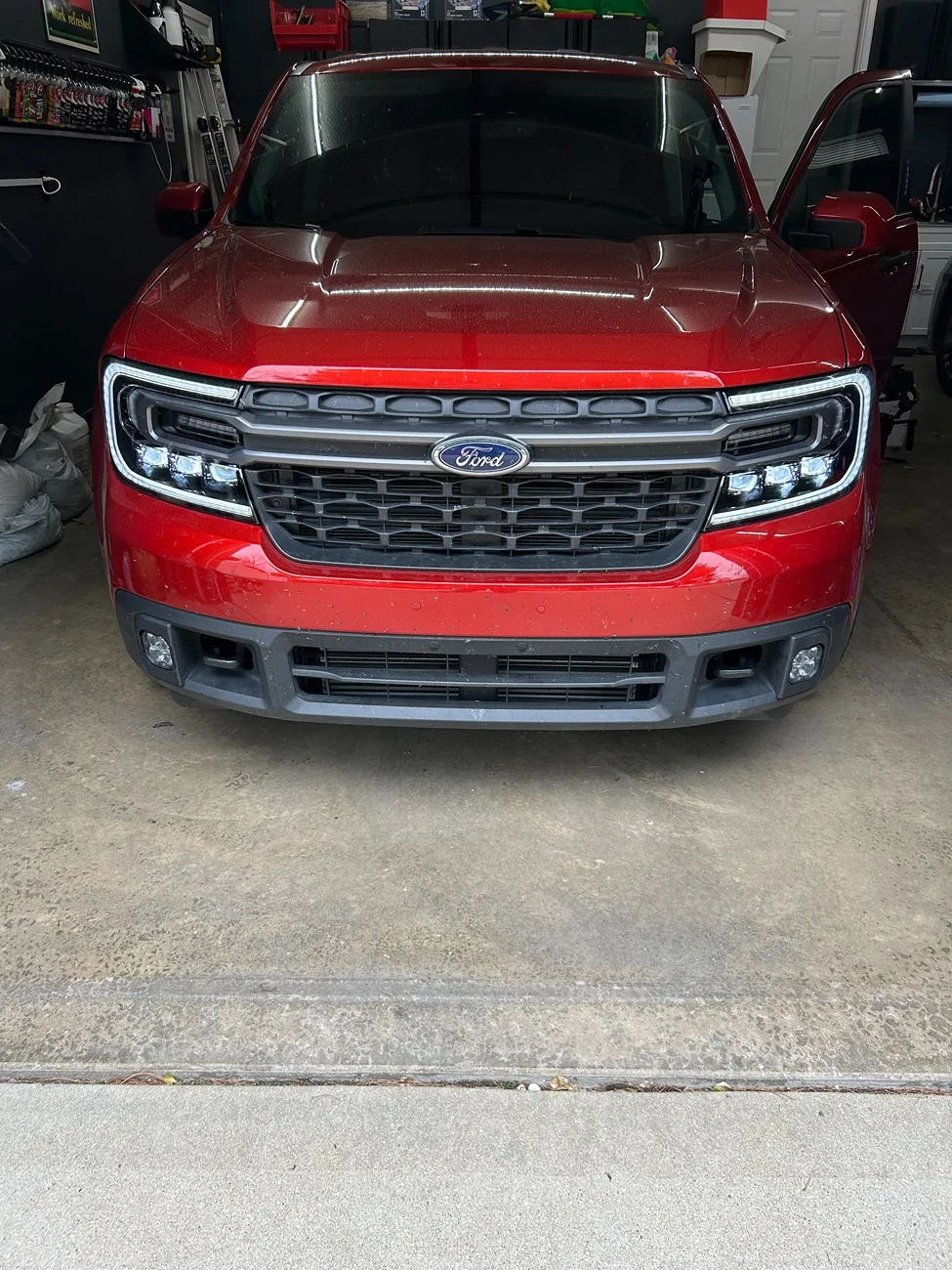

I don't think it is but I've had my bumper cover off at least 10 times. The bumper cover is the hardest part, after that it's just 3 bolts for each light.
I installed the eBay headlights a few weeks ago and it took maybe 2 hours.

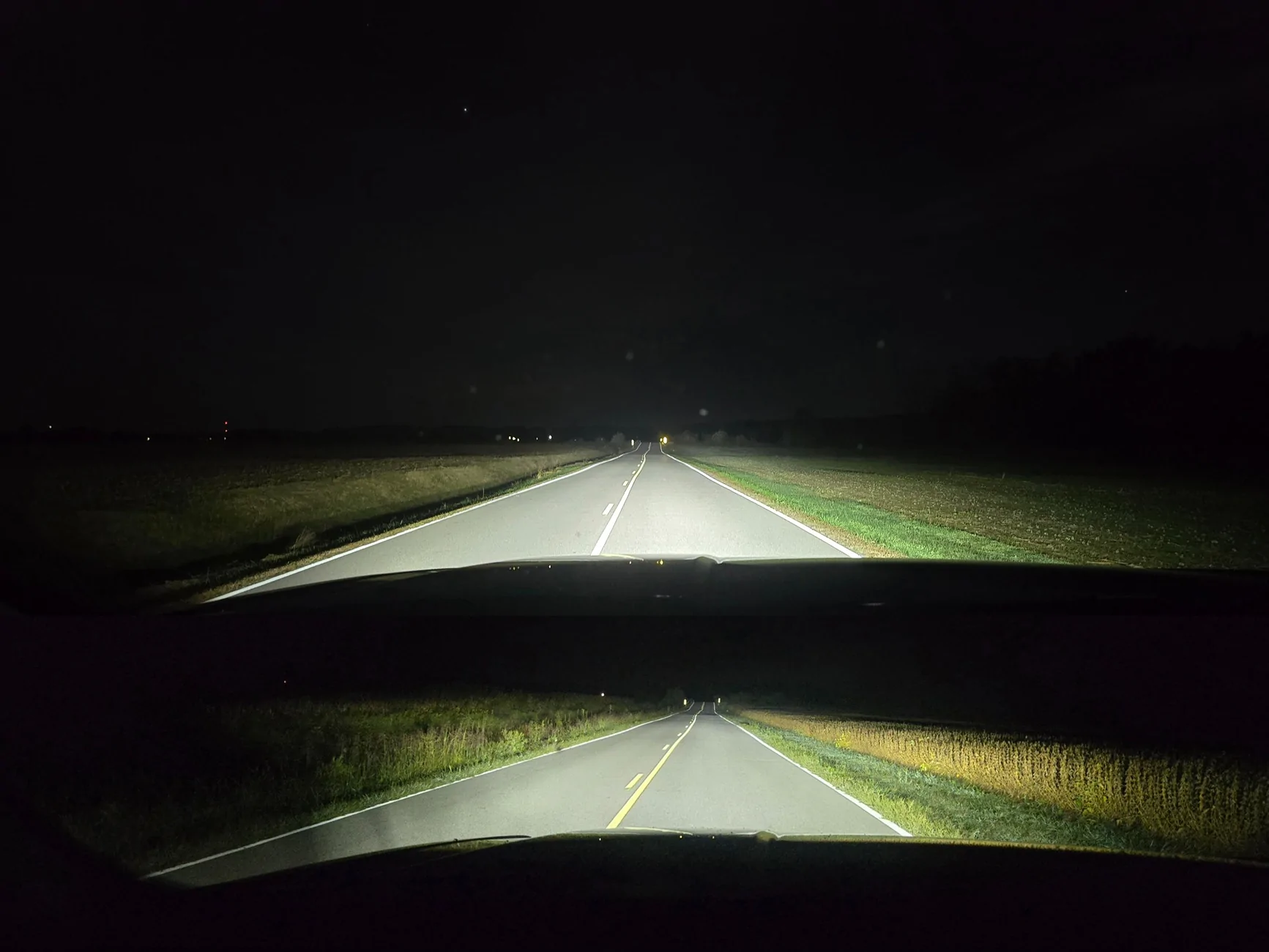

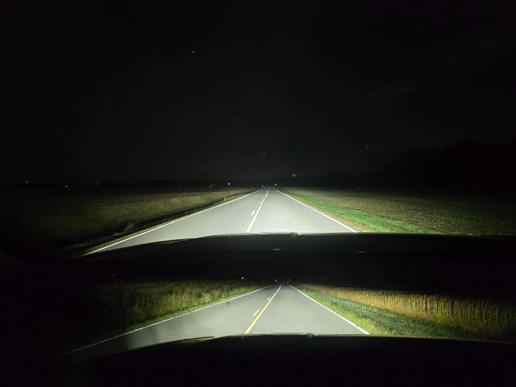

I have a few
Ford Maverick Form headlights assembly install? FB_IMG_1762138868253(1)
Ford Maverick Form headlights assembly install? 20250928_184800
Ford Maverick Form headlights assembly install? 20250928_184652
The first picture is low beam, second is high beam. New lights are on the top in both pictures. I lowered the aim a little since taking these pictures though.

Looks like the new lights are aimed too high, I’d hate to be a oncoming driver.
They definitely were, luckily it was a short drive on some back roads by my house. I set them at a 2" drop at 20' but I think maybe my back tires were on a bump or something. On the drive I noticed the cutoff line was visible on stop signs a couple hundred feed away and when I got home and checked I was about 1" above level at 20'.

I have a few
I am thinking about getting these, now I know I am based on how much better the light output and pattern is! How do you like them though? I live in ND so rural DARK country roads are everywhere. Thanks

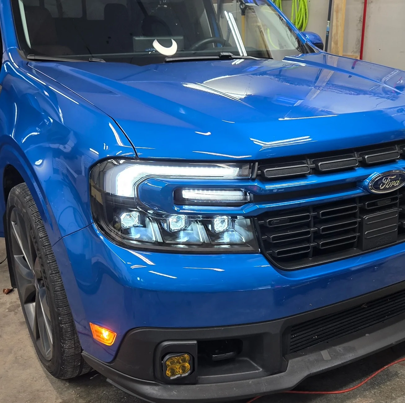

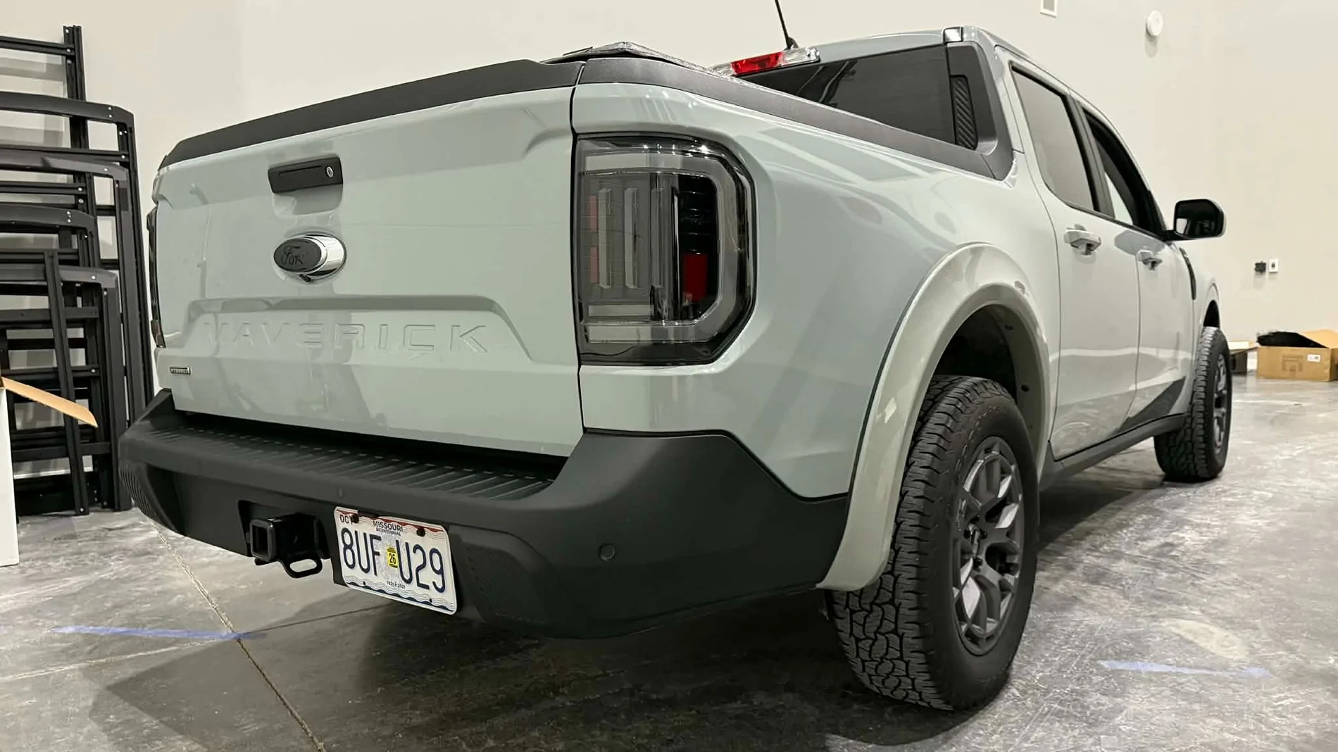

Finally coming by the end of this month

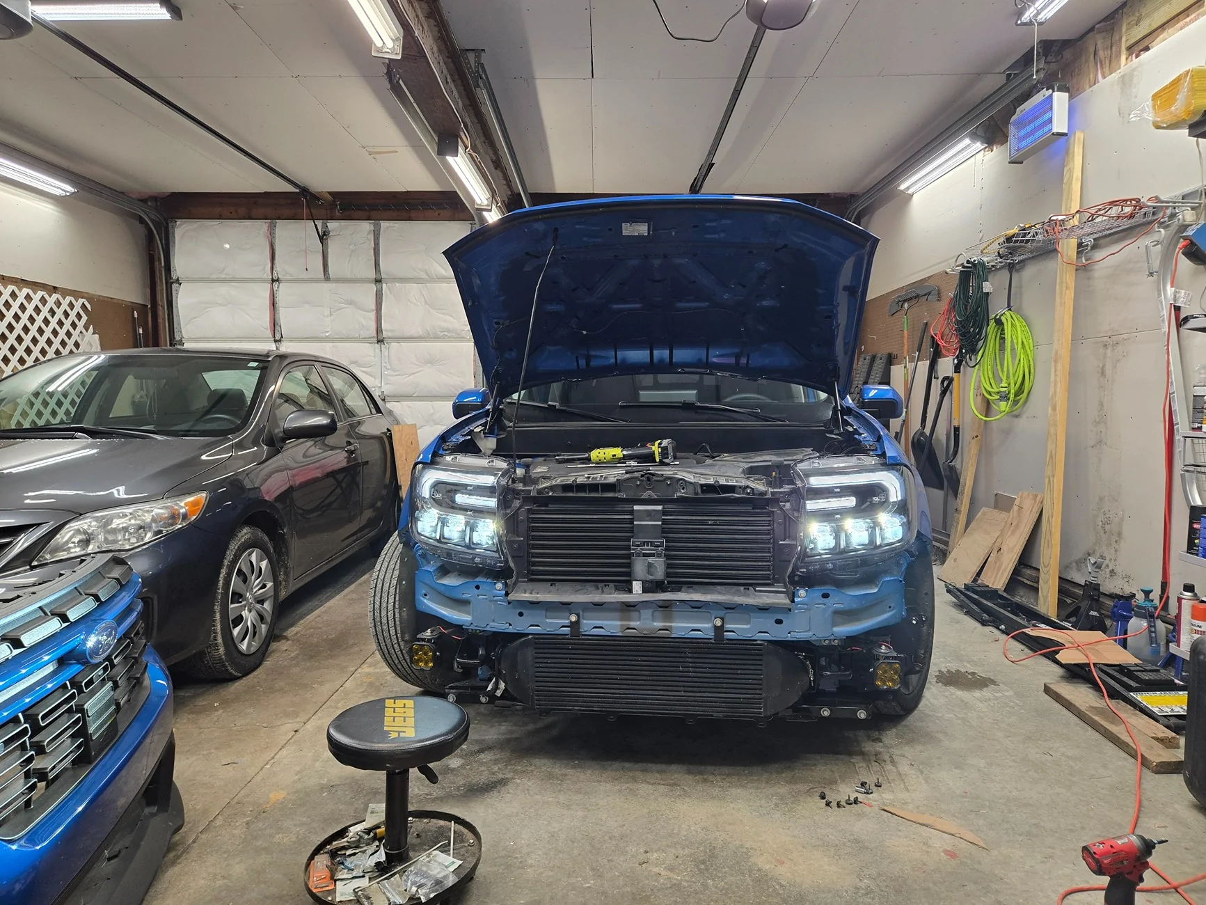

Install really isn't that bad
