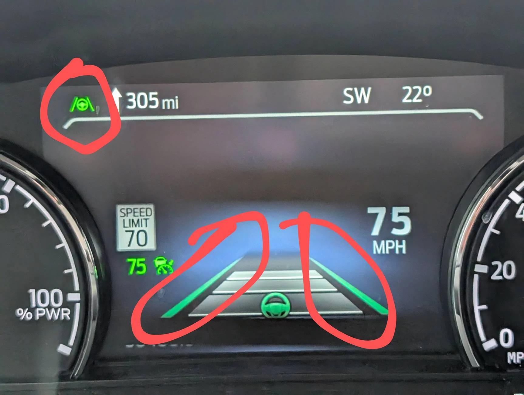

Thanks for replying. Yes the little steering wheel and lane markers appear at the to left of my dash board. If I am between the lane markers it turns green. I know what button you are talking about. I've turned it on and off just to make sure it's working.
If the Wheel with lanes is in green in the top left, and both lanes are marked green in the center of the dash, ACC/Lane Centering should be on. Sometimes it won't detect the right or left side lanes and they will be white, lane centering won't work.
If yours looks like my photo and it's not staying centered in the lane, something is wrong with it.

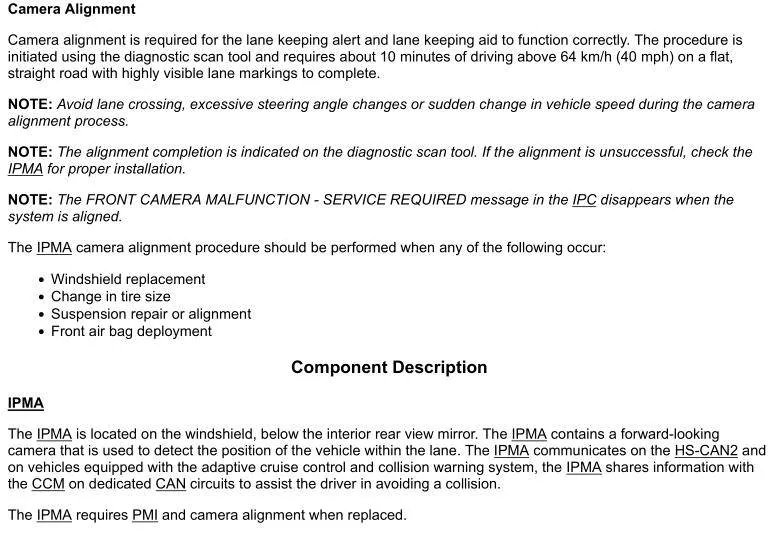

A guess would be if the IPMA Lane Departure Warning System Camera Calibration is needed.
Ford's FDRS can do it.
Forscan shows it as one of the service procedures.
Lane centering + ACC = Ping Pong (NOT Blue Cruise)
this is likely, but the easiest thing to check first is that the IPMA camera is clean and the windshield is not chipped near the camera.
if it's dirty or damaged you'll get degraded performance. eventually it'll chirp and tell you that the camera is blocked, but there's a range of bad before that happens.
again - probably calibration needed.

It may not be enough to make a difference. But then again it could be. Have the dealership perform an ipma camera alignment procedure. When we do it, we measure ride height and enter the value into our scan tool before performing the procedure
