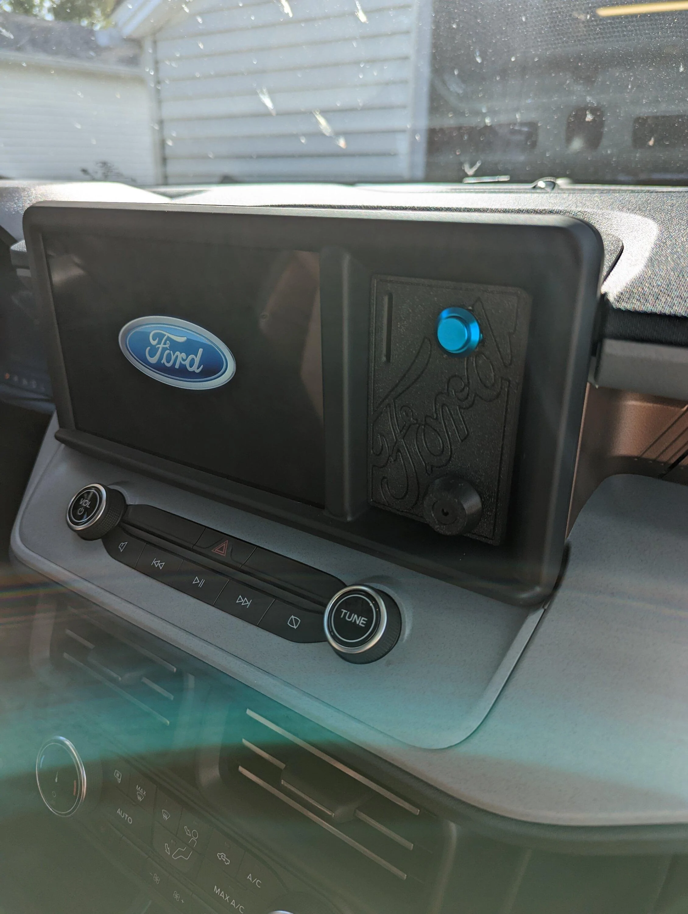

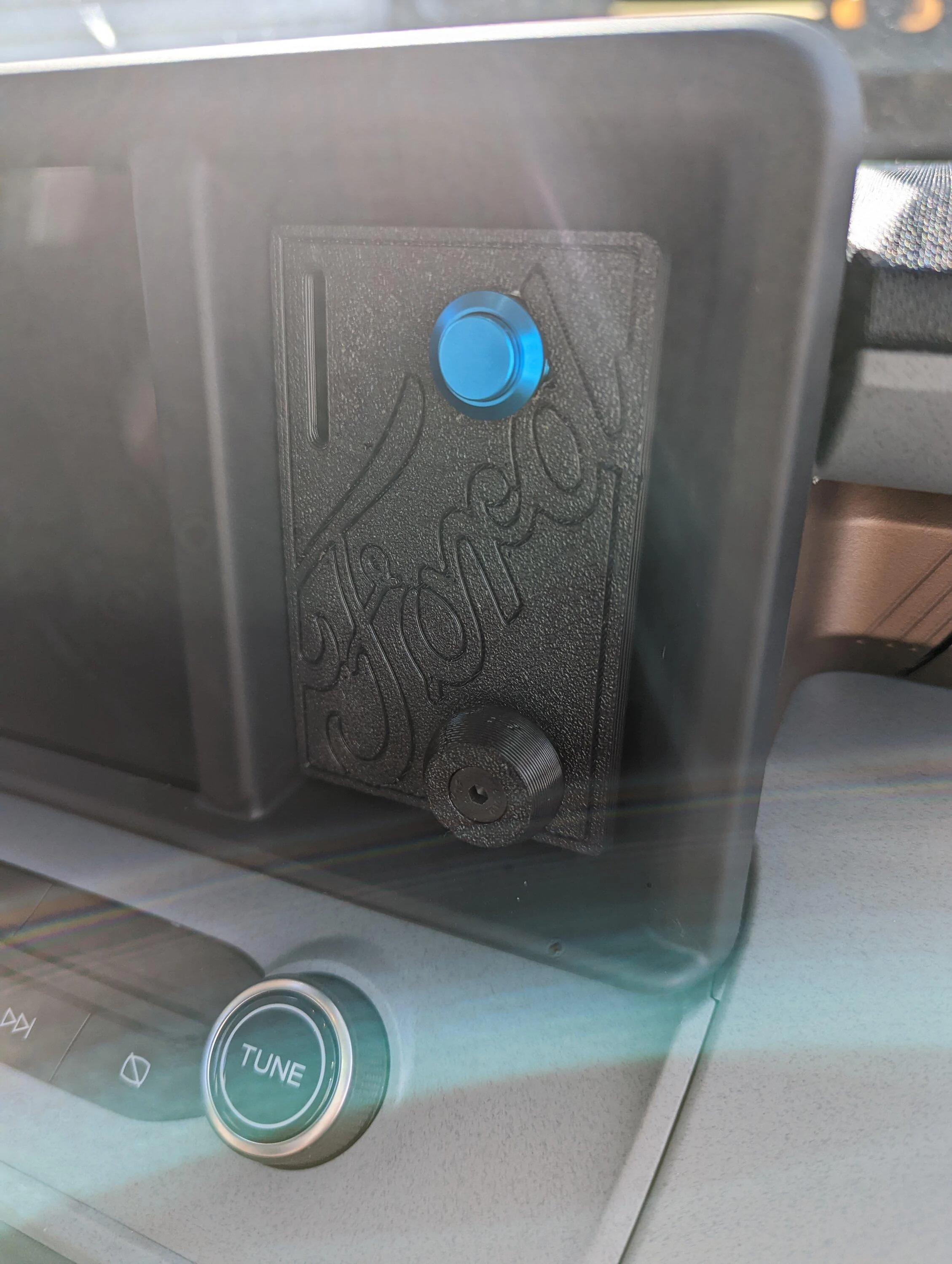

Thought I would share this little build I did that was inspired by some videos online.
Programed a universal garage door opener and soldered to a momentary blue flush button. Then I attached to a 3D printed cubby I purchased on Etsy.
Works great and is cleaner looking than a button clipped to the visor in my opinion.

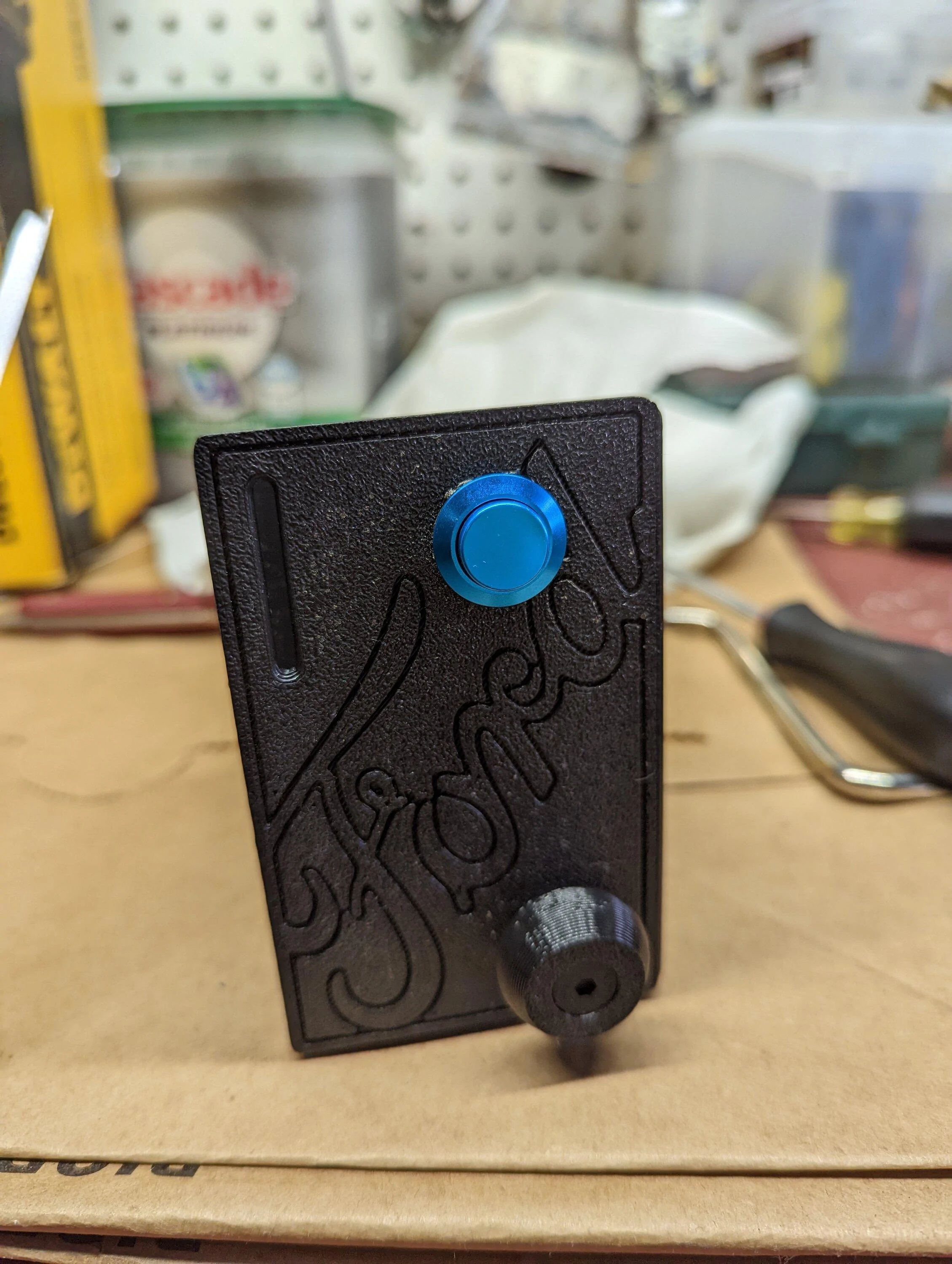

Whats the black knob on the bottom for? Just something to grab on to?
Abbers1125
Abby
May 13, 2022
Mazda CX 5
Correct. Just something to make it easier to pull the little cubby out from the opening

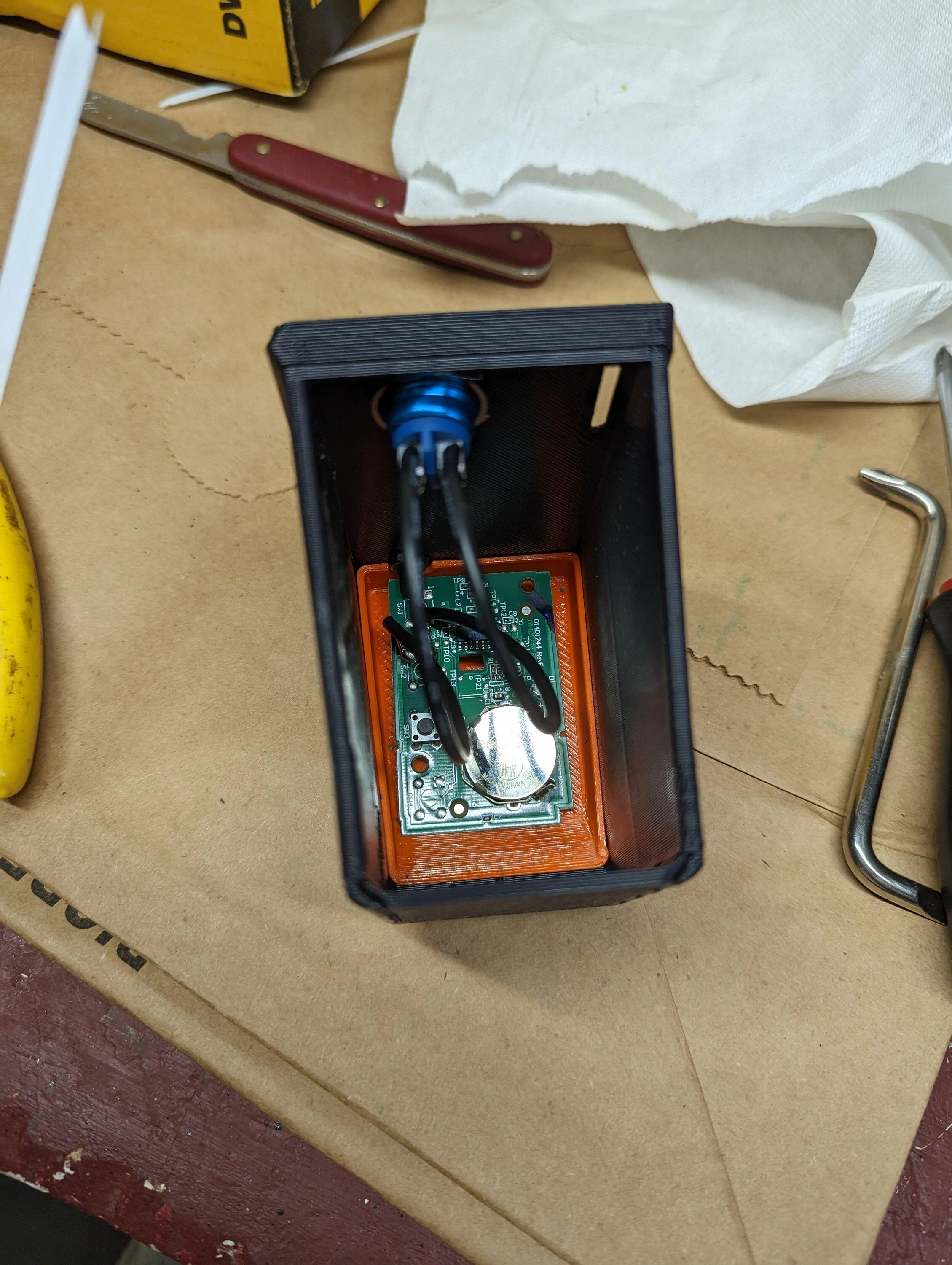

Iowa
Which garage door opener did you use? I've looked at a couple but the pcb appears to be too big for the cubby.
