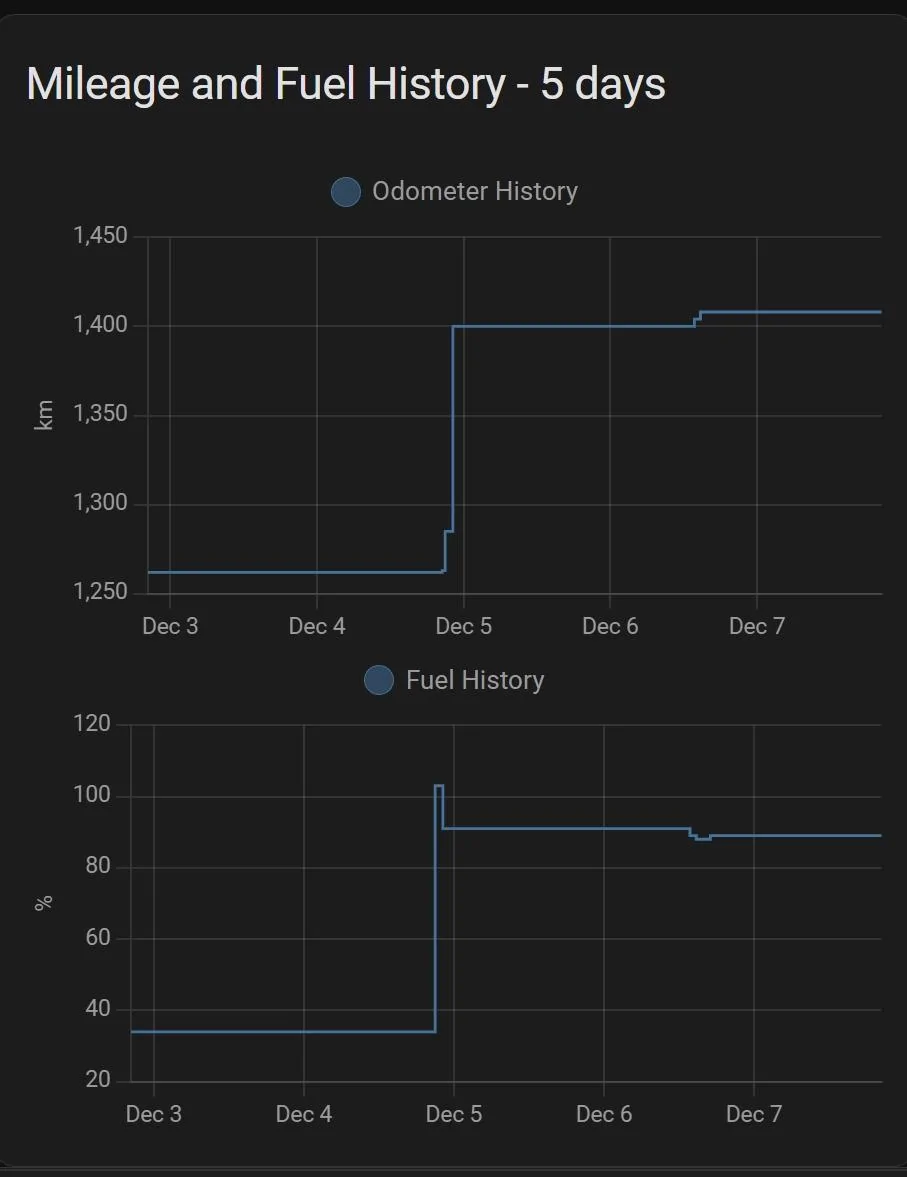

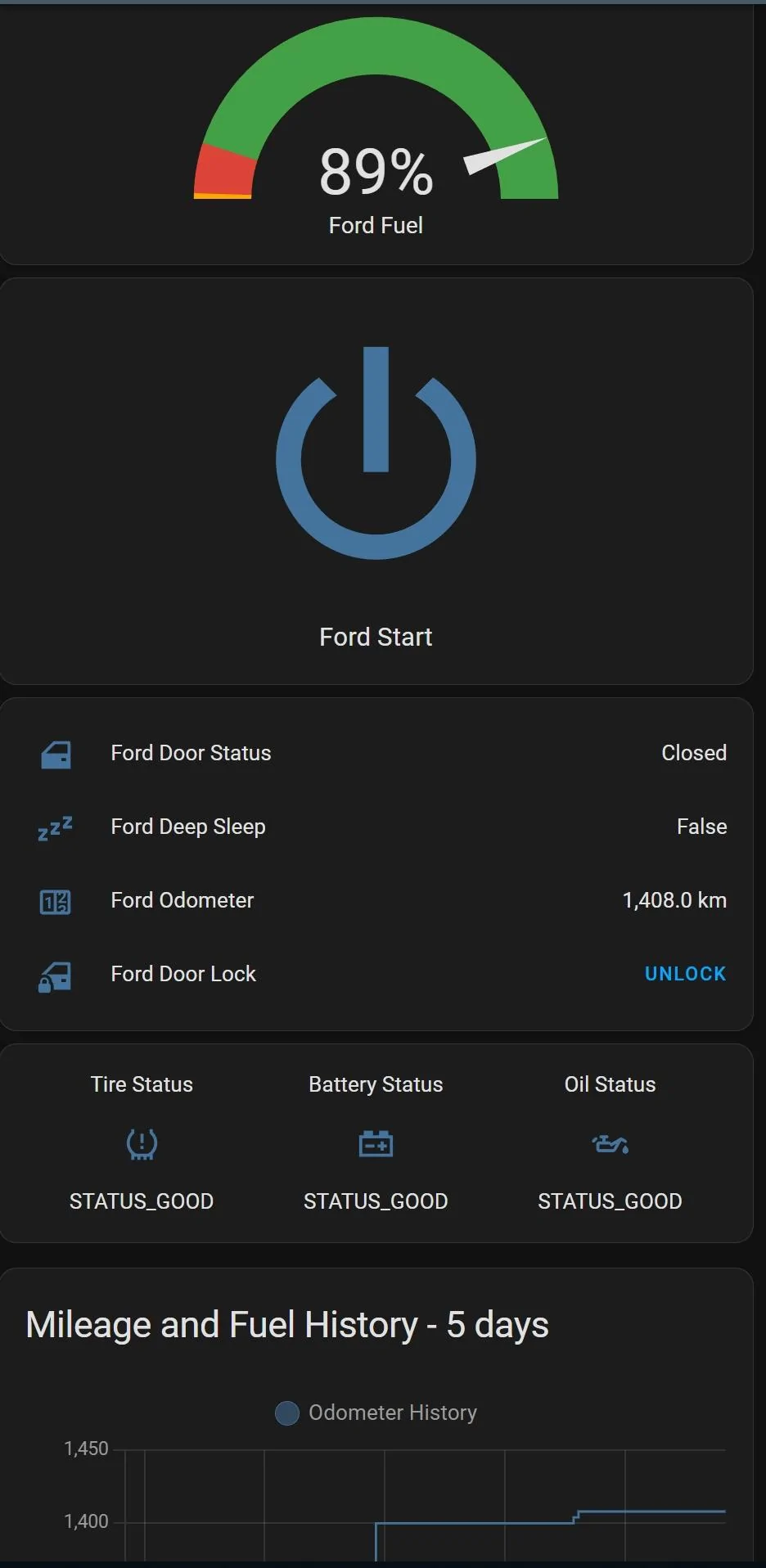

I have done some Maverick automation with history graph to monitor fuel consumption and mileage for my mav hybrid. I would like to have historical data as well as tire pressure, oil and battery status. Having ability to monitor and start maverick via home automation is nice convenience. Alexa, Start Maverick!
Any nice ideas on ford monitoring and automation ?

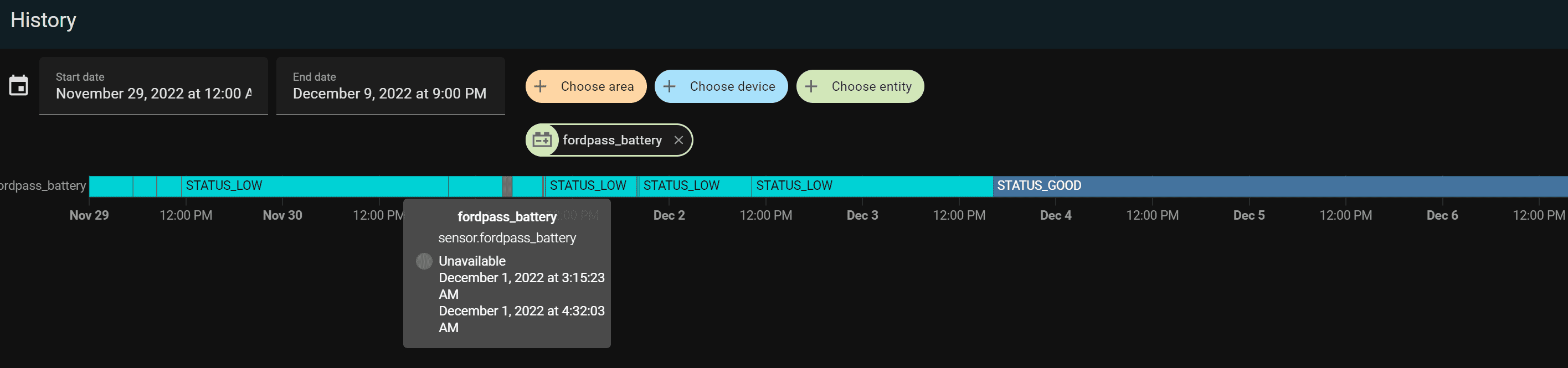

Good example of history monitor is below. on December 1st from 3:15 AM to 4:32 AM battery voltage dropped to low threshold. My battery was low due to a cold night -11 Celsius. ( 12.2 Fahrenheit ) and background components draining battery, such as, cellar radio, WIFI, alarm, components testing, etc.
Next day i installed 1 amp trickle charger to keep battery fully charged. Sometimes history graph and email notifications can be used for car troubleshooting.

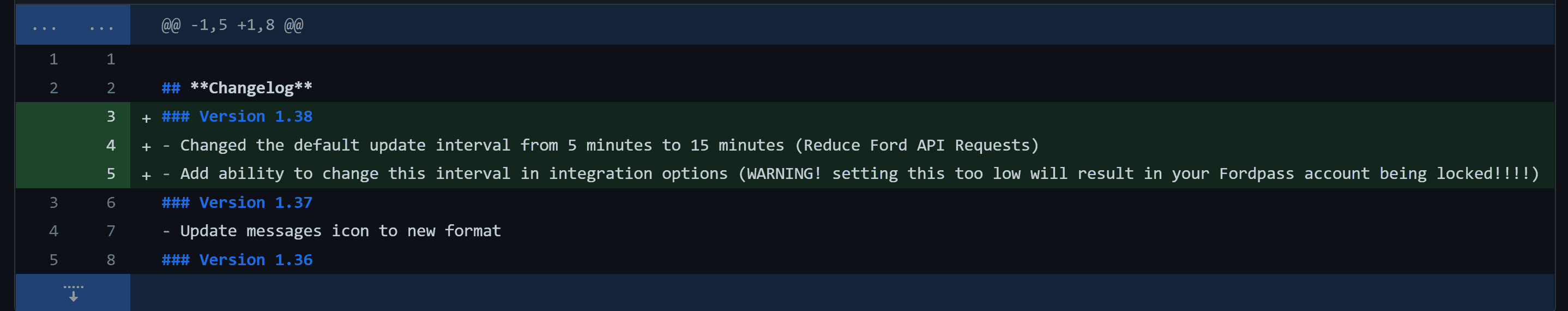

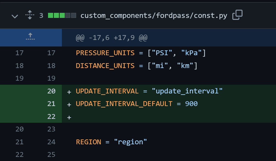

Looks like account lock down issue was "resolved" by increasing pull interval from 5 min to 15 min.
Thanks, that's good to know. I'll keep watching that developer to see if it truly is resolved. I really liked having the HomeKit integration.
