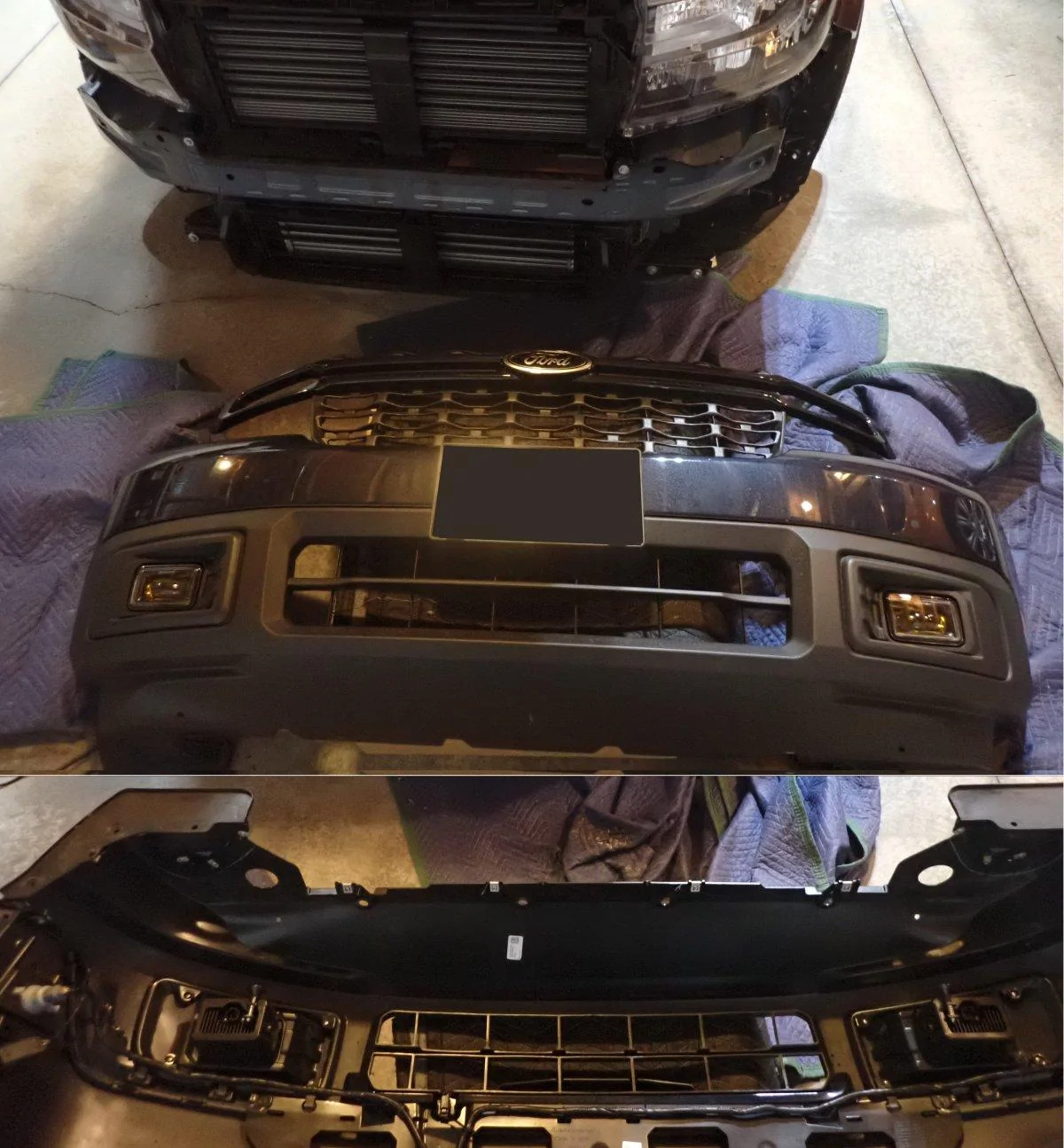

Fogs came in today.
Hard part is done. I'll run the wiring and put it back together tomorrow.
Ford Maverick ****FOGLIGHTS**** Installed [Diode Dynamics] install 1
