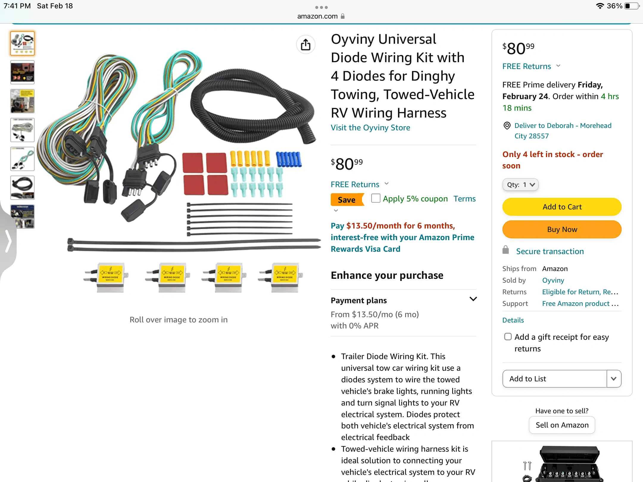

Heres the one I used. Etrailer has a great video showing how to install. Very easy.
Ford Maverick Flat towing with RV1 brake 0336059F-9C62-4CA2-8D5D-0AD472A6C144
The one I ordered form Roadmaster looks similar except it includes the umbilical between the toad and RV.
This one has the umbilical between toad and rv.
