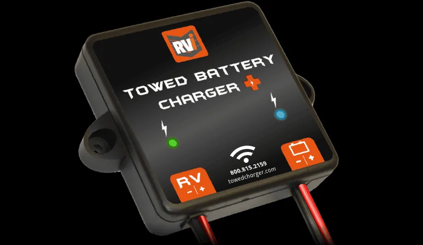

I also have been having issues with my patriot braking system giving me an alarm because it indicates that the towed vehicle battery is low. I believe I have isolated the problem to the 12v outlet that I plug into is only live for 30 minutes after turning the car off. Am going to have an additional 12v outlet installed that will be live at all times. Have already installed an RVI towed battery charger.
As for the severe battery drain I suspect that the car may not have been turned off after putting into neutral tow mode.
Just got back from a 110 mile trial run after installing a 12v port that is wired live as opposed to the one in the maverick that goes to sleep after a short period of time. All worked well! Been a miserable time trying to isolate the problem.

Another update on towing our Maverick Lariat. We just completed the first 460 miles of our trip south for the winter with zero trouble with the Mav. Seems that the answer to our issues was indeed the 12v port that goes to sleep after a short period of time. Once we had a dedicated 12v port added, we have had no issues. The trucklet towed beautifully once we did this. Now on to the sun in the morning. Happy motoring/towing to all!
