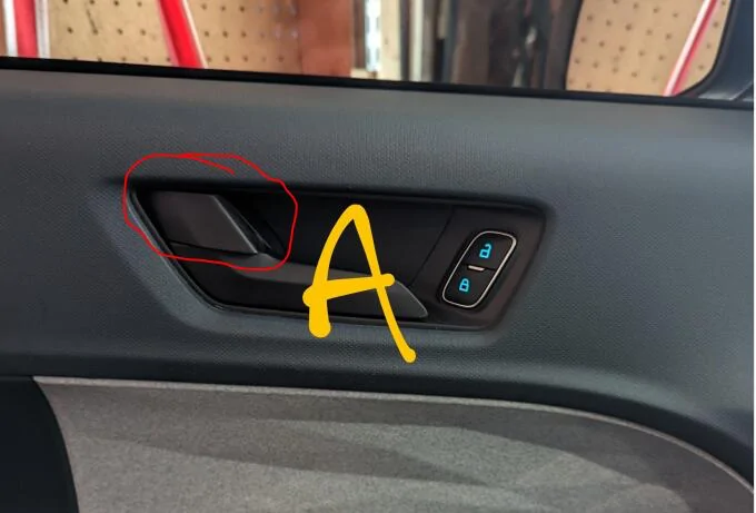

Did you try locking the doors manually instead of the power lock?

No I did not, I will try that in another week+ for the next RV trip.
