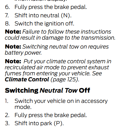

I haven't investigated fully, but that might cause an issue with the neutral tow setting.
The manual is a little vague... But my RV has power in its 7-pin that I will use as a charge wire to keep the battery charged

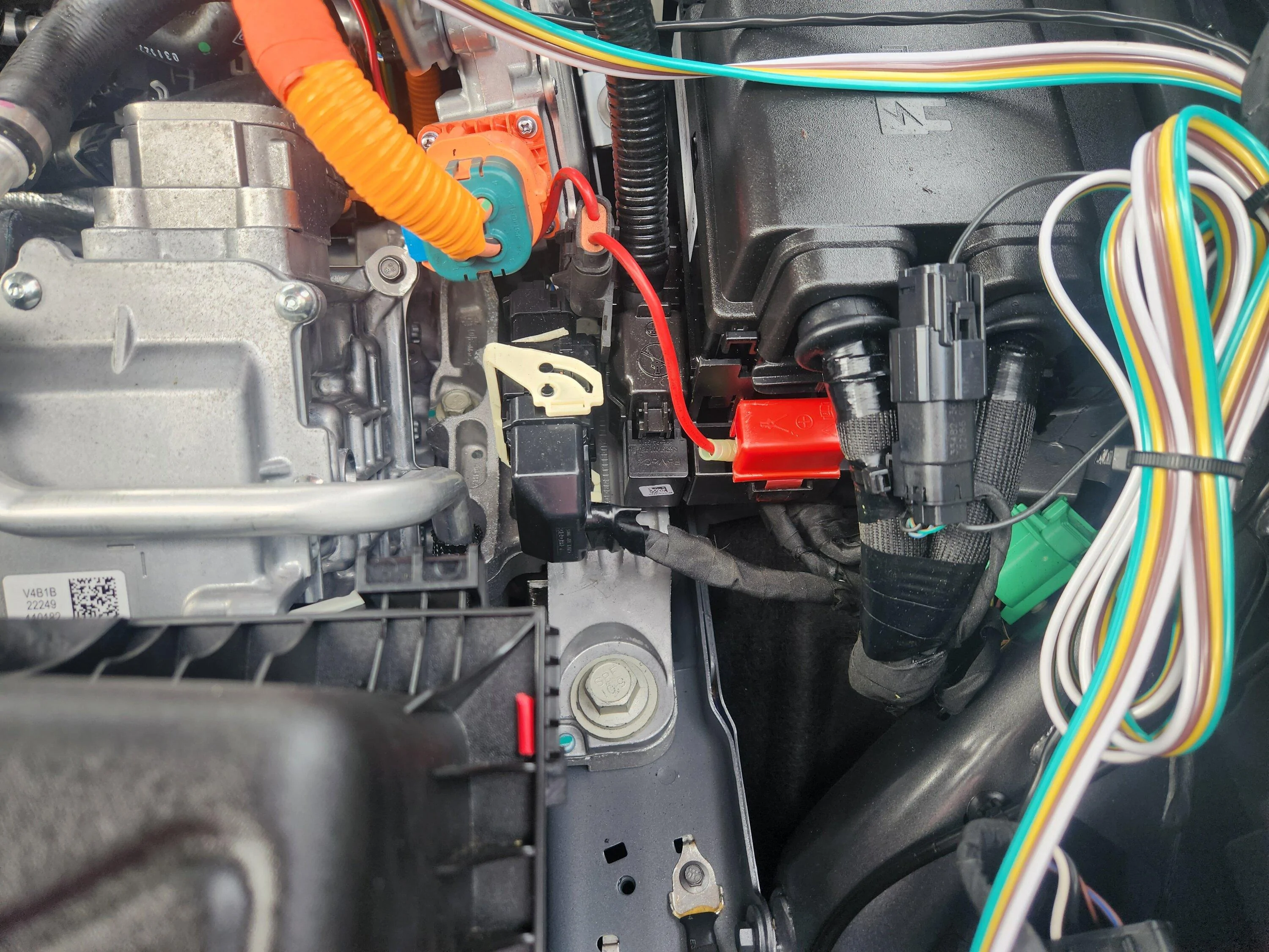

I hooked mine to the jumper post under the hood.
Ford Maverick Issues with flat towing? 7E40C414-811F-4FD8-B35A-A13A482886BD
keef033
Keith
Apr 16, 2023
Arkansas, USA
2022 Maverick XLT Hybrid
Thank you. Where did you connect the wire that is meant to go to the battery -ve terminal? Can you see the info on the RVi command center from the battery charger?
