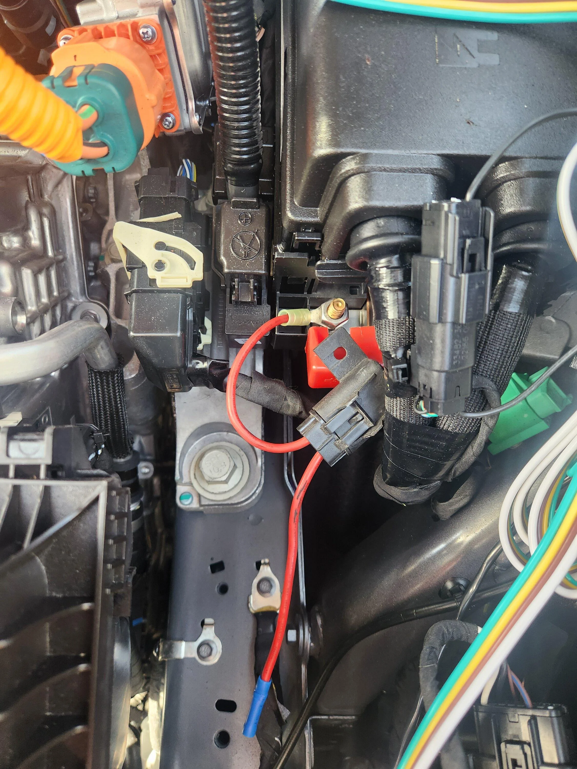

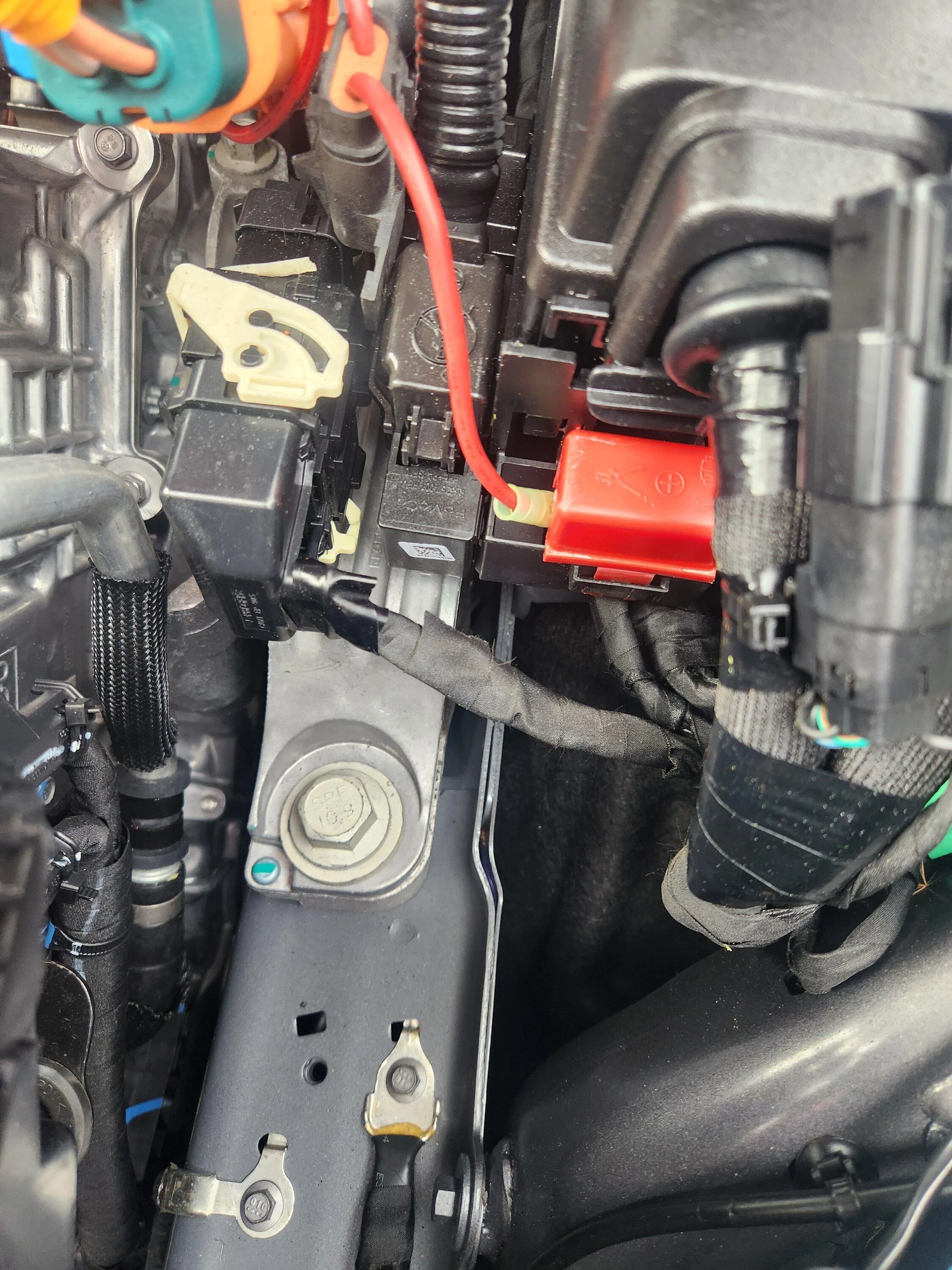

I ran a 12v always on source with an add a tap and ground from the fuse panel under the passenger foot well to power the Patriot 2. I’ve also installed a switch on the rv power to the RVi to avoid any drain unless in use. RVi directly to battery without using the positive or negative posts under the hood. My first battery quit and shut down the Mav after a tow similar to yours. Had to flat bed to dealer. Paid $400+ for diagnostic and new battery. Dealer denied warranty claiming it was the Rvi. Since changing battery never had problem. Battery is culprit but good luck in getting your dealer to admit it. Good luck.
