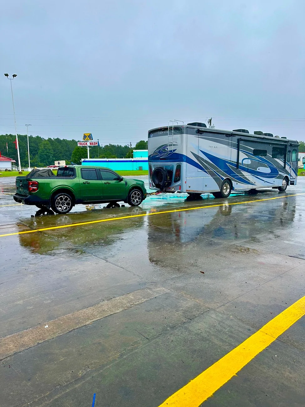

Ford Maverick Flat Towing - Anti-theft Triggered IMG_5960

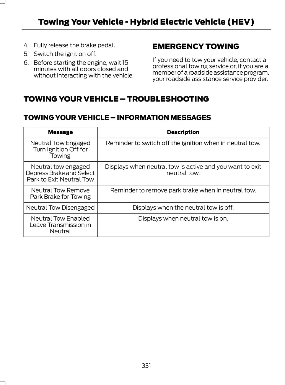

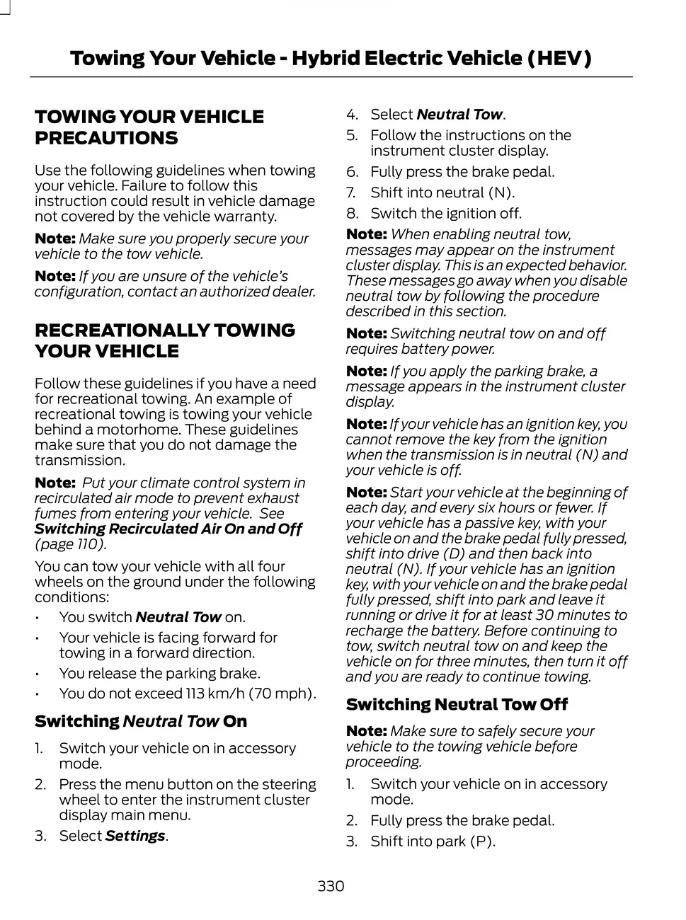

Screen Shot from my manual - I’ve been flat towing for years this Maverick is definitely one of the best I’ve towed four wheels down

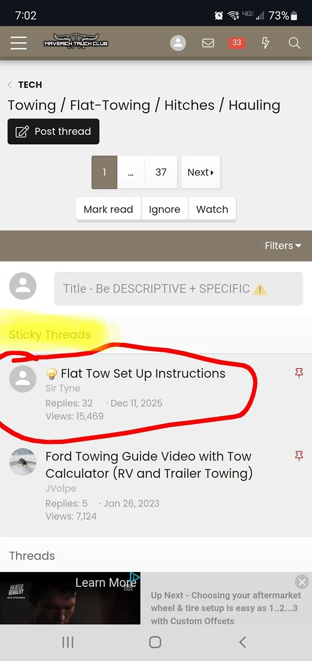

A sticky is a thread with particularly helpful info, that is permanently at the top of a forum.
Since many people like me have read and followed those instructions, I'd think we'd heard if this didn't work for the majority of the people.
Ford Maverick Flat Towing - Anti-theft Triggered Screenshot_20260207-190251_Chrome~2
