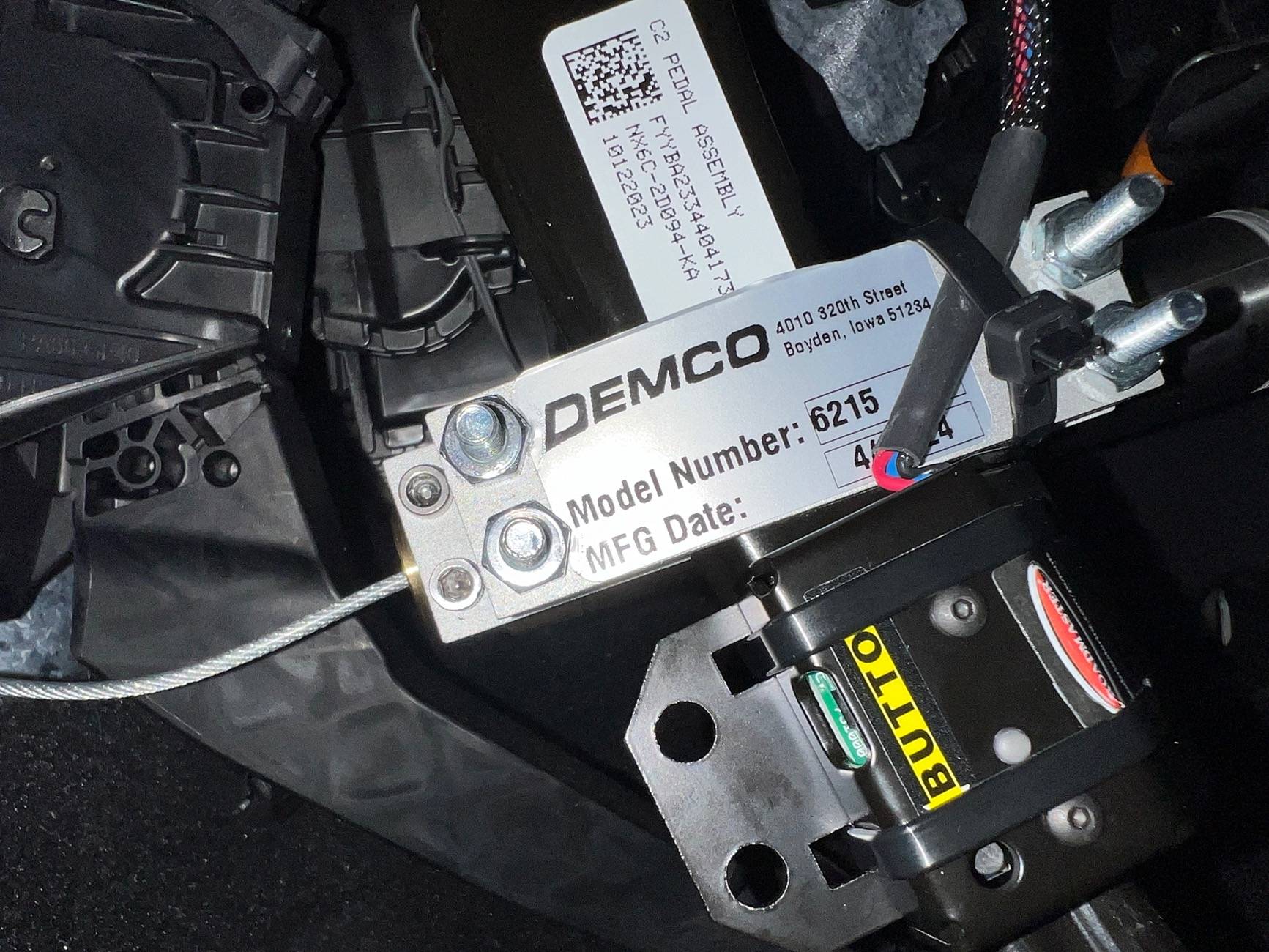

I am getting ready for my 3rd long trip towing the Maverick this week. I haven't gone 4 days without unhooking, but I always carry a little Panlong Code reader to identify and clear CELs. (I caused a few during my Demco install...turning the ignition on with the PED unplugged; with the front light and temperature sensor unplugged.)Thought this was a good place to post a flat tow report. 2023 Mav Lariat. Just got back from a 4200 mile trip. NO issues ever with going into or out of Neutral tow. In fact the only time that was an issue was all my fault as the brake pedal had not fully returned and held brake lights on....so Mav was in "run" mode not "accessory". That problem is fixed...
I am somewhere well over 10,000 miles flat towing the Mav.
On the return trip to Houston from West Glacier, Montana I had planned to not even unhook. 2000 miles and 5 days. On the morning of the 4th day....an engine service light came on. Not flashing, so not a reason to not drive or tow. That evening we unhooked and I drove it a bit. Light stayed on, but all worked as it should. Next day at first "exercise" stop the light went off. I am thinking the constant starting for just a few minutes might have triggered a fault code due to engine not coming to temp, misfire, or whatever. Light is still off so all is good. Anyone else have this happen? I am thinking I will be sure to unhook at least every third day for a drive.....

I keep a good code reader in the RV. Didn't bother to check the code. I was actually thinking/hoping it would clear itself after a few miles/restarts. And it did. Just thought it interesting that it happened and I think the morning starts, exercise starts, end of day starts screwed with the computer and what it thinks is happening. Engine never gets to temp for instance. I will make it a plan to unhook by the third day next long trip.....I am getting ready for my 3rd long trip towing the Maverick this week. I haven't gone 4 days without unhooking, but I always carry a little Panlong Code reader to identify and clear CELs.
Cheap worry removal.
That makes sense to me. My trips are generally 3 days to wherever I go...CA, WA or IN, so I haven't had that happen yet.I keep a good code reader in the RV. Didn't bother to check the code. I was actually thinking/hoping it would clear itself after a few miles/restarts. And it did. Just thought it interesting that it happened and I think the morning starts, exercise starts, end of day starts screwed with the computer and what it thinks is happening. Engine never gets to temp for instance. I will make it a plan to unhook by the third day next long trip.....
