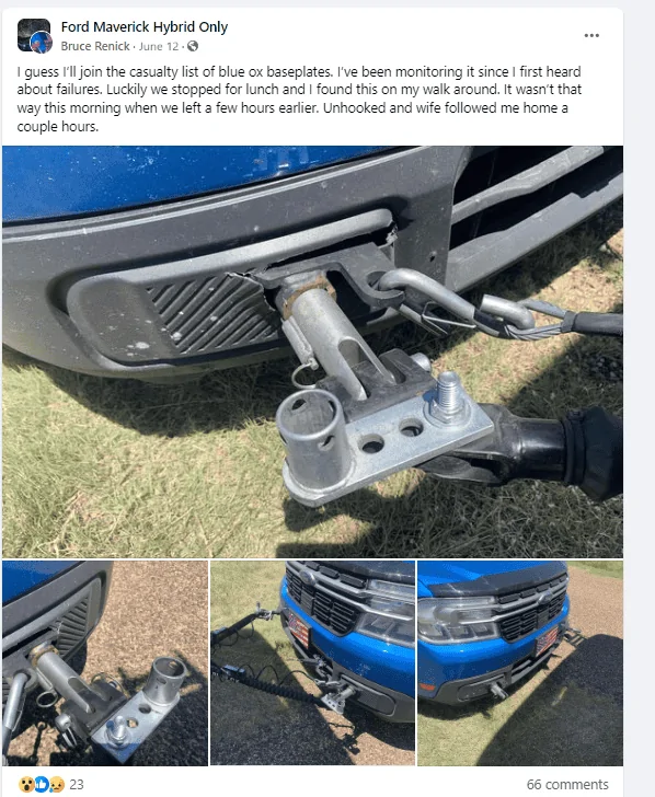

And what will you use for your next baseplate, once the BlueOx fails? You've not read much in this group, I am guessing.
Here's a recent example of Blue Ox failure and their response. The baseplate they sell you is too wide for the towbar they sell you, but that makes it your fault.

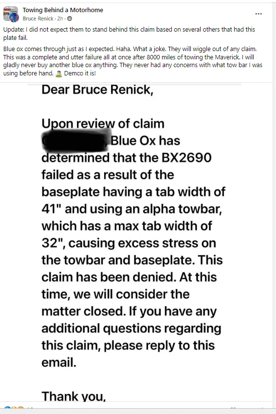

And.....

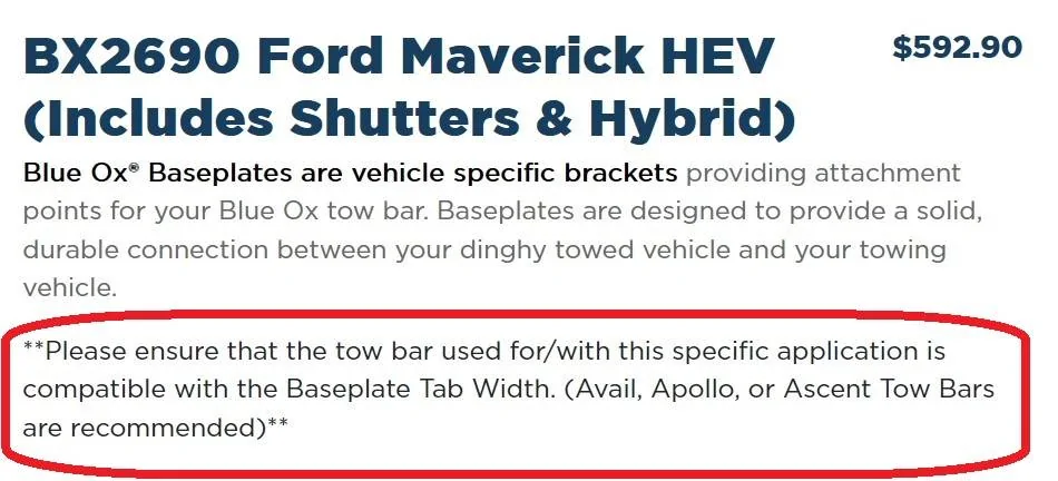

So who would have been responsible for ignoring this statement?
HRG
You are right, of course...but it is a piss-poor design to make a 2-piece baseplate so wide, without a crossbar in use to make sure there is no outward pressure. And then sell towbars with different standards. My old Roadmaster Stowmaster or even my Roadmaster Falcon 2 towbars both have crossbars which negate the problem.
HRG
Two things I can add here. First, until recently, there was NO warning like you have circled in red. This comes about after NUMEROUS failures. I am one of those failures and was also told my Blue Ox and Ready Brute towbars were not "compatible". All of the information available when I bought and installed my Blue Ox baseplate was followed when installed.....
Second, we now know there ARE FAILURES when using the "approved" size Blue Ox towbar. The difference is in the towbar arm length. Some are longer, and the ones listed above are the longest they offer. Yet a failure WITH that length towbar has occurred, and the failure was exactly the same parts and circumstance as all the other failures. This customer was forced to sign a discloser before they would settle. He was given a new set of baseplates, which are still on his shelf as he won't use them. Replaced with either a Demco or Roadmaster.
Blue Ox Maverick base plates have NO substantial part to tie the two sides together. This is why they spread apart and fail.
Thank you sir, I had a feeling that might have been a recent addition to the product page.

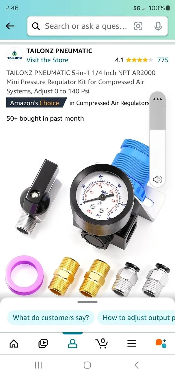

Can you share more info on the reducer you used and where you installed it?
Thanks
Twinboat
Roger
Oct 17, 2022
NY
2007 Jeep
Thanks
It's a air pressure regulator that goes on the line after the control box and the pedal cylinder. I bought mine from Amazon and it came with push fit fittings, so an easy install.
Ford Maverick Flat Tow - 2024 Maverick Hybrid Screenshot_20240727_024601_Amazon Shopping
Twinboat
Roger
Oct 17, 2022
NY
2007 Jeep
After control box and BEFORE the brake cylinder .
