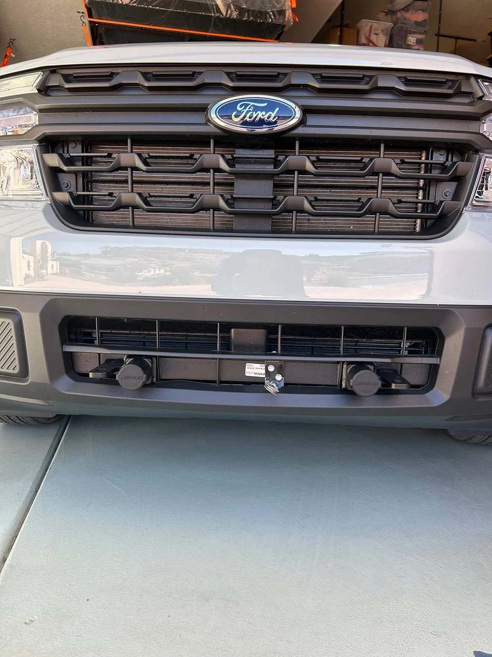

Well, here’s an update, the Deco base plate. I’m going to have to give it a A+ and super easy to install.
Ford Maverick Flat Tow - 2024 Maverick Hybrid IMG_7114

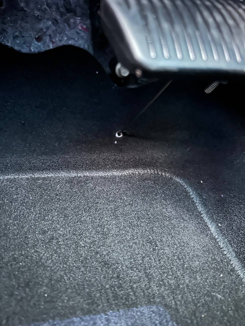

My brake set up is NSA ready brute II, I have had this in the last two jeeps, here’s a quick photo of brake cable coming through the floor, attached to the brake,
Ford Maverick Flat Tow - 2024 Maverick Hybrid IMG_7115

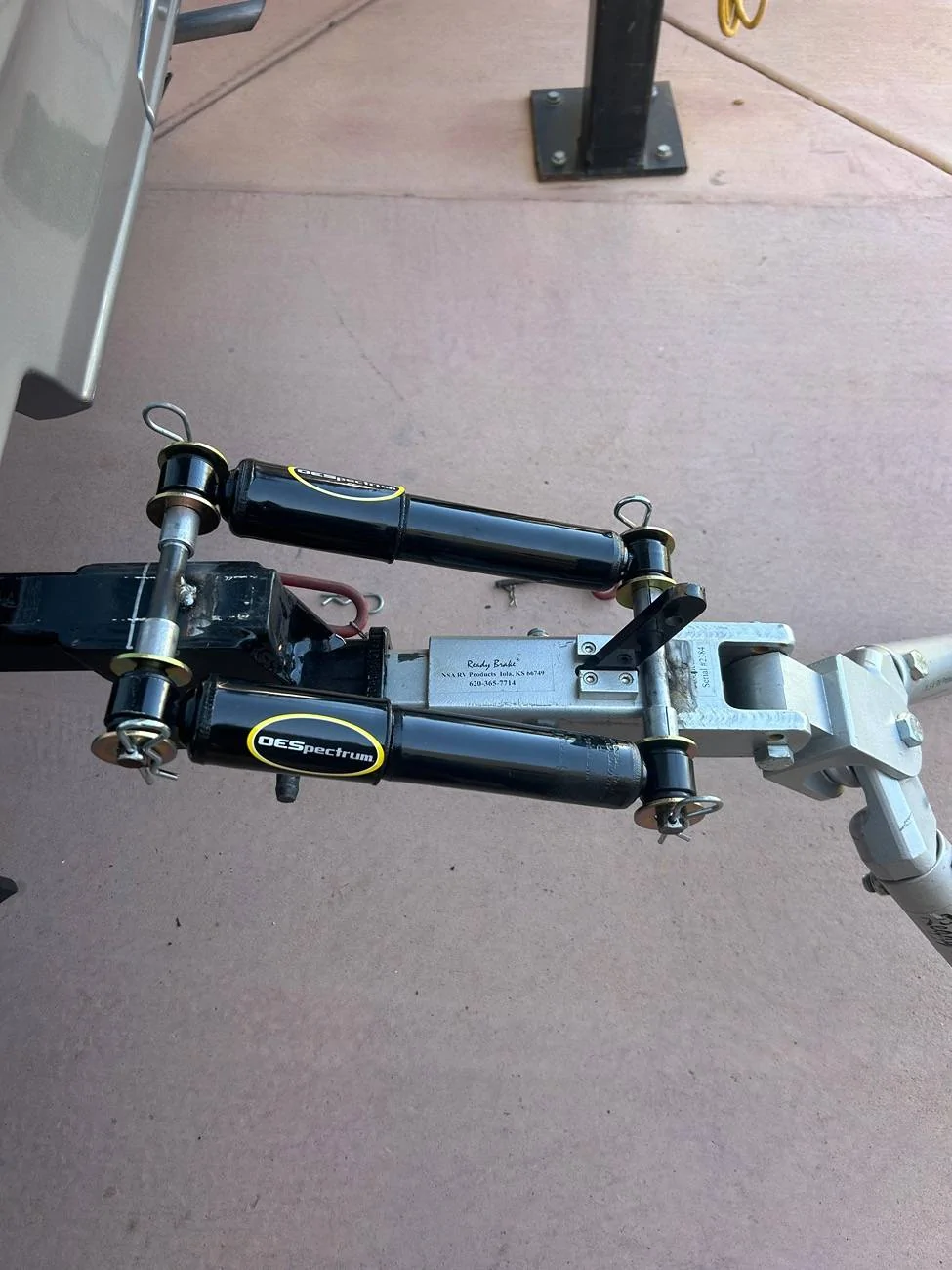

A big shout out to Shelby, I took your idea, going to be towing it this weekend. It’s only about a two hour tow out where I’m going and two hours back. I’m going to try a single dampening one way and double dampening coming back and see which one I like better.

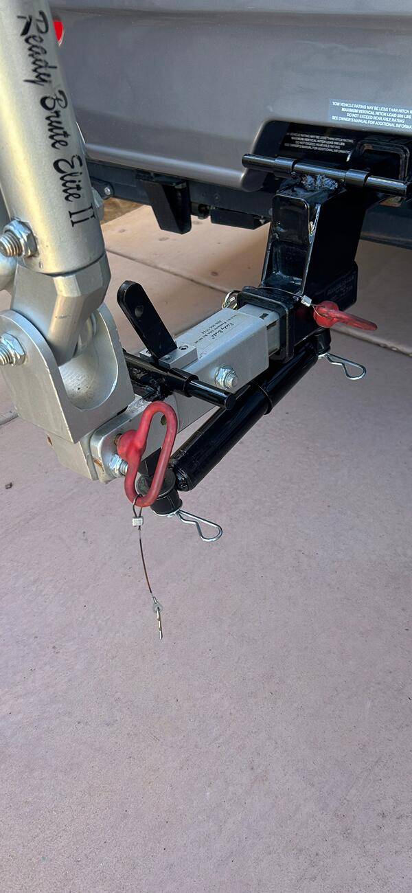

I’m really curious to see how much this calms things down
Ford Maverick Flat Tow - 2024 Maverick Hybrid IMG_7109
Ford Maverick Flat Tow - 2024 Maverick Hybrid IMG_7113

As you can see, I’ve connected to the actual hitch body, instead of the arm, so I will let you know?

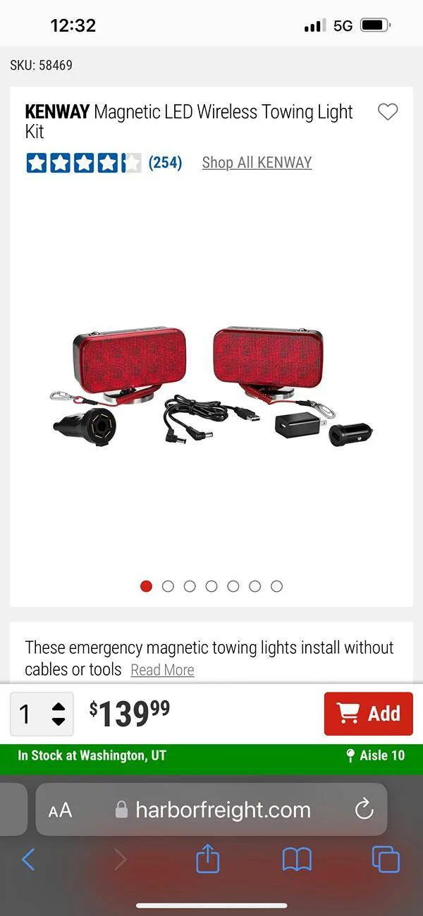

As far as lights go, I don’t mess with the vehicle at all I bought some LED rechargeable, towing package lights at Harbor freight, they last about 100 hours on a charge, and they work really well.
Ford Maverick Flat Tow - 2024 Maverick Hybrid IMG_7116

I forgot to mention these are totally wireless
