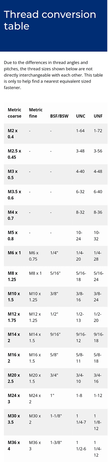

Finding the correct size nut is driving me nuts! Neither M8 1.25 or 5/16 18 fit. Still buying various sized nuts/threads and returning what doesn't fit. I am looking for specifics please.

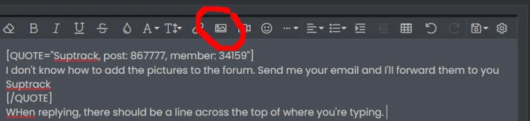

I don't know how to add the pictures to the forum. Send me your email and I'll forward them to you
Suptrack
When replying, there should be a line across the top of where you're typing. Hit the icon circled in the enclosed screenshot or go ctrl Pand select your image.

Conclusion. Thanks everyone for the information provided. Your insights and ETrailer won the day. RM 156-25 "towed vehicle charge line kit" is now installed. Final challenge was the specific nut needed for the positive jump post. I eventually went with 5/16 18, which was very tight, but worked out.

FYI. Edit to Add = looks like M8x1.25 or M8x1 (course/fine thread).

I just tried an M8 1.25mm thread and it does not fit on my 24 Mav charging post. I guess I'll try the M8 1.00

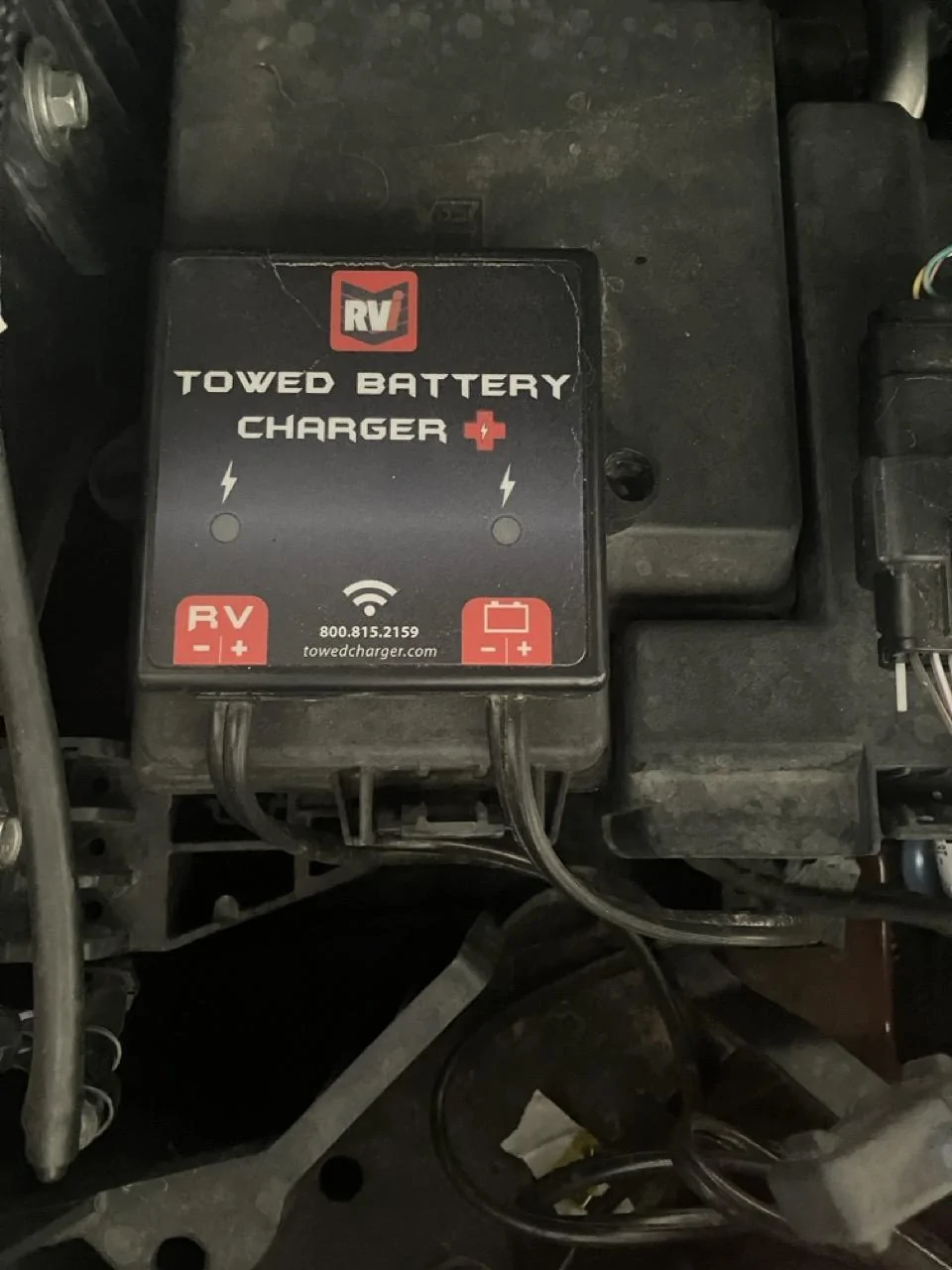

This RVI toad charge kit is what I use to connect the MH charge line to the toad. It has lights that indicate the circuit is or is not working. I’m confused with what you’re attempting to use?
I have the same charger, however, even after a long tow travel day within hours I get the Ford message that it’s disabling to conserve battery. I’m checking to ensure proper installation. Have you ever had that happen?
What I have found is that these charge devices fail regularly. I had to give up on them after two of them failed. You can tell if its working or not with the lights. If your battery is being discharged which it sounds like it is. Then you are not charging the towed vehicle. :sadface:
