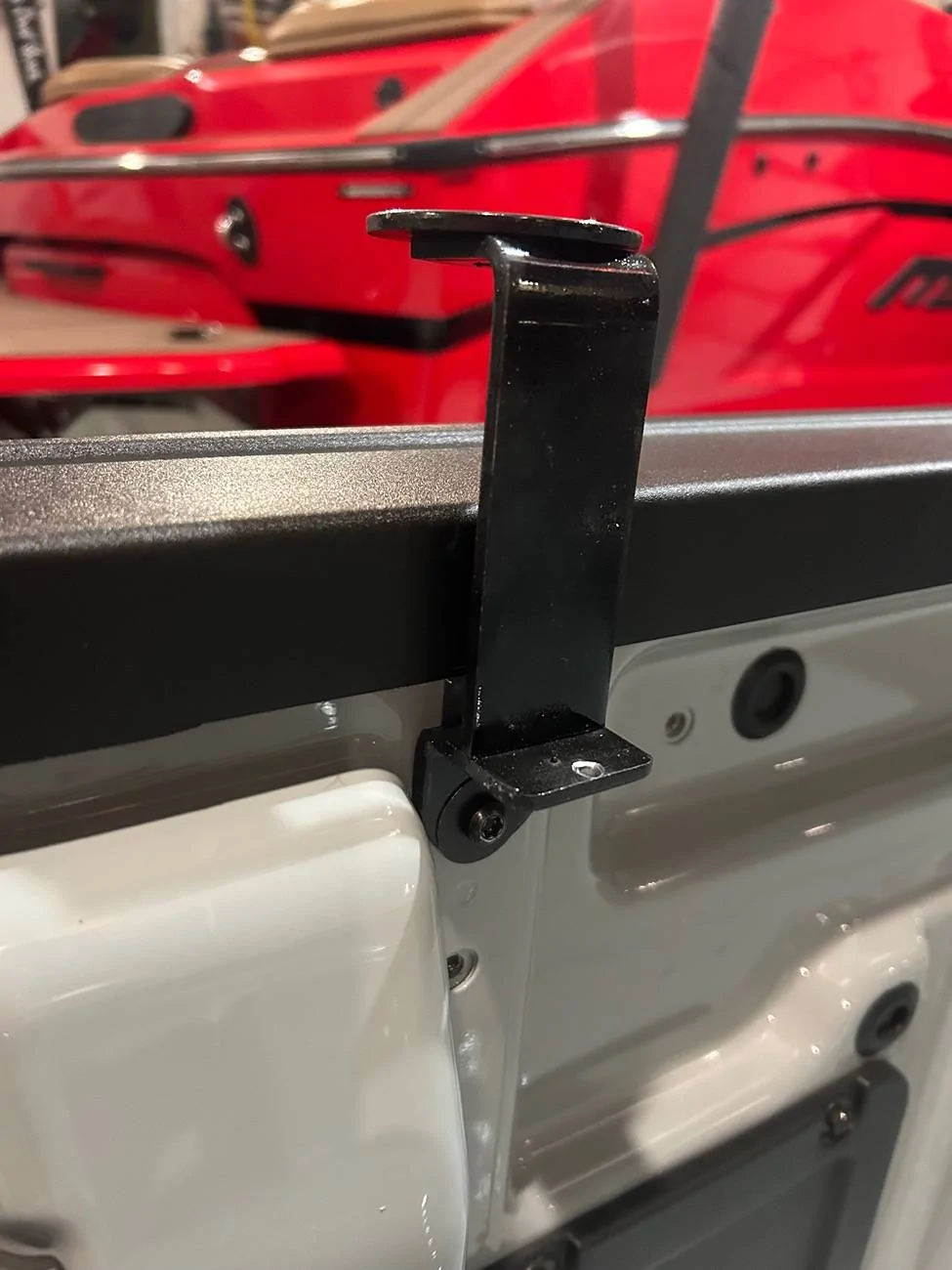

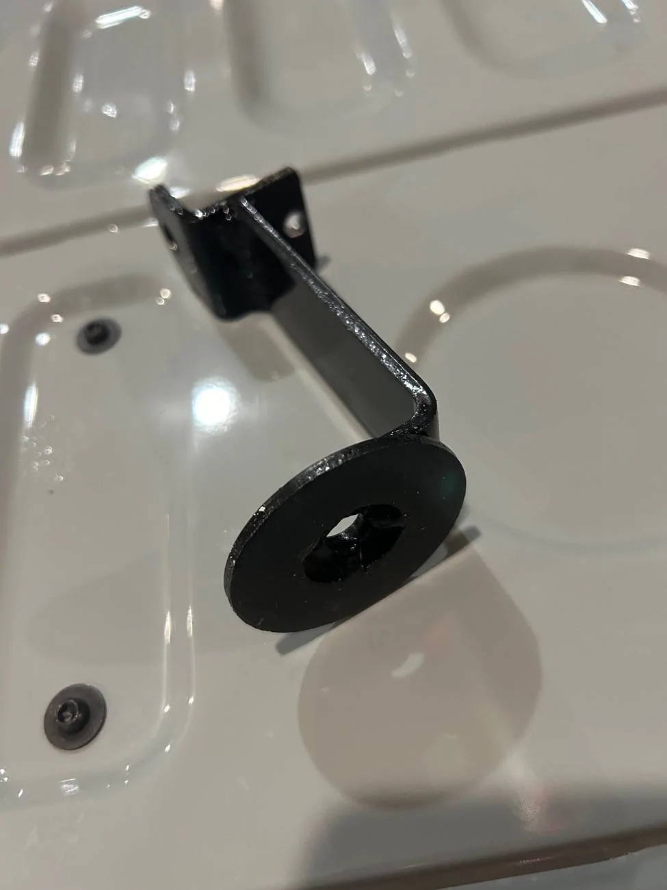

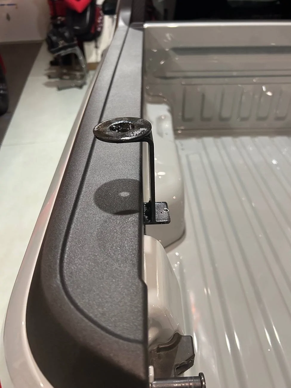

I made these little mounts. I hurry and stick on when I’m going to tow it so I don’t have to put those magnets on my paint.
