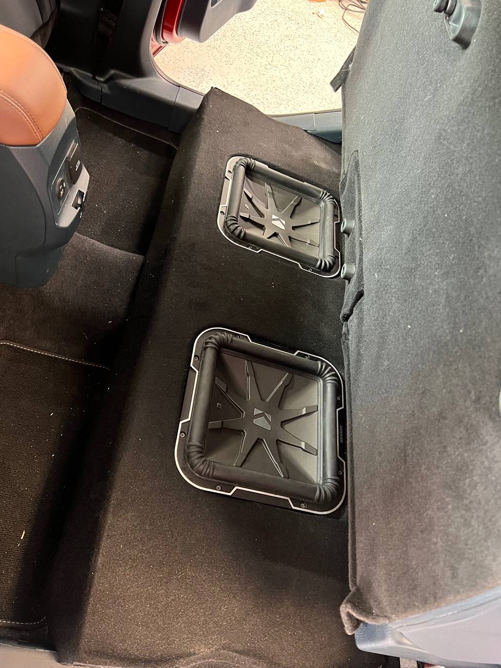

12’s can fit
Ford Maverick Finally JL makes one for the Maverick. IMG_1502
These are Q series (obv I removed the plastics)

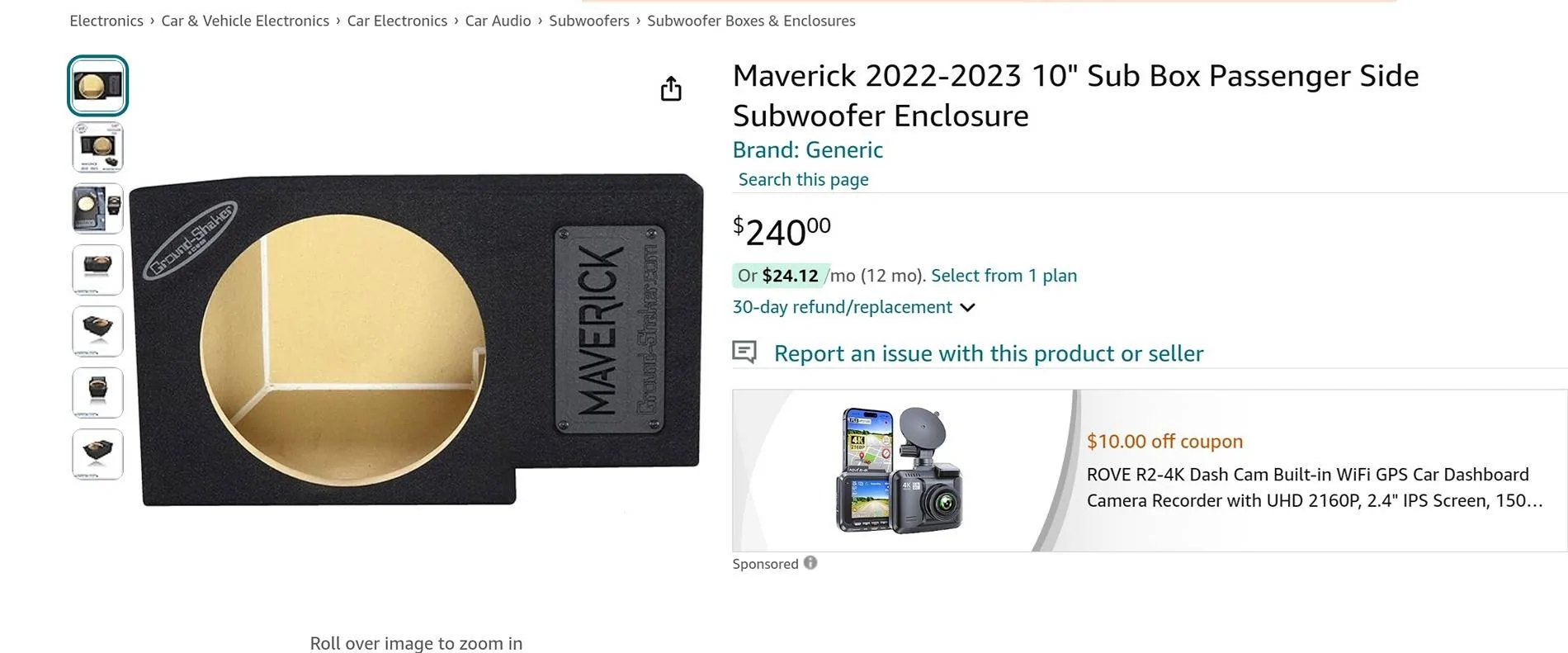

I agree, this is the identical box I will be building for my ps storage area. The box shouldn't cost me more than $50-75 to build.
Note that this box ONLY has 0.45 cubic feet of internal volume. That's going to be a tall order for a 10" to perform well.

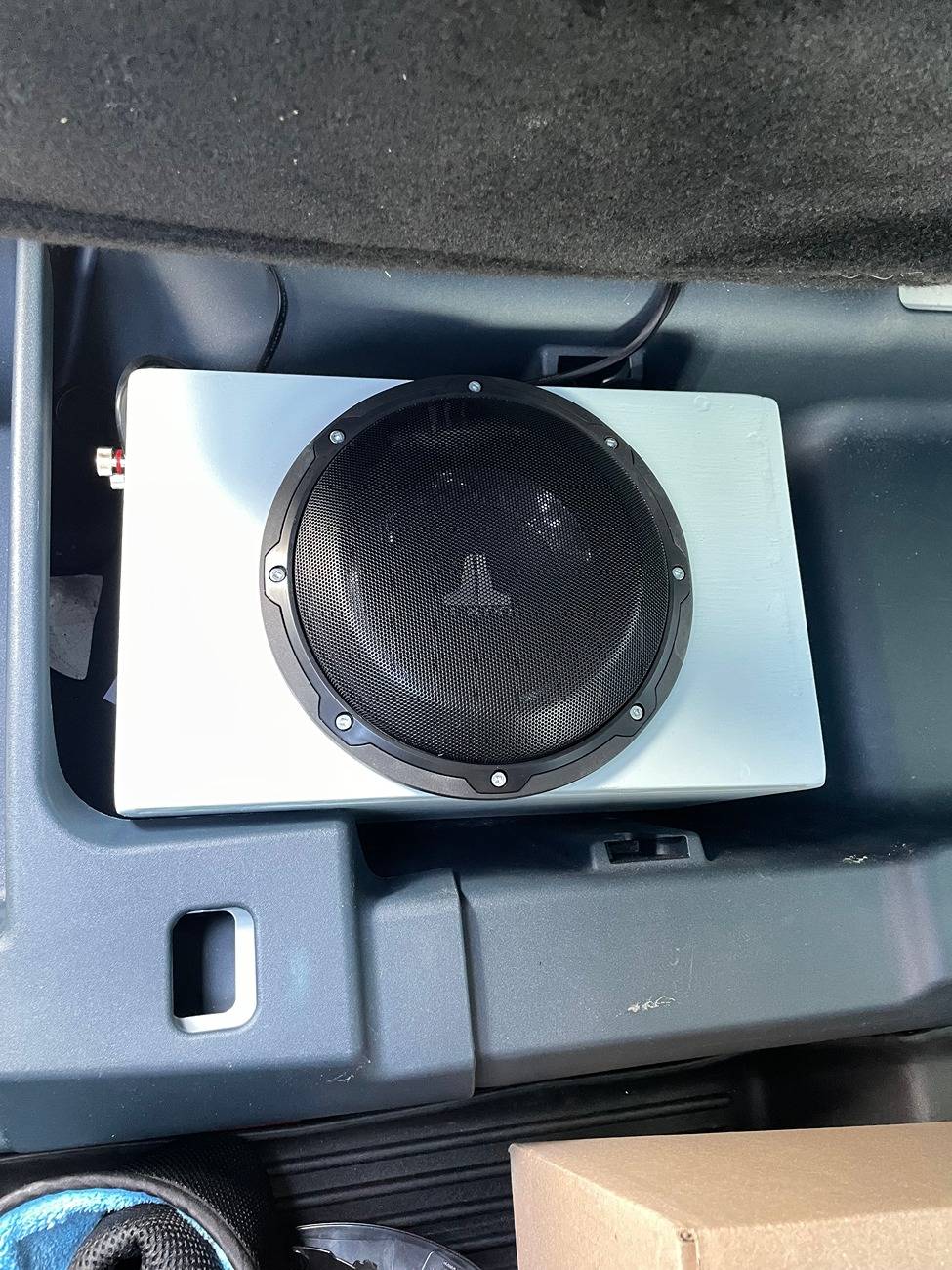

All in >$200.00. Excellent sound
Using the shallow mount 10-in kicker which I believe requires 0.50, anything sound better than the non-existent subwoofer that came in my XLT. 😎👍.

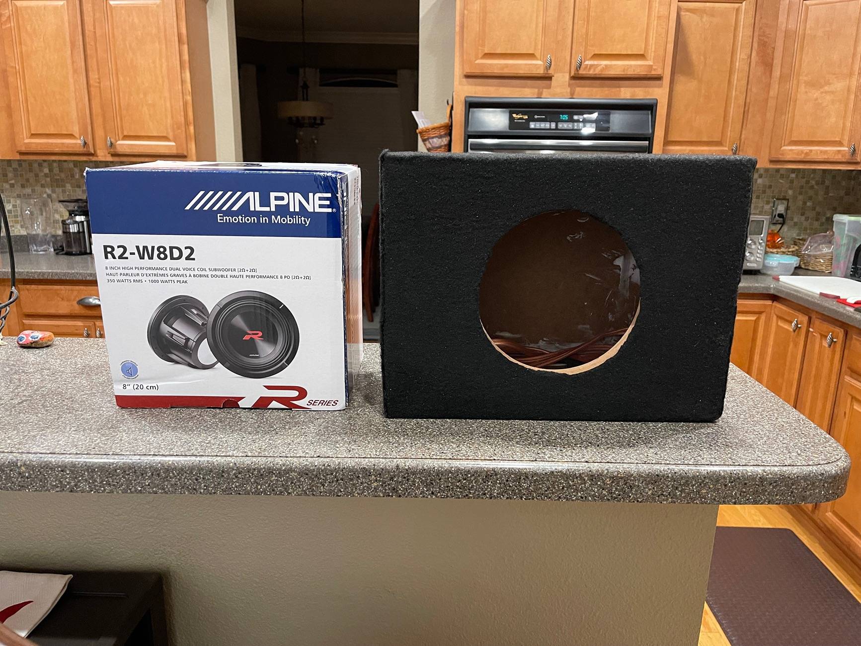

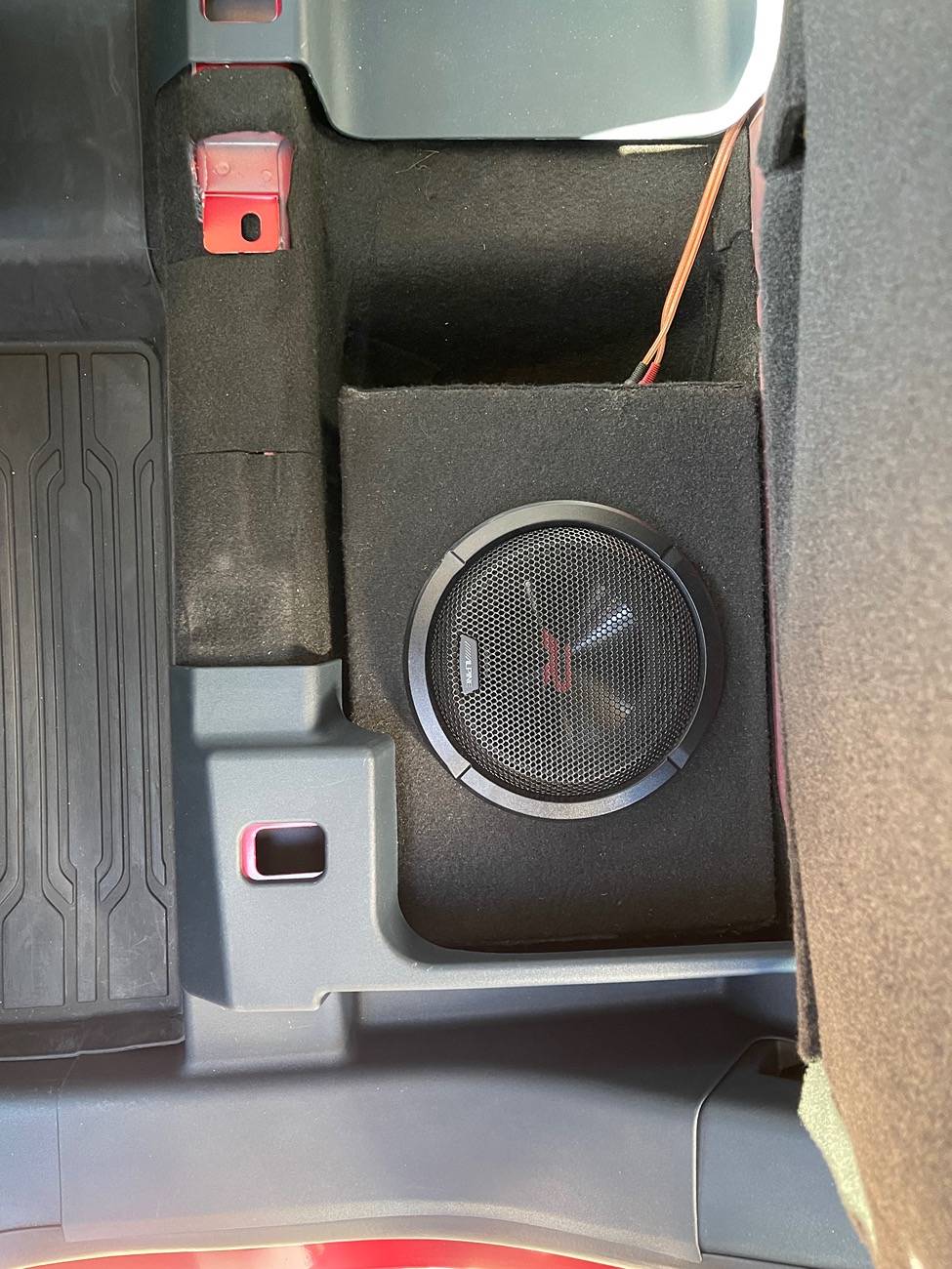

I agree, it should still fit the Hybrids. JL’s are very good quality and I have one in my Mustang. I will say most systems I have heard with JLs seem to favor a more narrow range where they hit hard. So I built my own box and stayed with a high performance deep throw 8” by Alpine. I’ve been extremely happy with it along with an amp that I bought from Amazon. I have a Lariat Hybrid with the B&O system. I used the speaker lead feeding the factory sub to feed the amp inputs. It works great and the amp handles the high level input just fine.

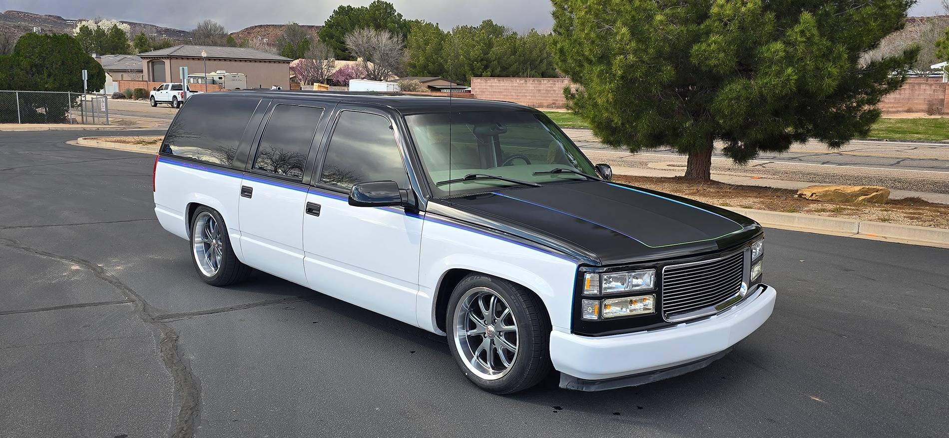

I have a single 12" DVC in my Suburban that POUNDS.
